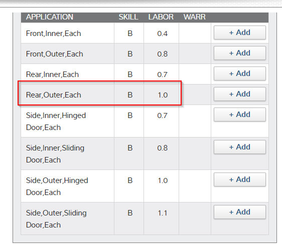

Rear right door handle replacement labor cost
2012 FORD E-SERIES VAN
98,200 MILES • 5.4L • V8 • 4WD • AUTOMATIC
AB AUTOMOTIVEREPAIR TRANSMISSIONS
  • 107 POSTS
we need labor time to replace the rear right door handle (has the license plate within). Thanks guys. the part number we're replacing is :9C2Z-15434A20-AB.

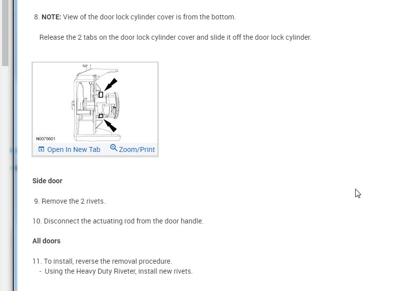

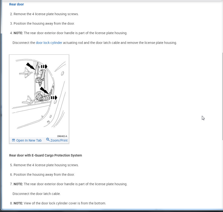

I am attaching the process and labor time. Looks like an hour for the rear outer handle. Check out the diagrams (Below). Please let us know what happens. Let us know if you need more info. Thanks
