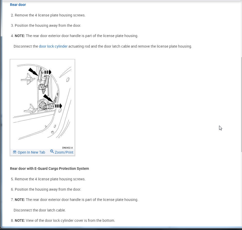

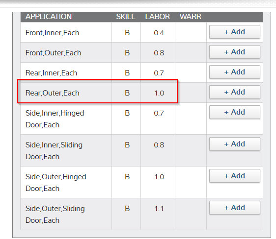

we need labor time to replace the rear right door handle (has the license plate within). Thanks guys. the part number we're replacing is :9C2Z-15434A20-AB.
Thanks
Sep 25, 2020 at 2:43 AM

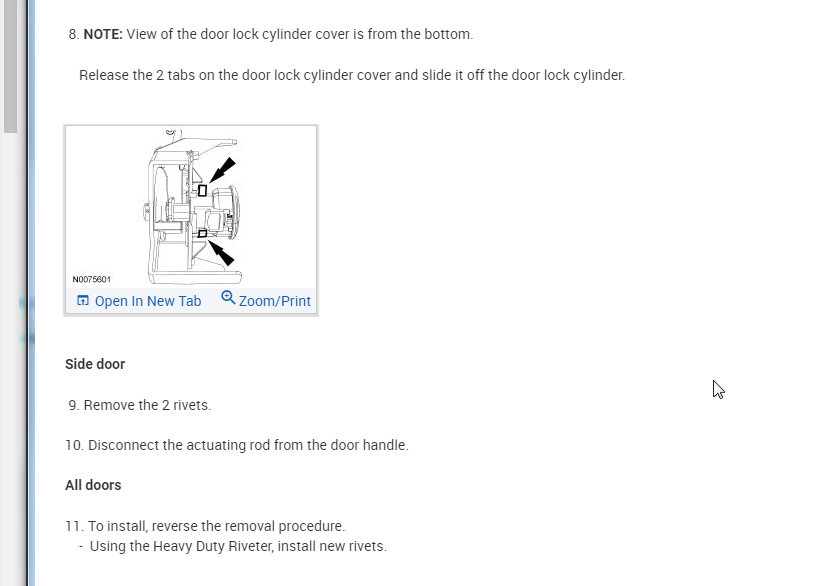

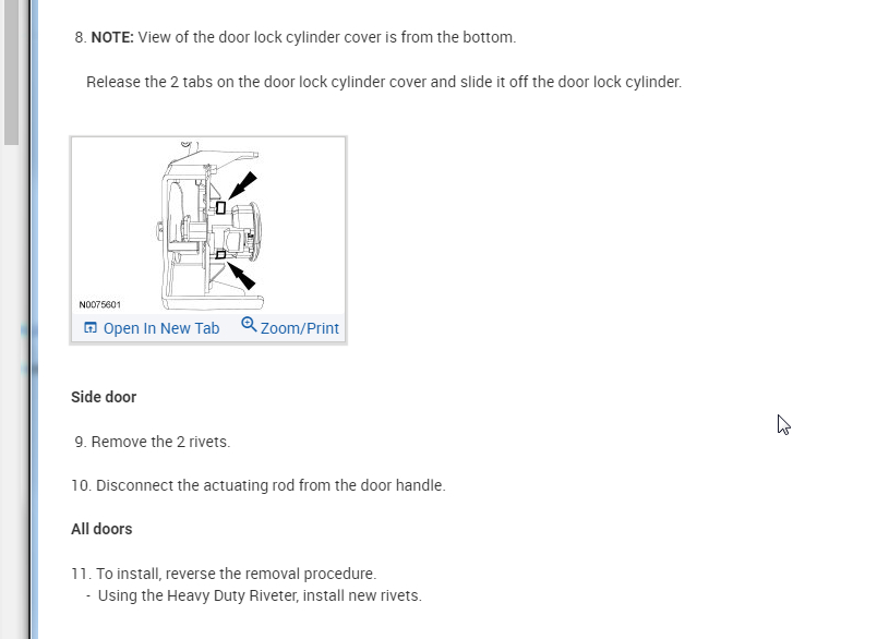

I am attaching the process and labor time. Looks like an hour for the rear outer handle. Check out the diagrams (Below). Please let us know what happens. Let us know if you need more info. Thanks
