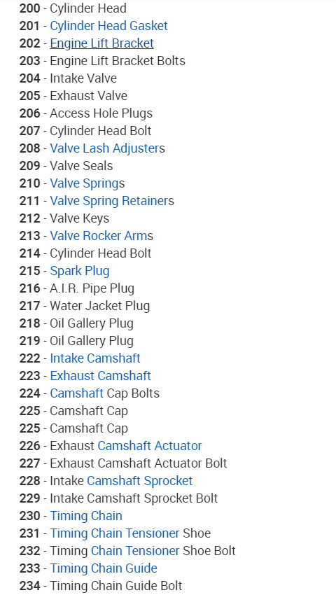

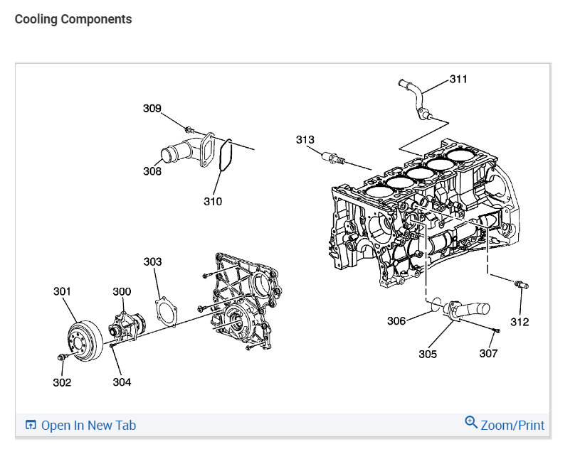

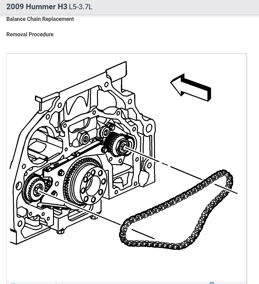

I would say no to all the above, let's start over and before we spend any money, we will be sure of what's going on. The first thing I need is a clear video of the engine noise and where you feel the noise is coming from.

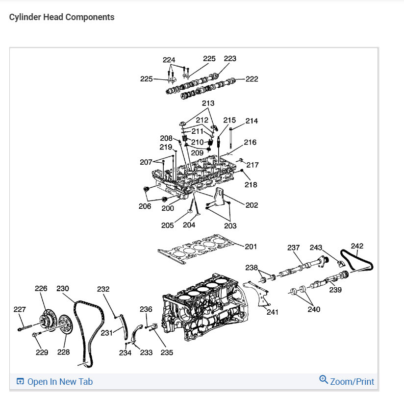

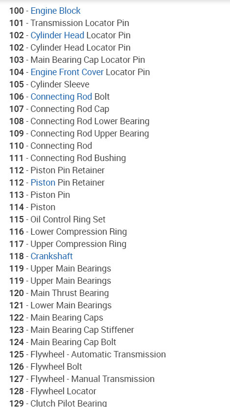

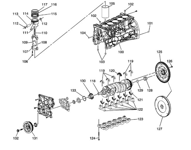

Also, has the oil changes and filter been kept up regularly. Also, does it make the noise when the car is stopped? So, here is an exploded view of the engine, please look them over and when you hear the noise try to imagine where the noise is coming from. This engine has a balance shaft set up that can go bad which is at the rear of the engine. Try to imagine if the noise is toward the top of the engine or down low. It could be a broken piston ring or a seized wrist pin in a piston.

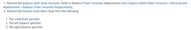

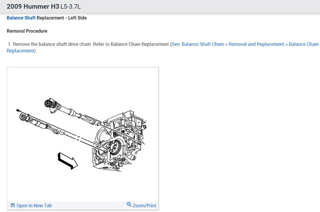

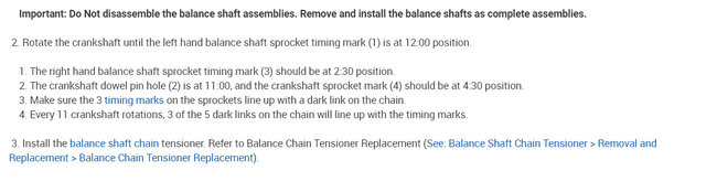

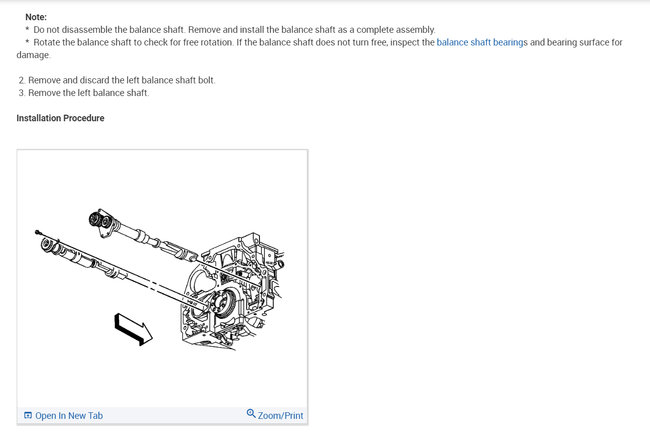

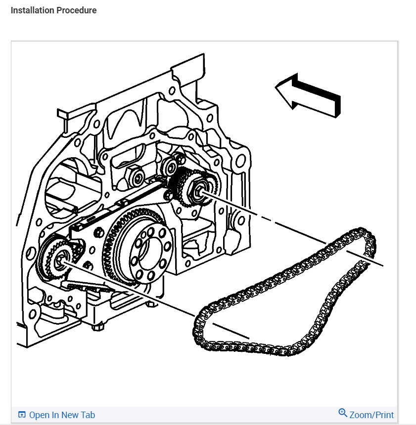

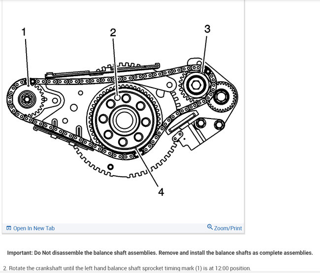

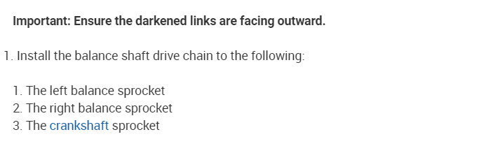

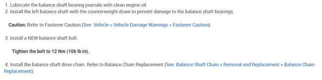

Yep, that to me says balance shaft chain or shaft bearing issue. These engines had problems with the balance shafts. They are difficult to get to because they are at the rear of the engine. This is what the manual says on how to replace or inspect the operation of the shafts. Does this sound like where it is coming from? As you can see the engine needs to be removed to do the job. Check out the diagrams (below). Please let us know what you find. We are interested to see what it is; it could be the bearings in the block.
