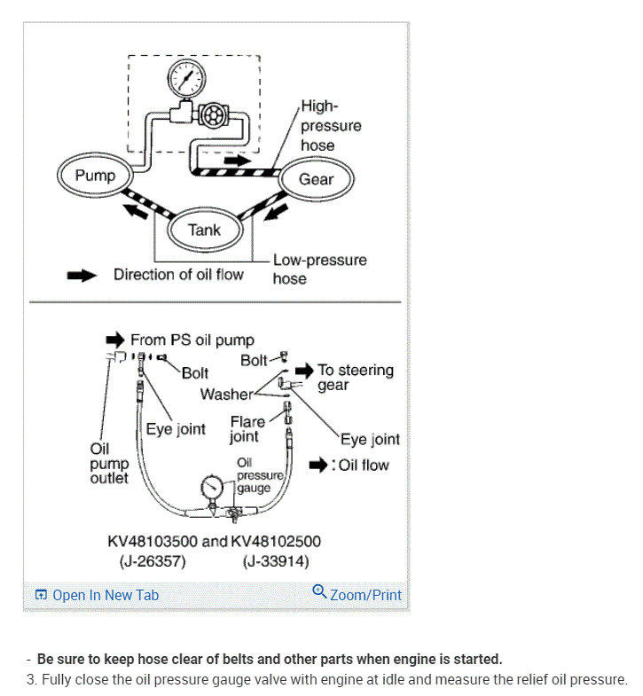

So, I've had to change my power steering pump a few times all new each time my rack and pinion (used) my power steering high pressure line and switch twice all due to listening and then unknowingly allowing actual idiots to work on my car. So, i was driving a total of five miles maybe round trip the other night and i began hearing a noise but it didn't alarm me at first but by the time I'm 3/4 of the trip it's gotten really loud and my steering is becoming stiff. So, i bought a new power steering pump and put it on bled it and after about 7 to 10 minutes of rocking the wheel back and forth the noise has yet to stop and the steering was still bad this is when i noticed that all the p.s. fluid i had been leaking over the last year had put a heavy thick black coating all over the alternator so i read up on the issue and it says it's a possible cause. I'm broke and can't keep buying parts that don't fix my issue. I'm including a video of how it sounds when i start it up so you can hear it and give me feedback hopefully.

I certainly hear the sound. Is that only happening when you turn the steering wheel? It does sound like a power steering pump.
Let me know if there is any evidence of air still in the system such as foaming in the fluid.
Also, let me know if there is any assistance. One last thought. With the front wheels off the ground, does the steering turn freely?

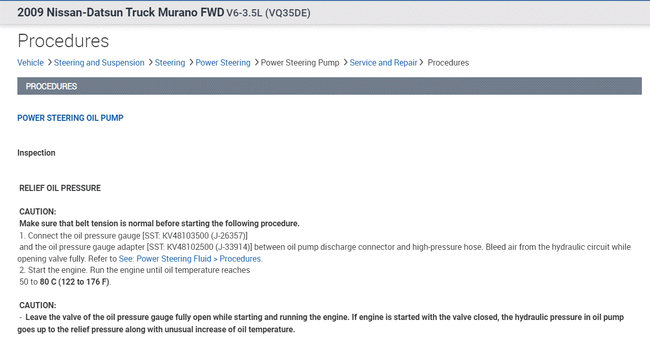

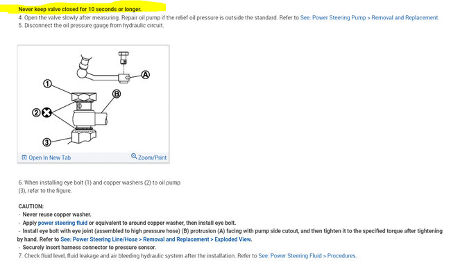

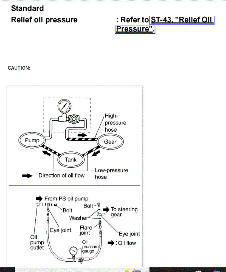

I attached diagnostics for checking the pressure. Take a look through it and let me know if this is something you feel comfortable doing. If there is a restriction, likely there is a blockage. If the steering with the wheels off the ground is tighter than normal, it could be related to the rack and pinion.

You know the highlighted words in your diagrams i'm not able to open them up. do you know why by chance?

That isn't a thread to open. It is referring to the tool being used to test pressure.
