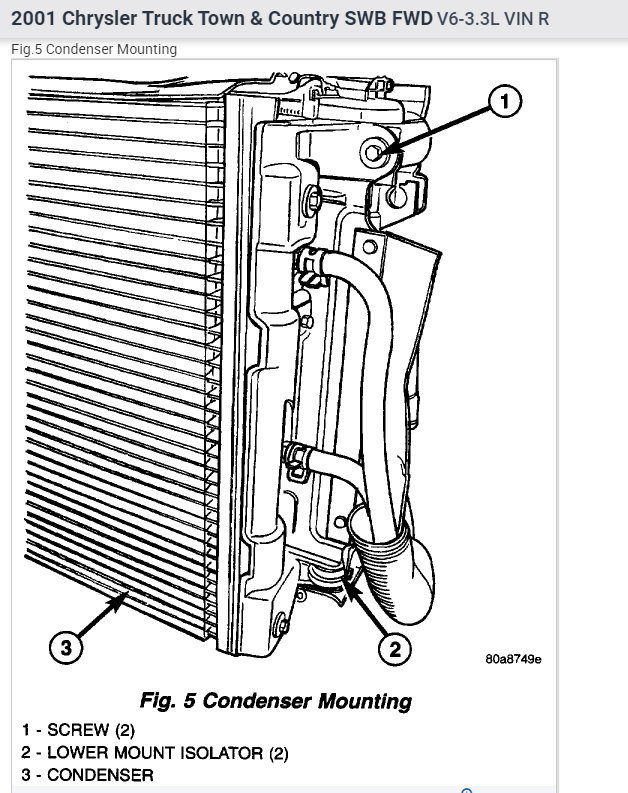

I went to put Freon in one day and it blew a hole in the condenser
2001 CHRYSLER TOWN AND COUNTRY

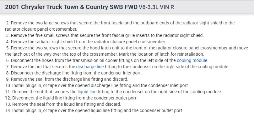

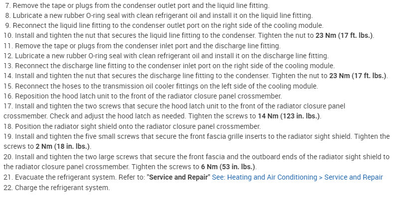

I was wanting to know if I could just replace the condenser and put new oil and Freon.
Jun 30, 2022 at 4:49 PM
SQM
  • CAR REPAIR CONTRIBUTOR
  • 6,383 POSTS

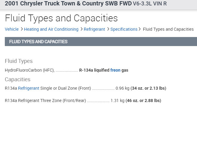

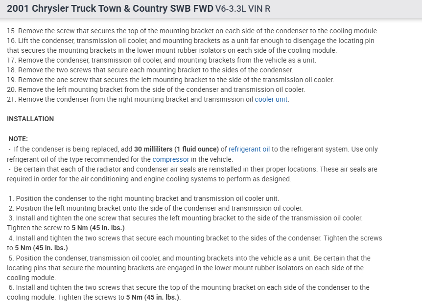

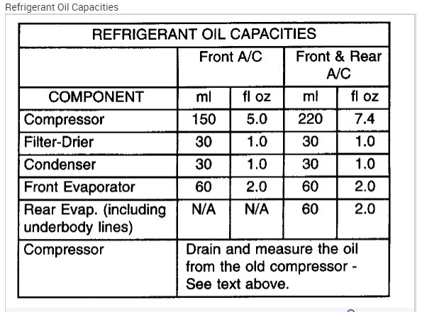

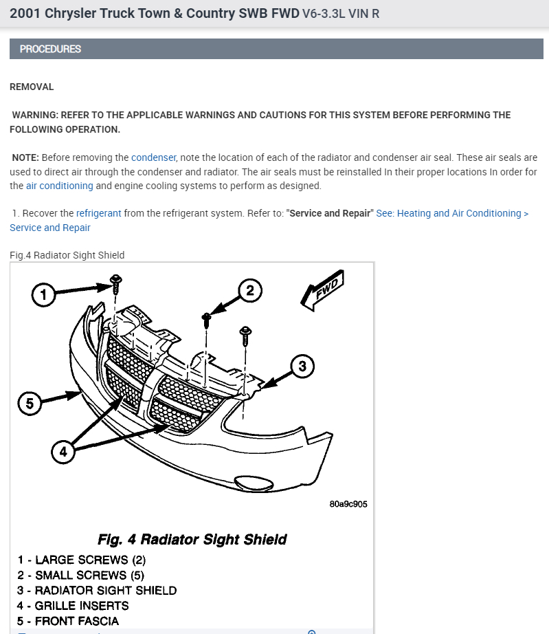

Yes, you can just replace the condenser.
You will need 34 ounces of 134a Freon for single or dual zone climate control. If it is a three zone, then you will need 46 ounces.
Also, will need 1 ounce of PAG oil.
https://youtu.be/4EqdrBVb0sY
I have attached the replacement procedure below.
