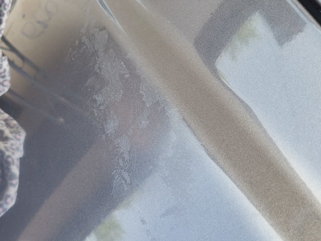

Without damaging the paint. I have tried rubbing alcohol and wd40 and nail polish remover. I have managed to get some of it off but not all of it..

Here's the best picture I can get, it's on my hood.
May 2, 2022 at 5:50 AM
The good news is it is on the hood. Worst case, we are going to have to wet sand the entire hood in order to get that off.
However, while this is a lot of work, it will make the hood like brand new and the hood has natural break points that will keep you from having to blend all the other panels. If you wet sand one portion of one panel, it will stand out more then this glue does.
