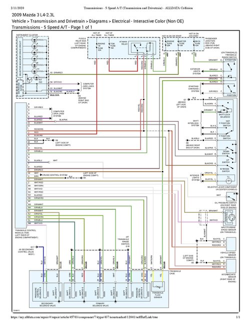

ROKR_MAZDA

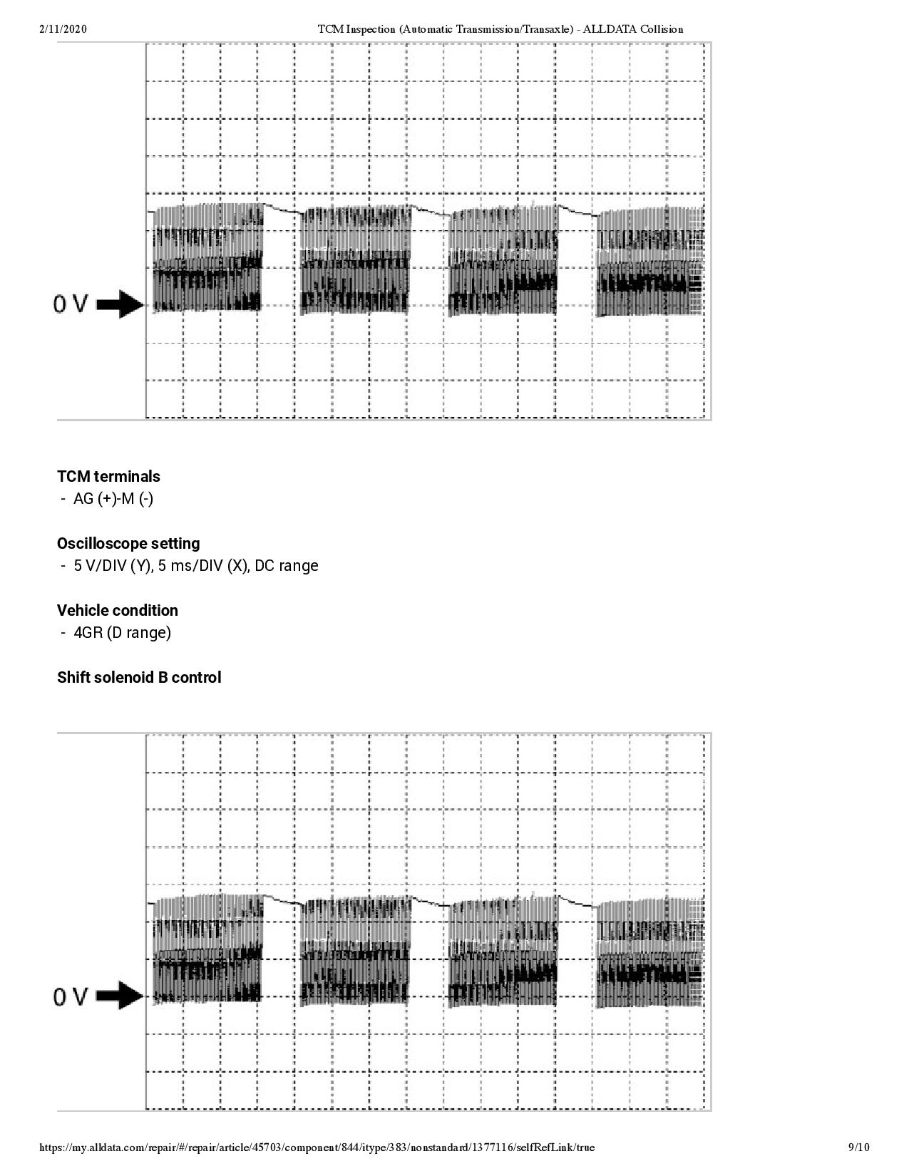

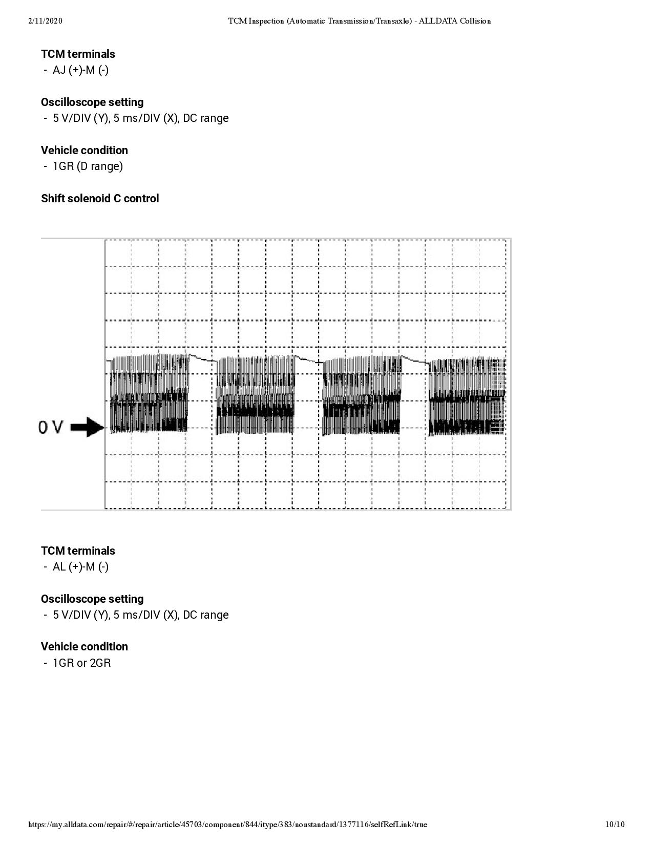

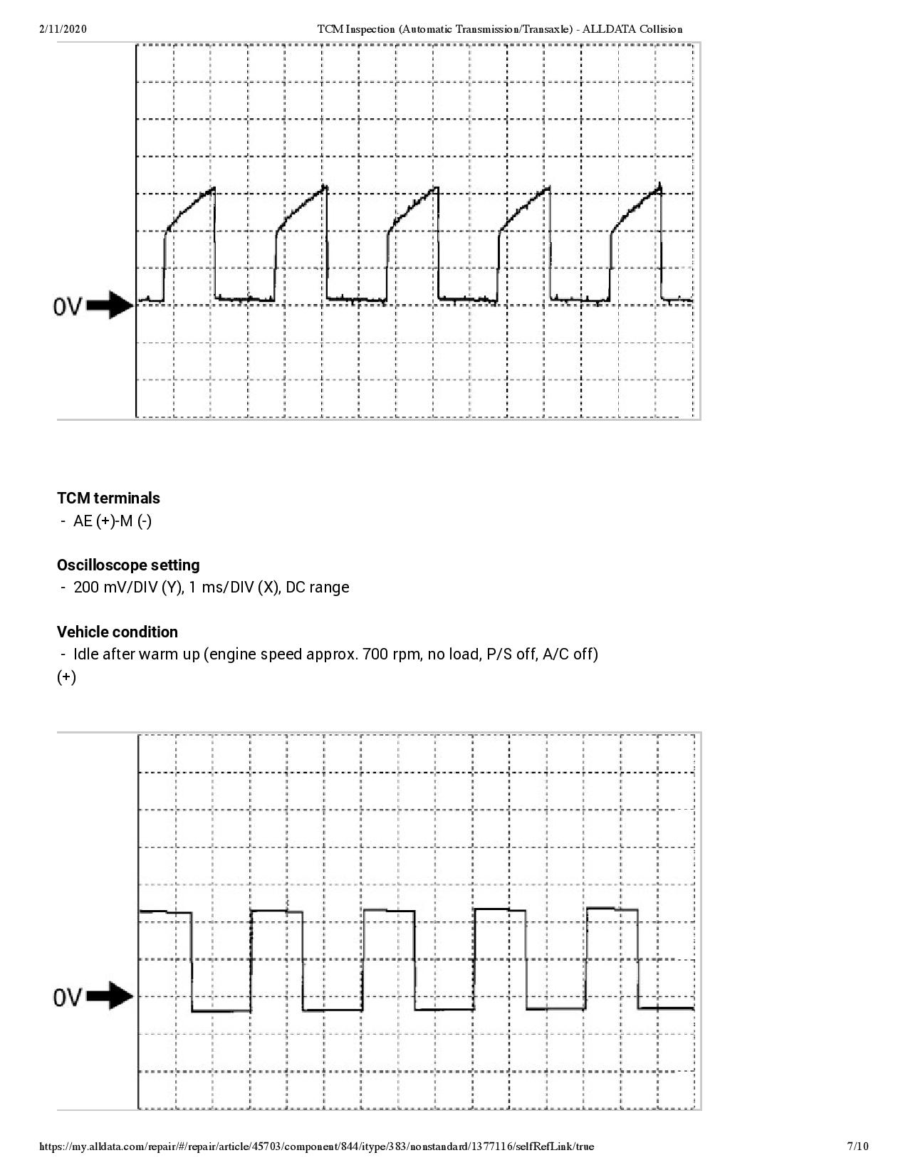

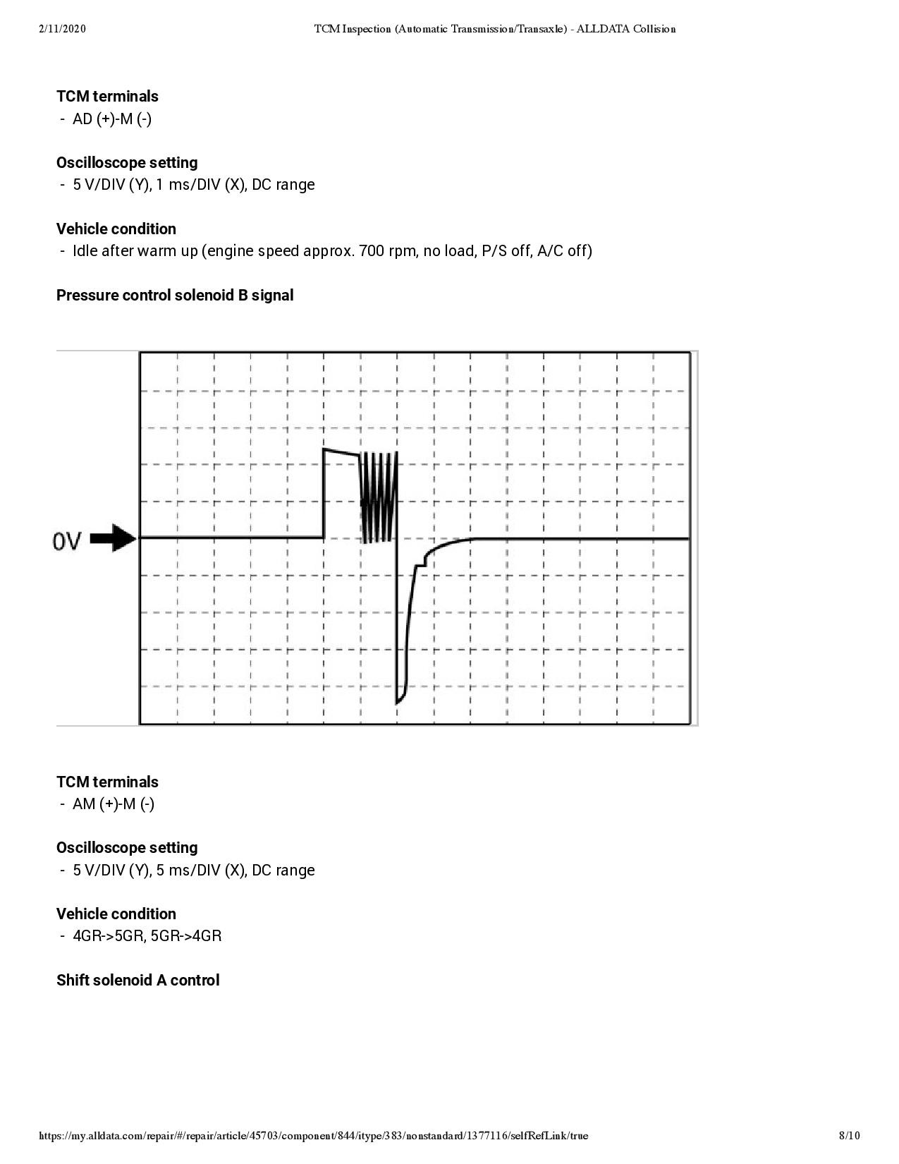

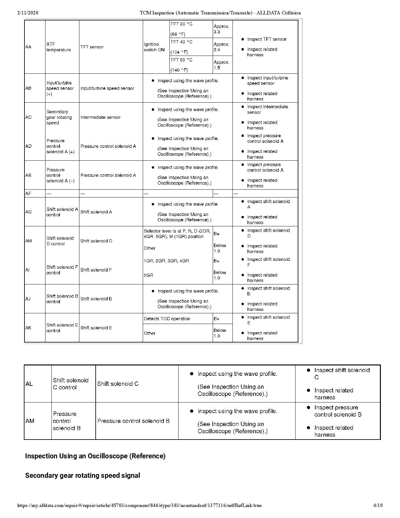

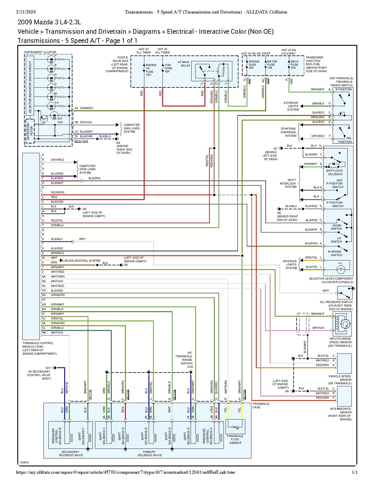

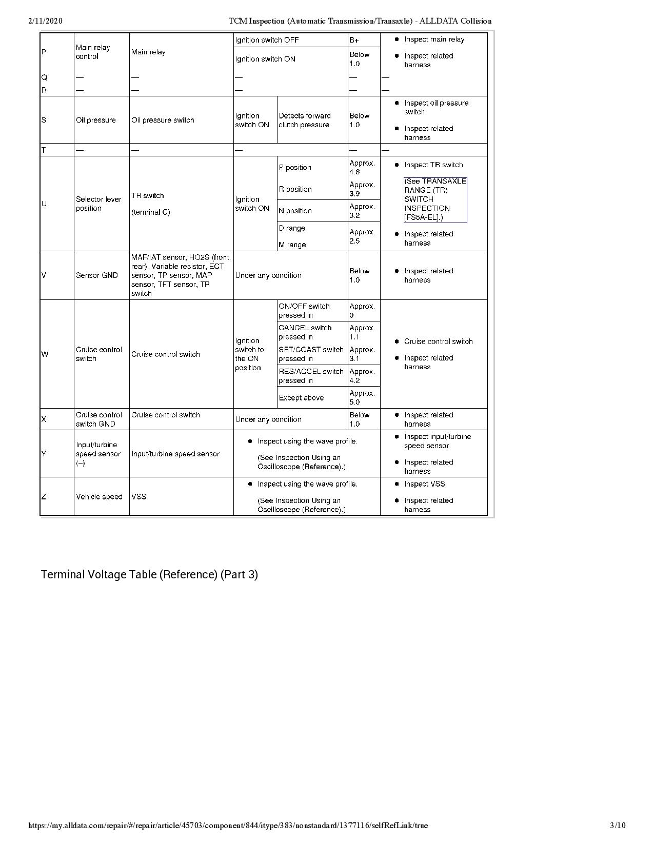

My problem started with the start of the check engine and the AT, it was checked with a scanner and gave the code u0101, when reviewing the TCM module they indicated that it received a short circuit.
I would like to know if someone has the diagrams for the identification of the short circuit.
thanks
Feb 11, 2020 at 6:41 AM
JOETECHPRO
  • 705 POSTS

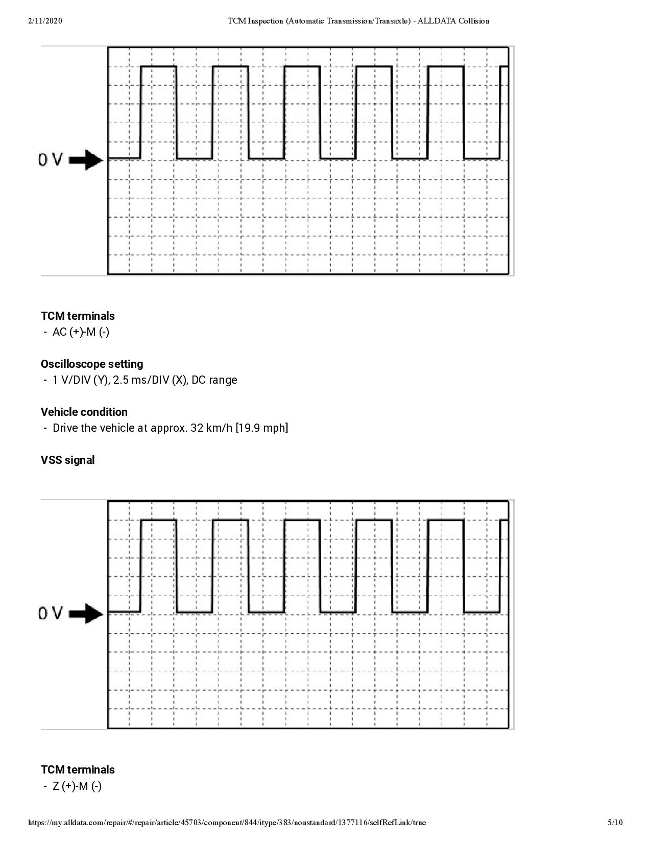

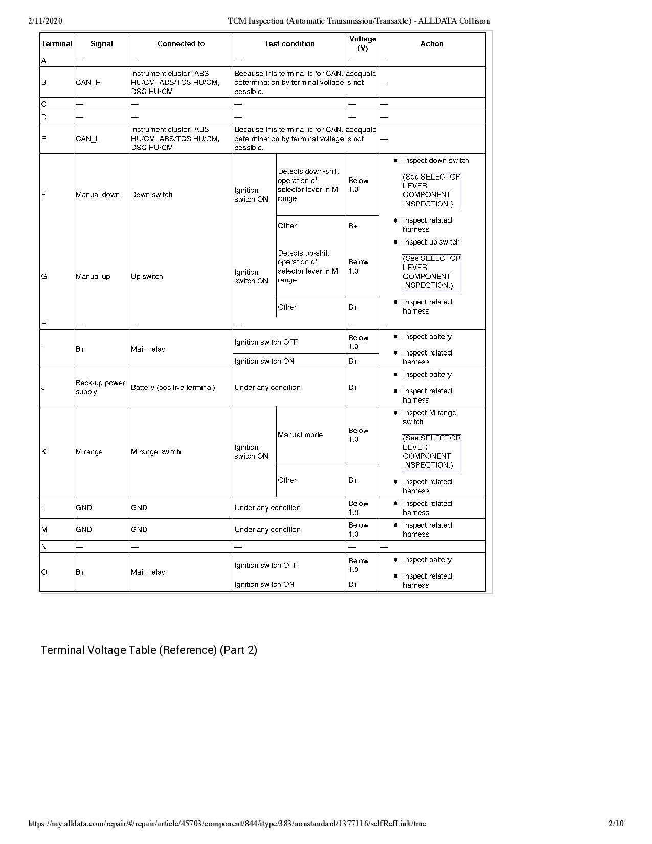

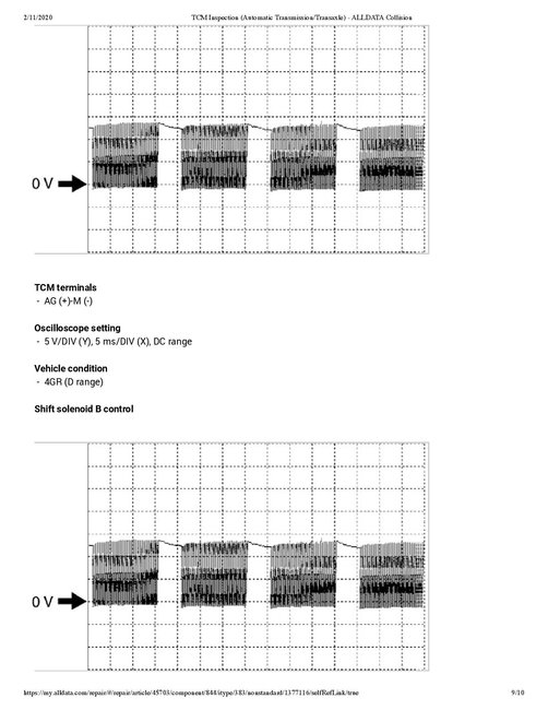

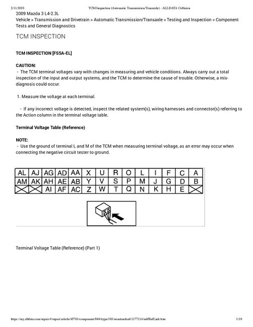

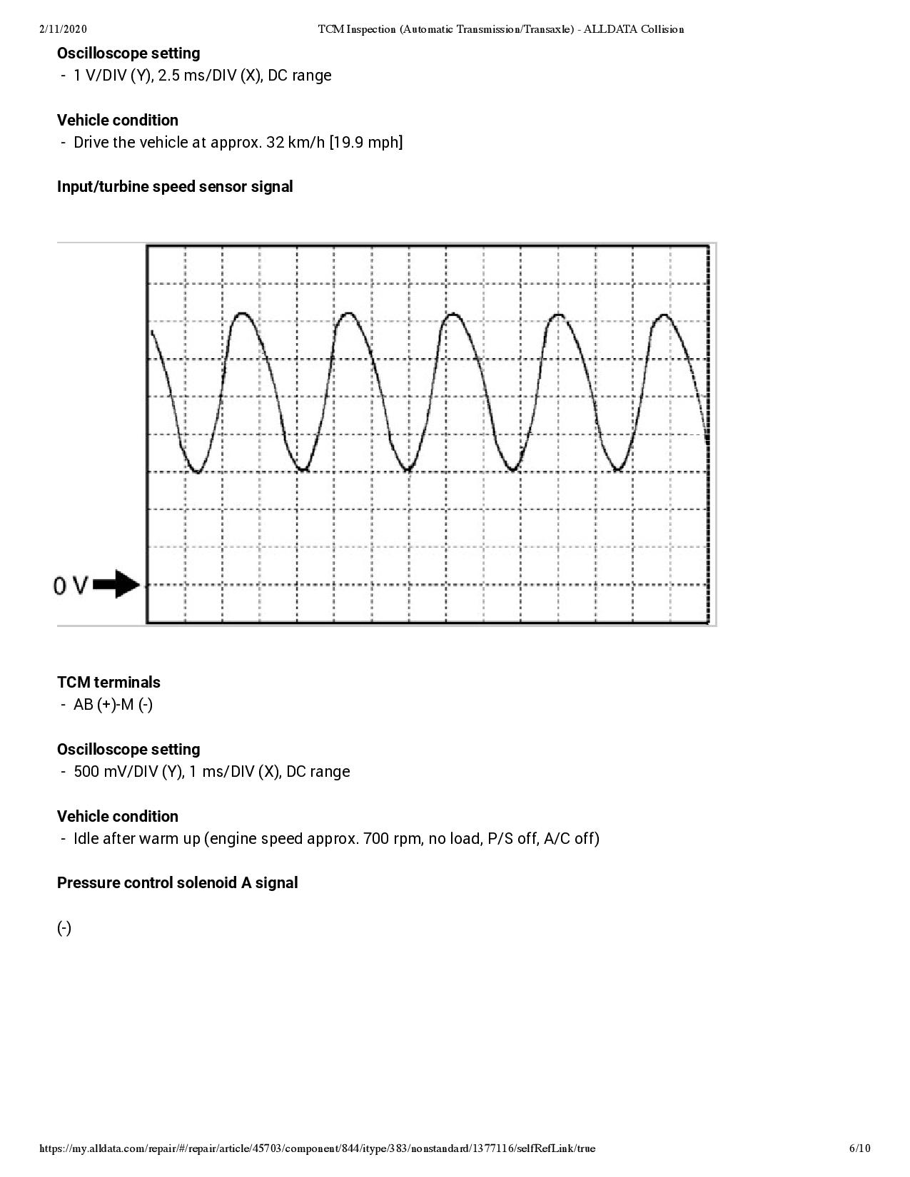

Hey ROKR_MAZDA,
I have attached the wiring diagram for the A/T controls.

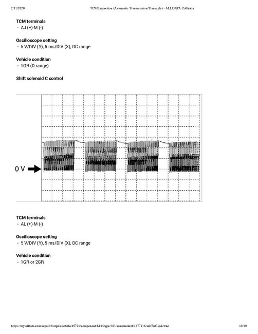

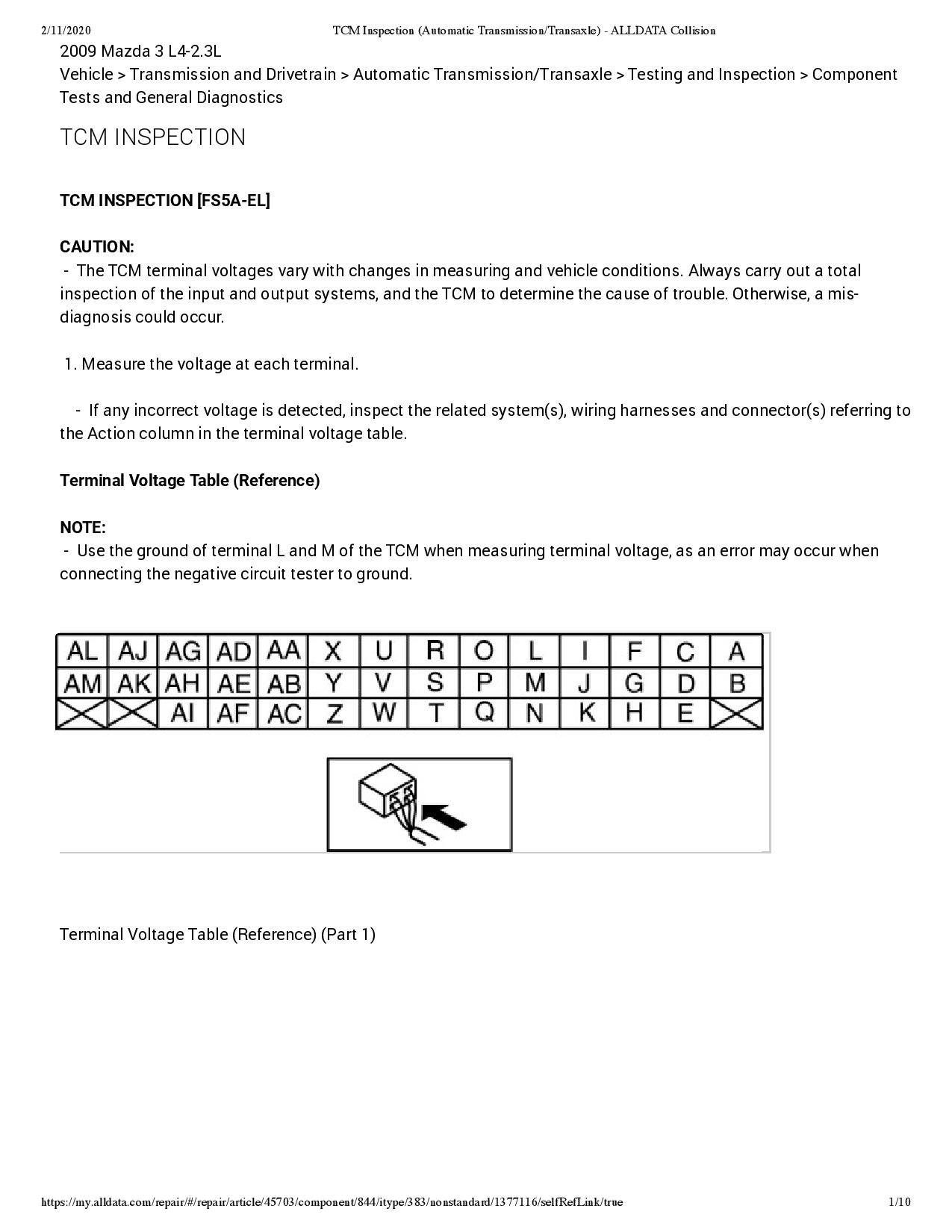

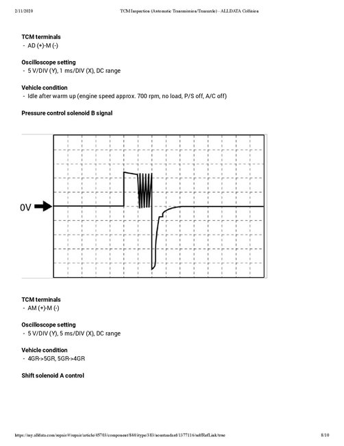

I have also attached the testing information for the terminals at the TCM plug connector.
Let us know if you need any further information or have any questions about the testing results you get.
Regards, Joe

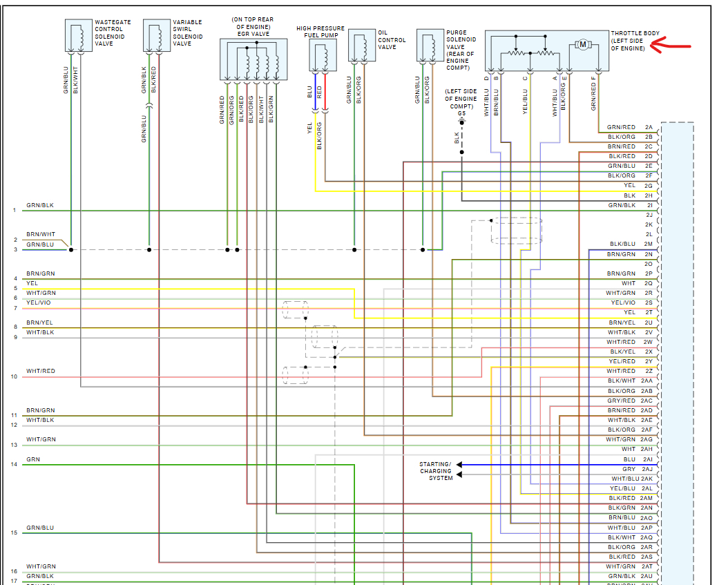

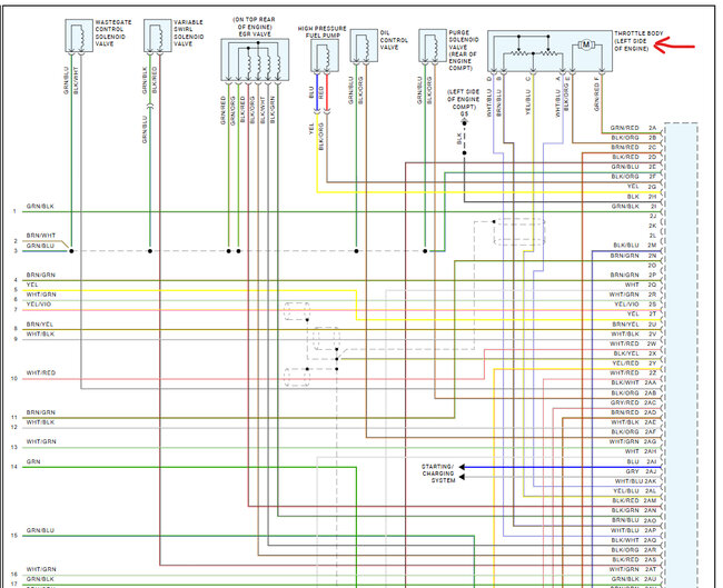

Can you also please also indicate the wire to test that is related to the throttle body from the TCM , i have similar issue because even my PRND indicator is not lighting up. It just shows AT and the throttle body misbehaves. Thank you
Oct 22, 2024 at 9:34 AM
  • 55,433 POSTS
The throttle body connected to the PCM only. Here is the wiring diagrams and a guide to help you test the wiring.
