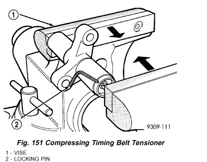

What is the correct way to lift motor to replace water pump?

Hi and thanks for using 2CarPros. Com. There is no need to remove the engine to access the pump. However, you should replace the timing belt at the same time since it will be removed to access the pump. First, I have attached directions for removal of the timing belt. Pictures 1 and 2 correlate with removal of the belt.

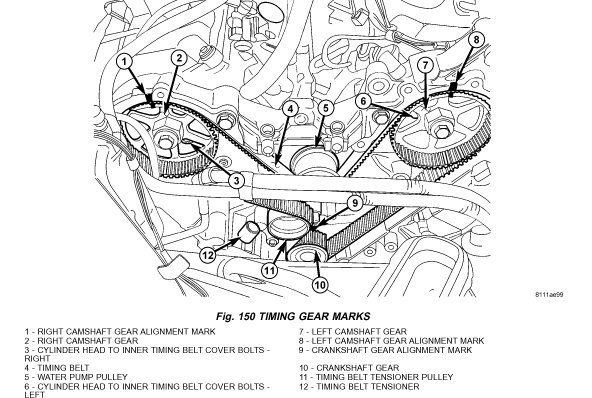

Remove the outer timing covers. Rotate the crankshaft until the pointer on the crankshaft sprocket aligns the TDC mark on the oil pump. Check to determine if the camshaft sprocket timing marks are aligned with the marks on the inner timing cover. It may take an additional full revolution of the crankshaft before the camshaft sprocket marks are aligned (Fig. 150).

CAUTION: When aligning timing marks, always rotate engine by turning the crankshaft. Failure to do so will result in valve and/or piston damage.
Rotate engine clockwise until crankshaft mark aligns with the TDC mark on oil pump housing and the camshaft sprocket timing marks are aligned with I the marks on the rear cover (Fig. 150)
Remove the timing belt tensioner (Fig. 150) and remove timing belt.

When tensioner is removed from the engine it is necessary to compress the plunger into the tensioner body.
CAUTION: Index the tensioner in the vise the same way it is installed on the engine. This ensures proper pin orientation when tensioner is installed on the engine.
Place the tensioner into a vise and SLOWLY compress the plunger (Fig. 151). Total bleed down of tensioner should take about 5 minutes.
When plunger is compressed into the tensioner body install a pin through the body and plunger to retain plunger in place until tensioner is installed.
The following procedure should be followed when reinstalling the belt. Picture 3 correlates with these directions.

CAUTION: If camshafts have moved from the timing marks, always rotate camshaft towards the direction nearest to the timing marks (DO NOT TURN CAMSHAFTS A FULL REVOLUTION OR DAMAGE to valves and/or pistons could result).
Align the crankshaft sprocket with the TDC mark on oil pump cover (Fig. 150).
Align the camshaft sprockets timing reference mark with the mark on the rear cover (Fig. 150).
Install the timing belt starting at the crankshaft sprocket going in a counterclockwise direction. Install the belt around the last sprocket. Maintain tension on the belt as it is positioned around the tensioner pulley.
NOTE: If the camshaft gears have been removed it is only necessary to have the camshaft gear retaining bolts installed to a snug torque at this time.
Holding the tensioner pulley against the belt, install the tensioner into the housing and tighten to 28 Nm (250 inch lbs.). Each camshaft sprocket mark should remain aligned the cover marks.
When tensioner is in place pull retaining pin to allow the tensioner to extend to the pulley bracket.
Rotate crankshaft sprocket 2 revolutions and check the timing marks on the camshafts and crankshaft. The marks should line up within their respective locations (Fig. 150). If marks do not line up, repeat procedure.

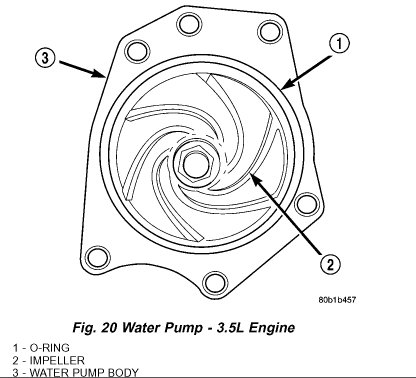

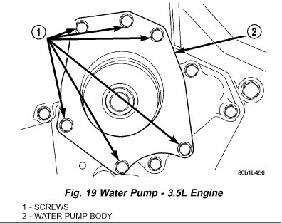

HERE are the directions for replacing the water pump. The remaining pictures are related to these directions.

REMOVAL
The water pump on all models can be replaced without discharging the air conditioning system.
WARNING: DO NOT REMOVE PRESSURE CAP WITH THE SYSTEM HOT AND UNDER PRESSURE BECAUSE SERIOUS BURNS FROM COOLANT CAN OCCUR.
NOTE: It is normal for the water pump to weep a small amount of coolant from the weep hole (black stain on water pump body). Do not replace the water pump if this condition exists. Replace the water pump if a heavy deposit or a steady flow of engine coolant is evident on water pump body from the weep hole (shaft seal failure). Be sure to perform a thorough analysis before replacing water pump.
Drain cooling system.
NOTE: The water pump is driven by the timing belt.
Remove engine timing belt.
Remove water pump mounting bolts (Fig. 19). Note position of longer bolt for proper re-installation.
Remove water pump body from engine (Fig. 19).

INSTALLATION
Clean all O-ring surfaces on pump and cover.
Apply Mopar Dielectric Grease or the equivalent silicone grease to the O-ring to facilitate assembly. Install new O-ring on water pump (Fig. 20).
Position water pump to engine.
Install mounting bolts and tighten to 12 Nm (105 inch lbs.).
