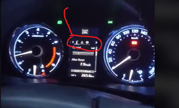

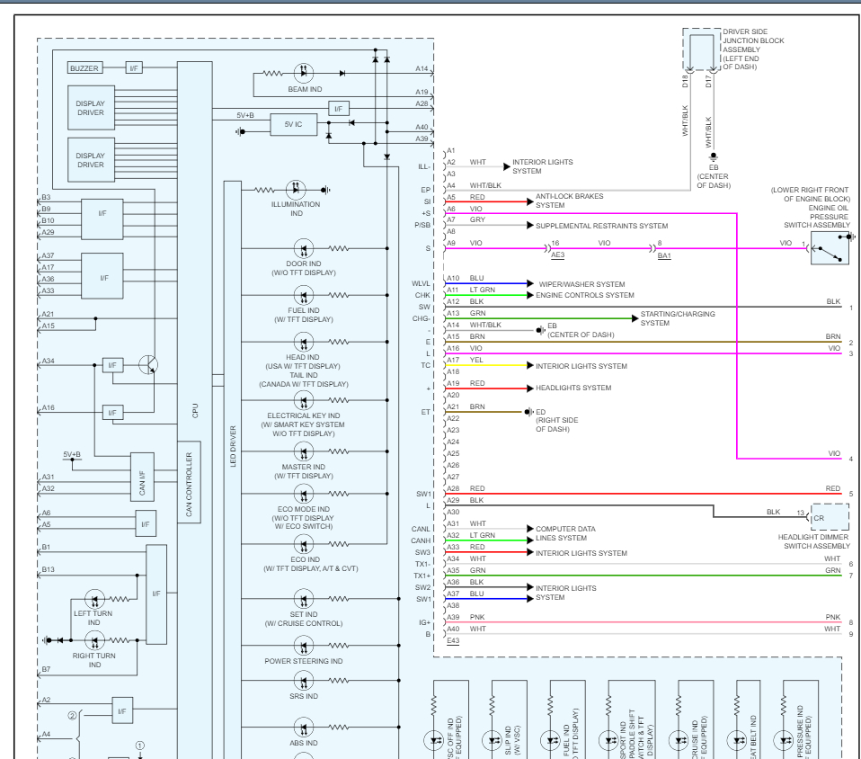

Anyone who knows the pin out of this instrument cluster for the car listed above?

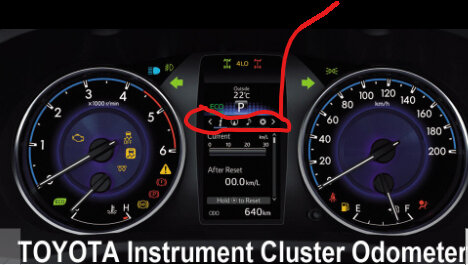

I changed my cluster to this. But my steering wheel don't have controls on the LCD display.
Reset trips/average range.
Change page.
Planning to make an external control for the LCD.
Hope someone knows how.
Thanks in advance.

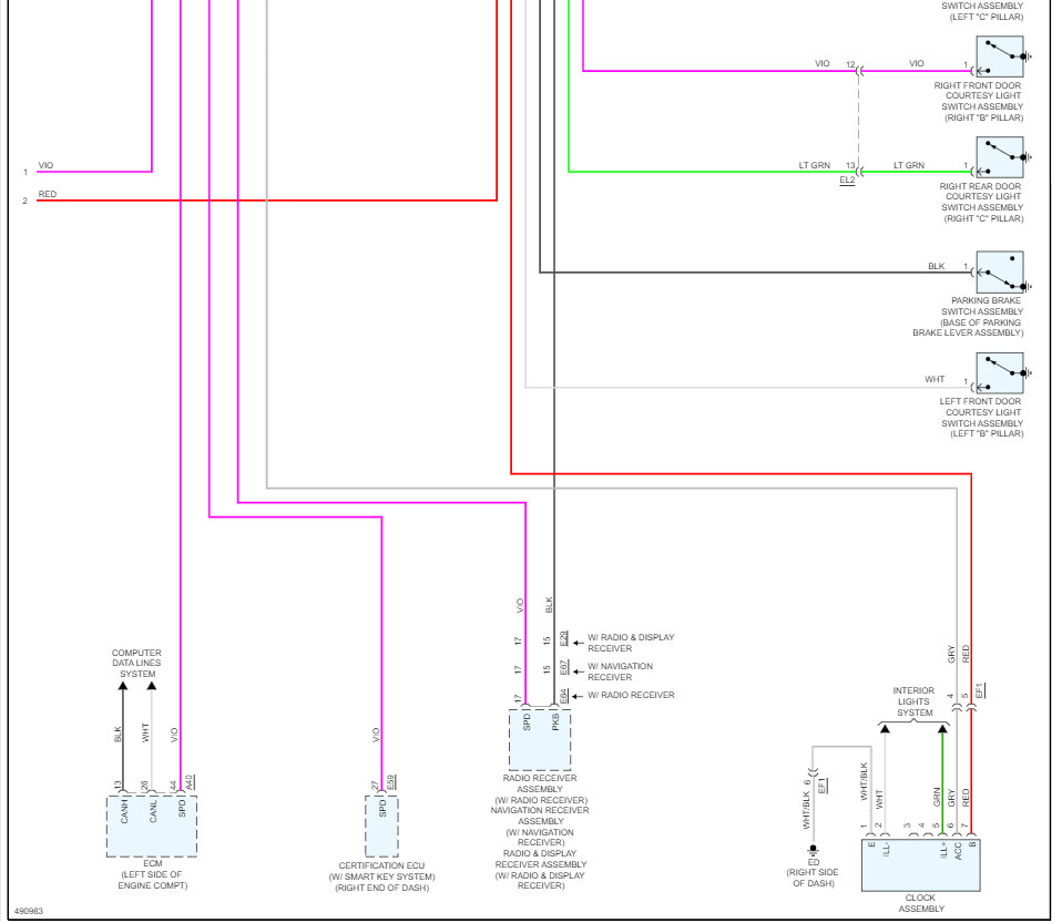

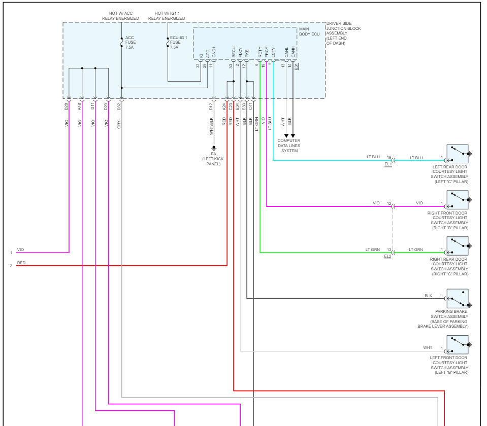

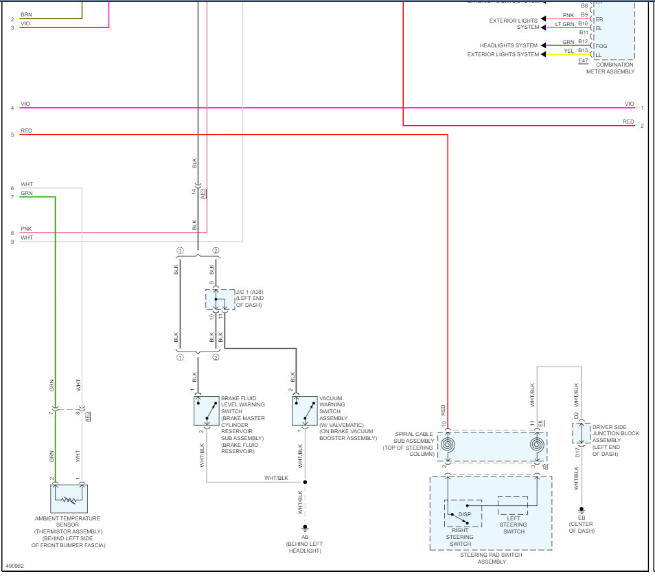

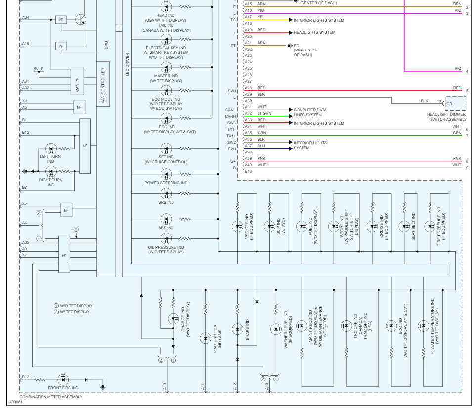

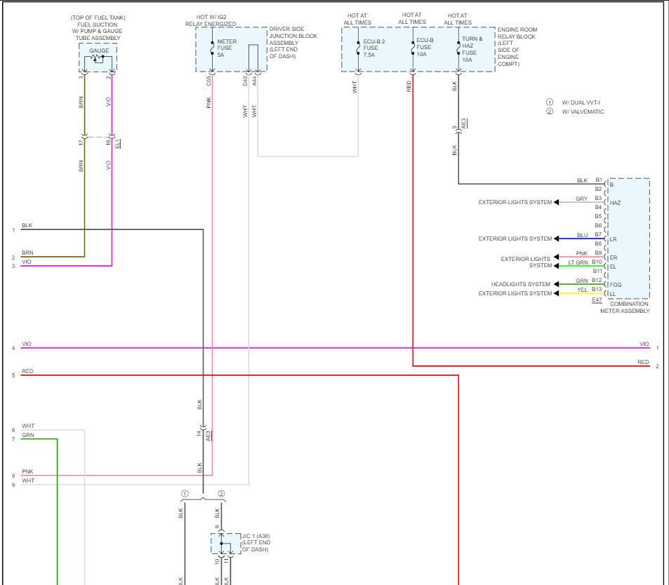

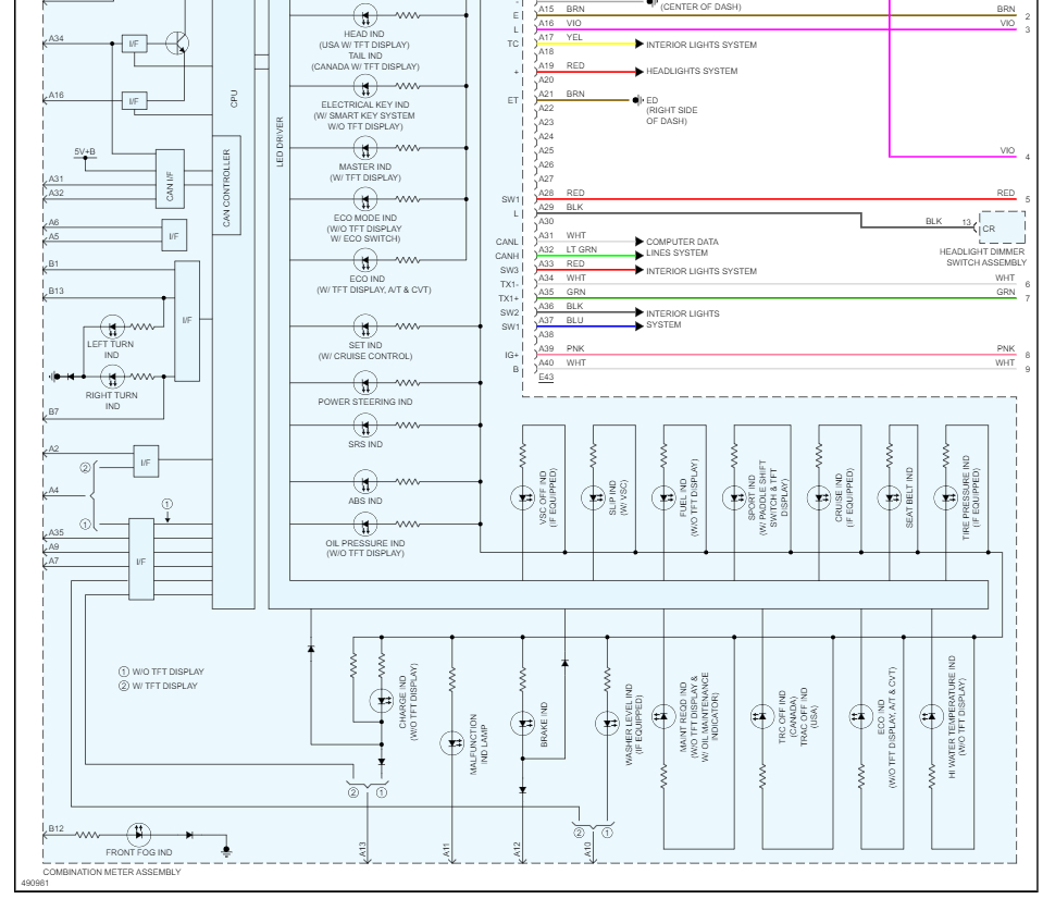

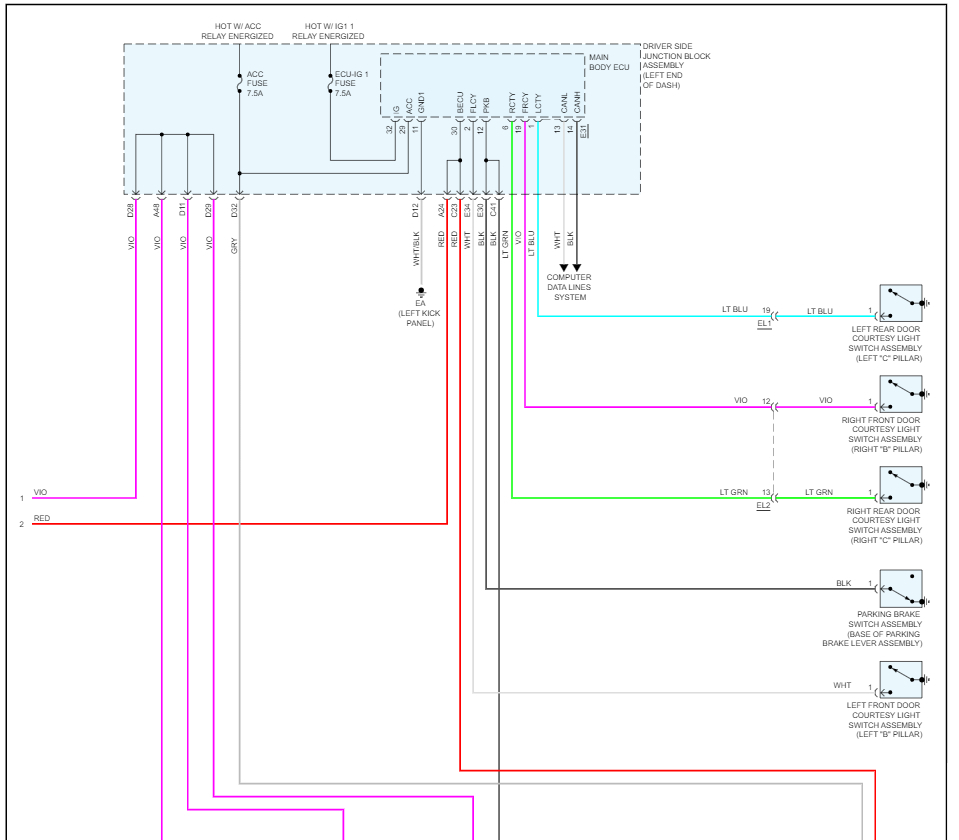

Hello, we only have instrument cluster wiring diagrams which you can see how the wiring goes and the connector associated. I have also included a guide to help you test the connections.
Check out the images (below). Please let us know if you need anything else to get the problem fixed.

anyone who tired an external controls of the instrument cluster instead controlling it from SW?

JUAN SINAG
i changed my speedometer cluster with lcd multi display from higher variant. and my steering wheel don't have the buttons to control it. can i make a wiring and put an external control for the LCD multi display?

JUAN SINAG
can i rewire my speedometer gauge to control the pages on the small LCD display?
