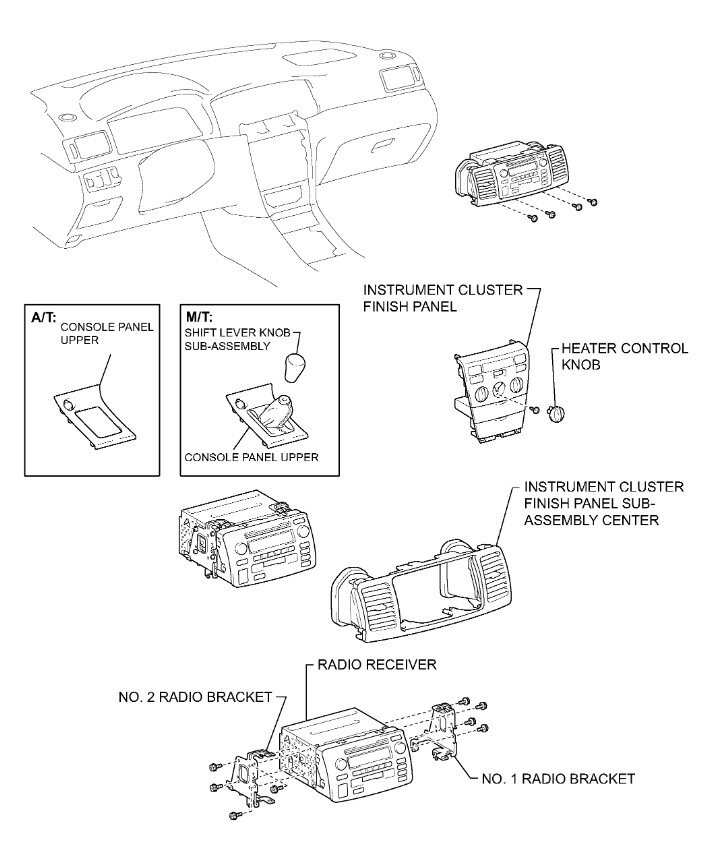

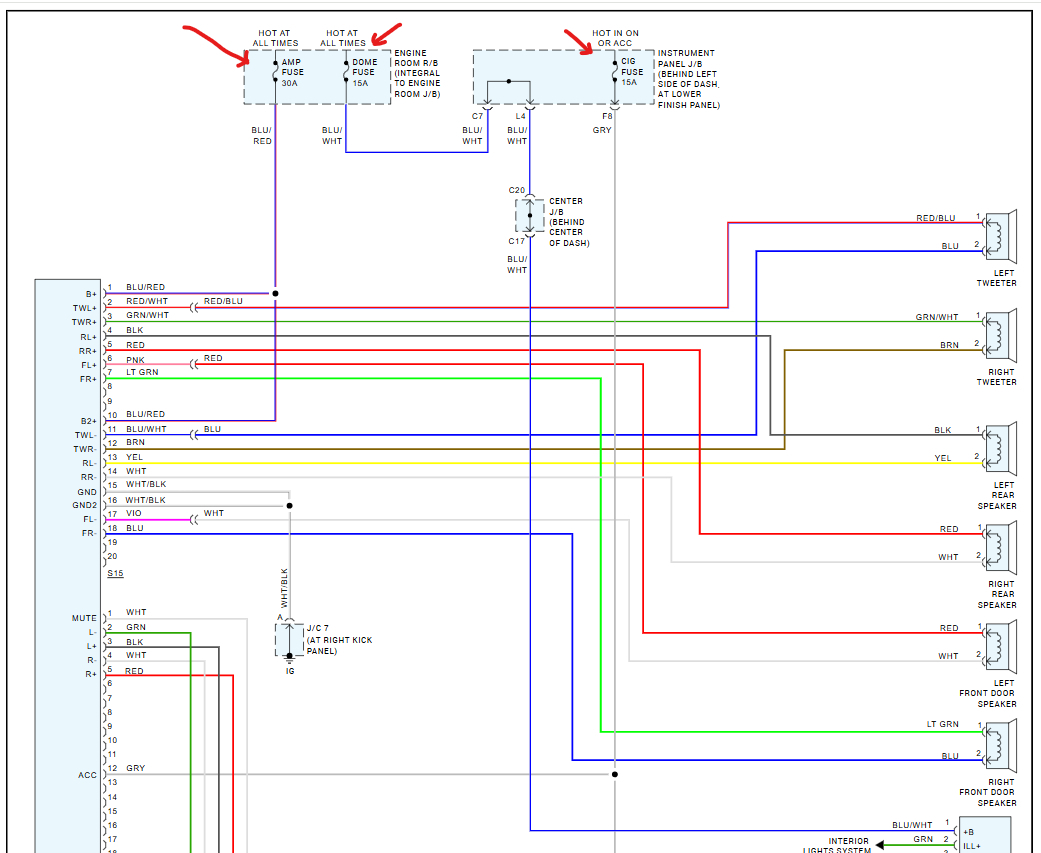

I bought this used car with the music system along with touch screen not working.
Checked the fuses and it seems to be good. Please guide me to remove the touch screen. Also share the wiring diagram for the same.

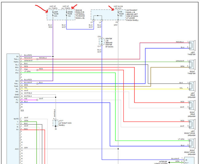

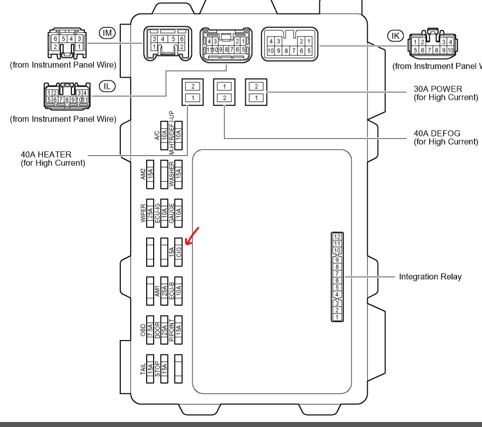

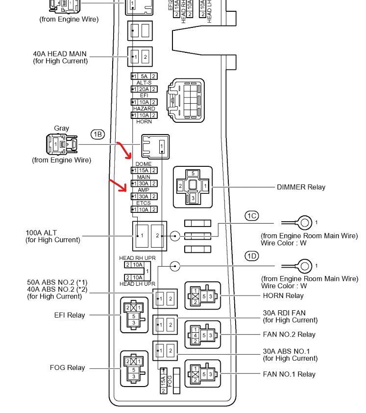

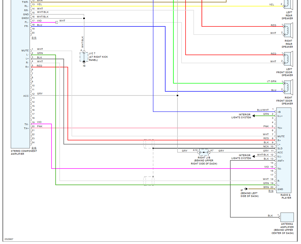

They do not show a touchscreen for this car, is the radio aftermarket? Can you upload an image so I can see? There are 3 fuses you need to check which this guide can help with.
Please check fuses # AMP, DOME and CIG, also here are the radio wiring diagrams so you can see which fuses run the system and how the unit works. Check out the images (below). Please upload pictures or videos in your response of any problems so we can see what to help you with.

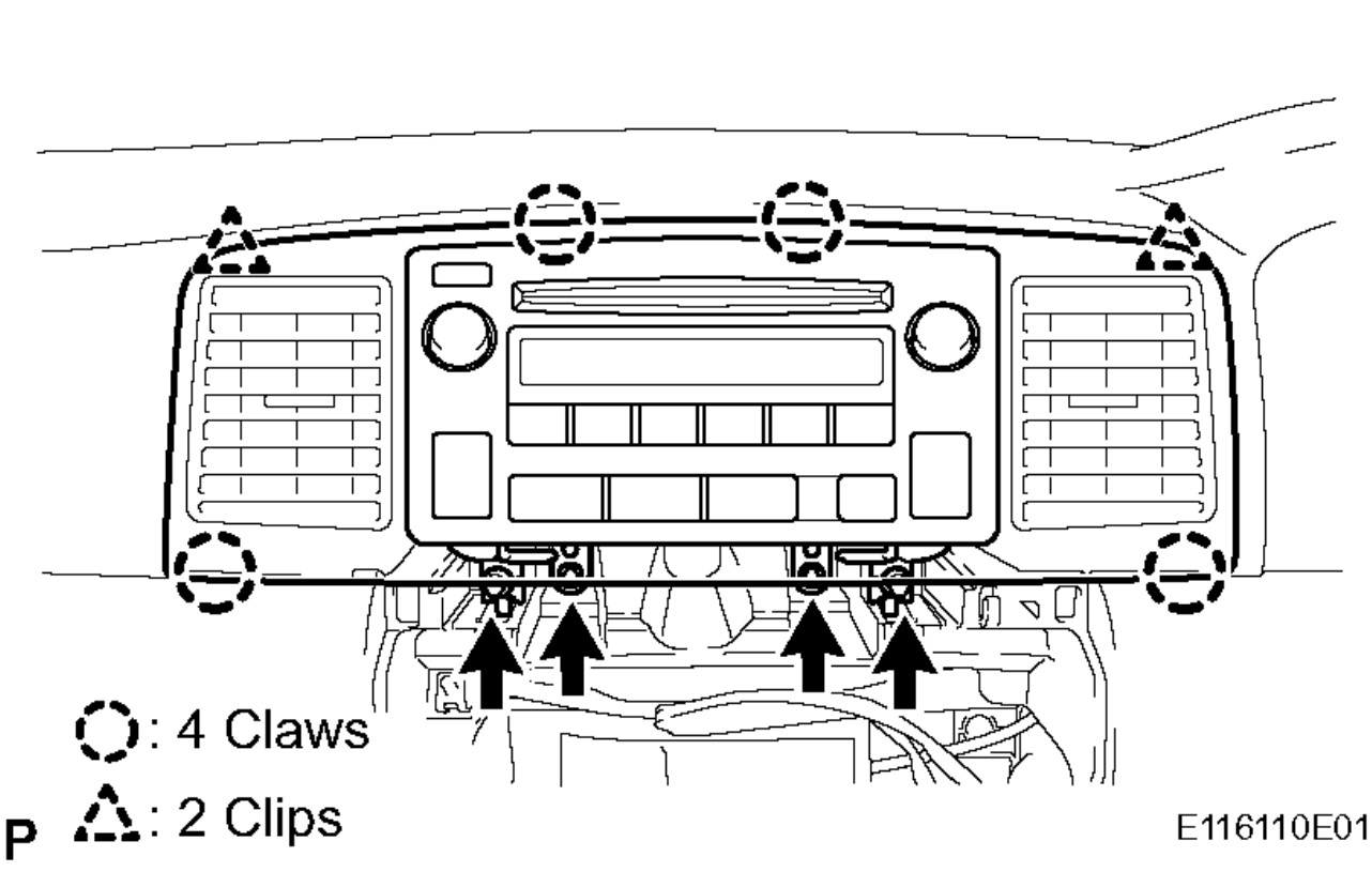

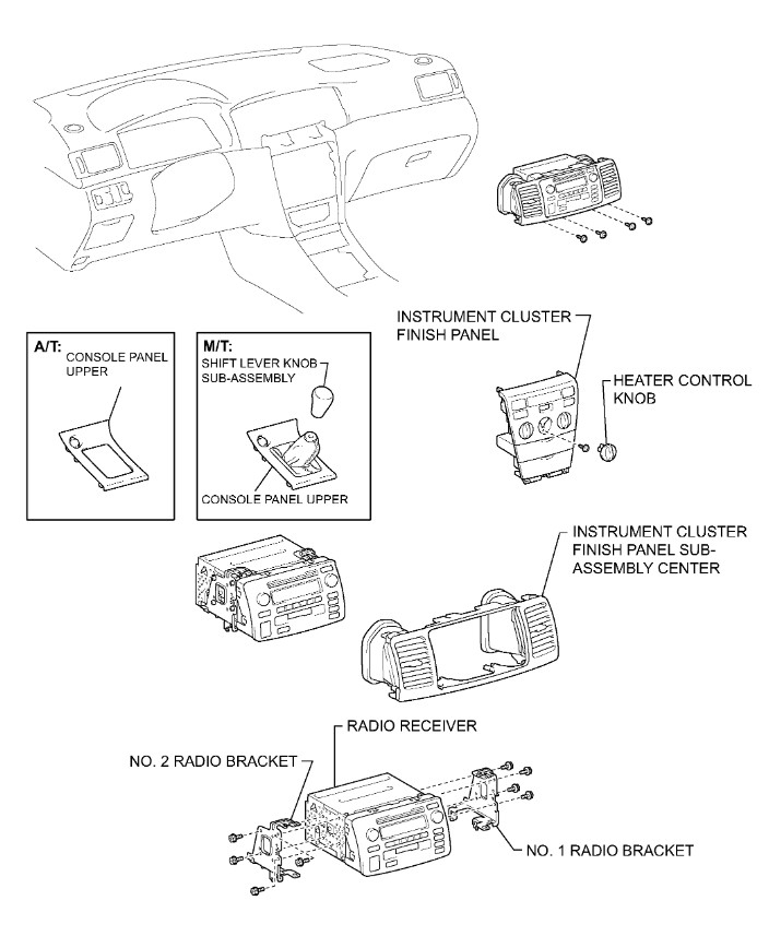

As Ken stated that car did not have a touch screen available. It sounds like it is an aftermarket unit. If they used a kit to install it, you might be able to remove it like the OE unit. Unclip the trim panel around the shifter, then the trim panel above it that has the heater controls. Next you remove the 4 screws that hold the Radio and trim in place. Remove that and then remove the screws that secure the radio in place. If they didn't use a kit, then the above may still help you get in to the unit so you can get the make and model off it. Then you can look up the information on it. It would also let you look at how it was connected. For that it could be anything from a simple adapter harness to someone who cut the wires and used wire nuts or twisted the wires and taped them.

Steve, I successfully removed the trim panel as you suggested. Now, I’m preparing to remove the radio itself but would like to confirm whether it’s safe to disconnect the radio connectors without disconnecting the battery. I’ve heard concerns that disconnecting any connectors might trigger the airbag.
Could you please advise if I can safely remove the radio connectors without disconnecting the battery? Additionally, if there are any precautionary steps I should take, I would appreciate your recommendations.

Unless someone altered the wiring the radio circuits should not have any airbag wiring in the same harness. Usually any of that wiring will be labeled as SRS with a warning on the connectors and is commonly in a yellow covering.

I managed to fix the issue.
I checked it by disconnecting the battery and found that the connector at the back was carbonized due to a loose connection. After replacing the connector, it worked.
