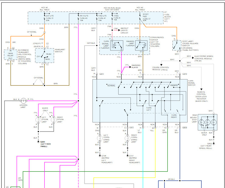

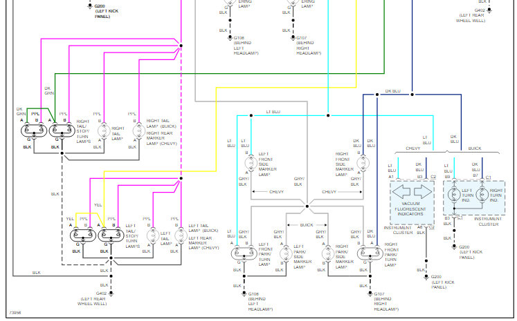

Good evening. there is no side light wiring, that is, when you turn on the turn signal, the side light lights up. I need a diagram of how this wiring goes and how to connect it.

Hello, I'm Danny.
Here is the wiring diagram you requested. I've attached the picture below and cut the picture into 2 pieces to make larger.Let me know if you have any further questions on this issue.Hope this helps and thanks for using 2CarPros.

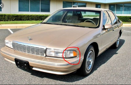

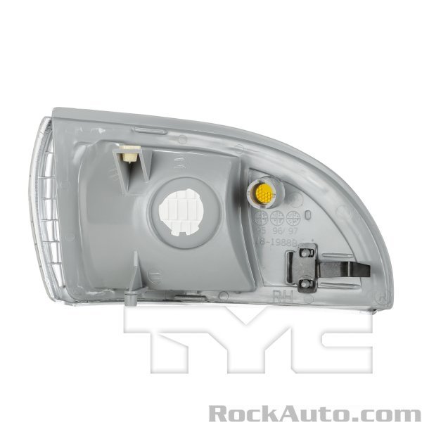

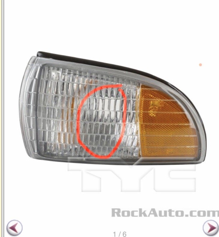

Hello again.

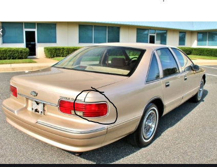

Just to clarify... When you say side lights do you mean the turn signals? I've attached two pictures below front and rear and circled. Or, Do you mean the turn signal indicators on the instrument panel (cluster) that are not lighting up? This will help me aid you in proper diagnosis.Hope this helps and thanks again for using 2CarPros.

I mean side light, when you turn on the turn signal turns on and turn signal and side light.

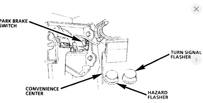

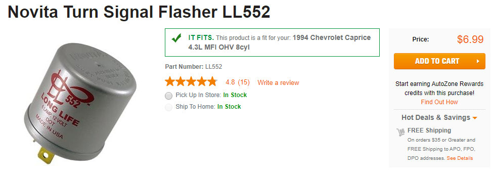

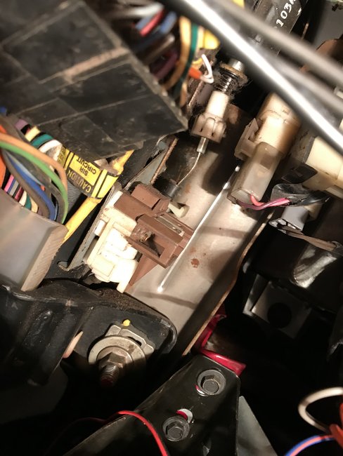

Hello again.
Okay, it sounds like the problem is the turn signal flasher. It is located near the left hand kick panel mounted in the fuse/junction box. I've attached a picture of what the flasher is and its location/description. I've also included a picture/part number as a replacement from AutoZone auto parts stores.Hope this helps and thanks again for using 2CarPros.
