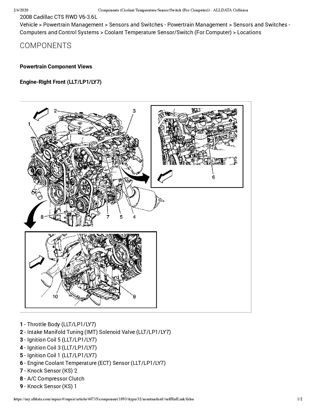

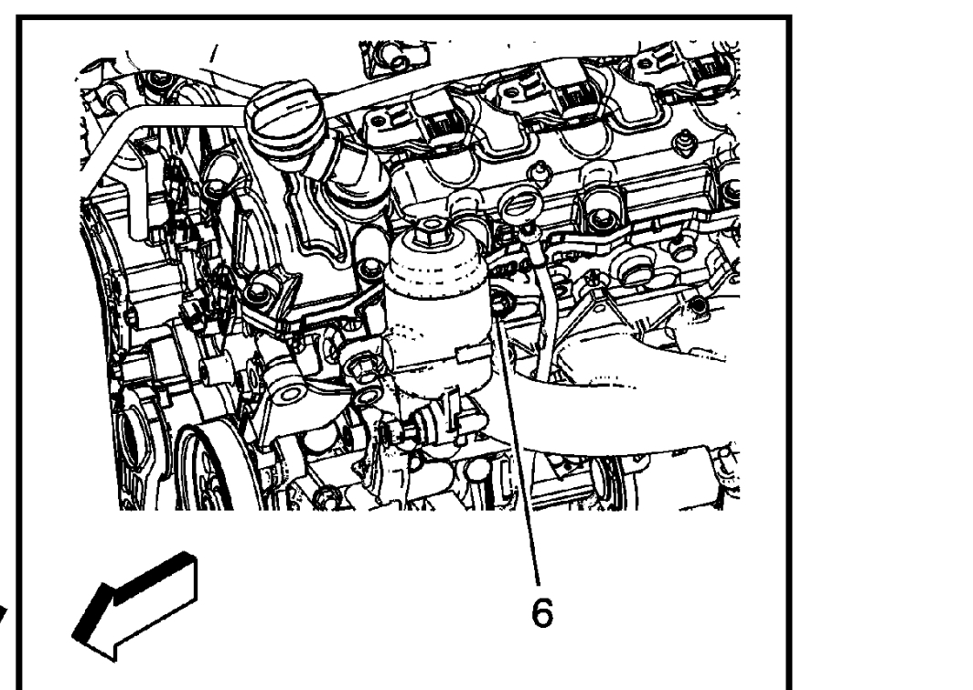

Looking for the Cooling Temperature sensor location in the cart listed above.

Hey PHICKS,
I have attached the location of the coolant temperature sensor below.
Let me know if you have any further questions.
Regards, Joe

I'm attaching a picture of the engine and no. 6 is pointing at the ECT sensor. Let us know if this was helpful and if you need more info.
Thanks
Joe T.
