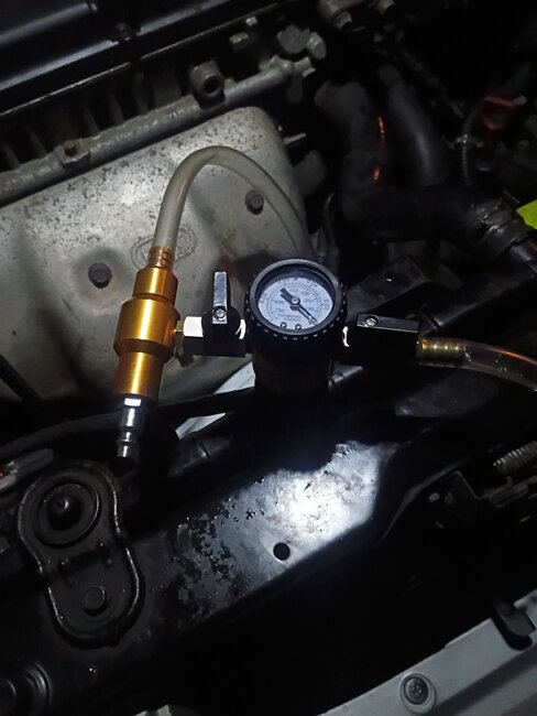

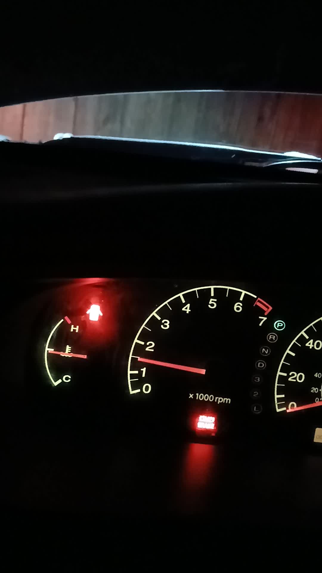

So my fans were only coming on with ac so I replaced the ect sensor and now they come on as they are supposed to but as soon as I replaced it my temp gauge started rising way above normal while I was driving so I figured I had air in the system and while trying to burp it I realized my lower radiator hose was not getting hot at all so because it's cheap I replaced the thermostat (in the correct direction with jiggle valve up) and I also purchased a vacuum airlift coolant refill kit to refill the system. Still cold hose still running hot then I replaced the water pump/ timing belt because my water pump pulley had always made a quiet cyclical squeak and this did not fix my issue either. I poured water through the radiator and it seems to be coming out the bottom pretty well so I'm unsure if it has any blockage but here are my exact symptoms; when I start the car completely cold the temperature gauge ,within seconds, rises up to the operating temp level(even though engine is still cold) everything runs fine and after about 5 minutes or so the low speed fans kick on and by this time the upper radiator hose is fairly hot and heater blows fine. Then the fans will kick on to the high speed. Lower radiator hose still cold( thermostat housing gets hot) just not the hose. I then will rev the engine and get the rpms up to about 2500 and after holding it there for about 30 seconds the temperature gauge will slowly creep up to about 1/4 of the way between the center mark and the maximum hot if I then let off of the gas it will pretty quickly drop back down to right below center mark where it has always normally stayed at. The fans never turn back off, and if I turn the cabin heat off the temp gauge creeps up to the center mark and I'm sure even further if I left it run but I usually shut it off around this time to not do any engine damage. There are no symptoms of major overheating no boiling over coolant, no steam, but the lower radiator hose doesn't seem to ever warm up and also the radiator fins from left (passenger side) to the right (driver side) goes from warm to very cold and the top is very hot and not at all on the bottom.

Wow, you are not kidding the temperature gauge goes up quickly while revving the engine, thanks for the video. The fact that the lower hose is not heating up is the issue. So this leaves the thermostat or the water pump. I have seen the water pump impeller come off the main shaft but I don't think it can happens twice so I would remove the thermostat for now to see if that fixes it, and if so purchase an OEM unit and install it. Also, I have seen a loose connection at the coolant temperature sensor cause the gauge to malfunction so please heck the as well. Let me know how it goes

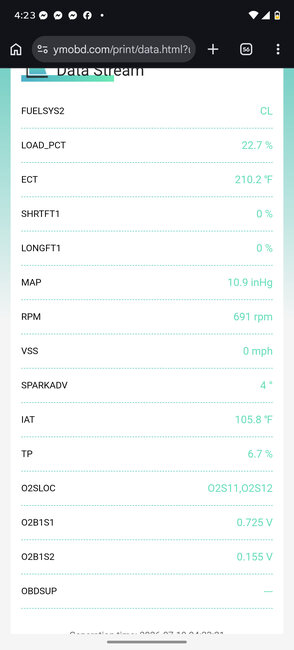

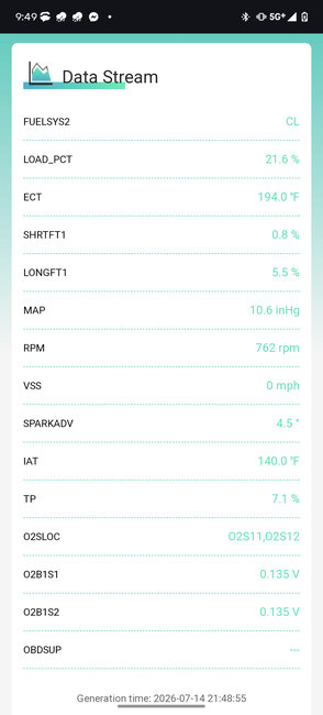

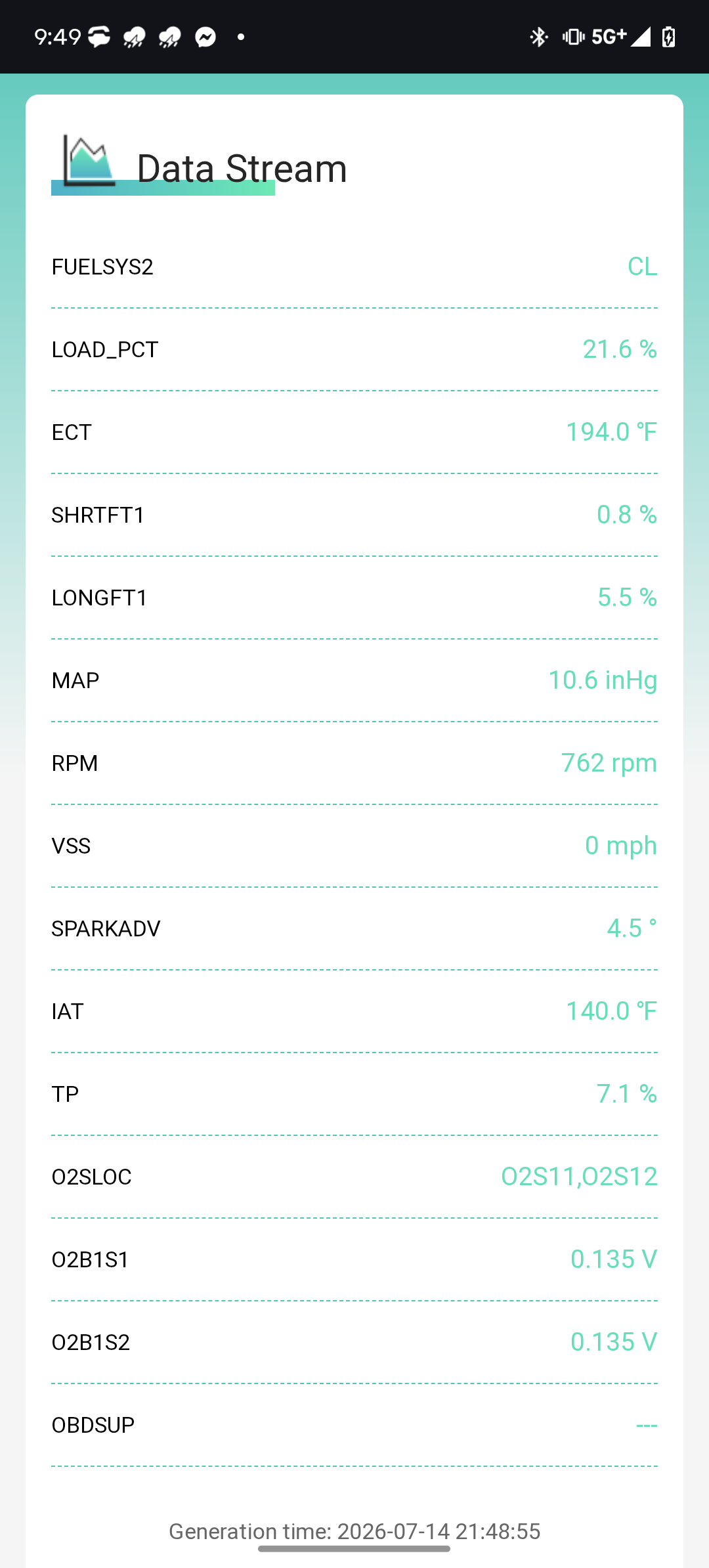

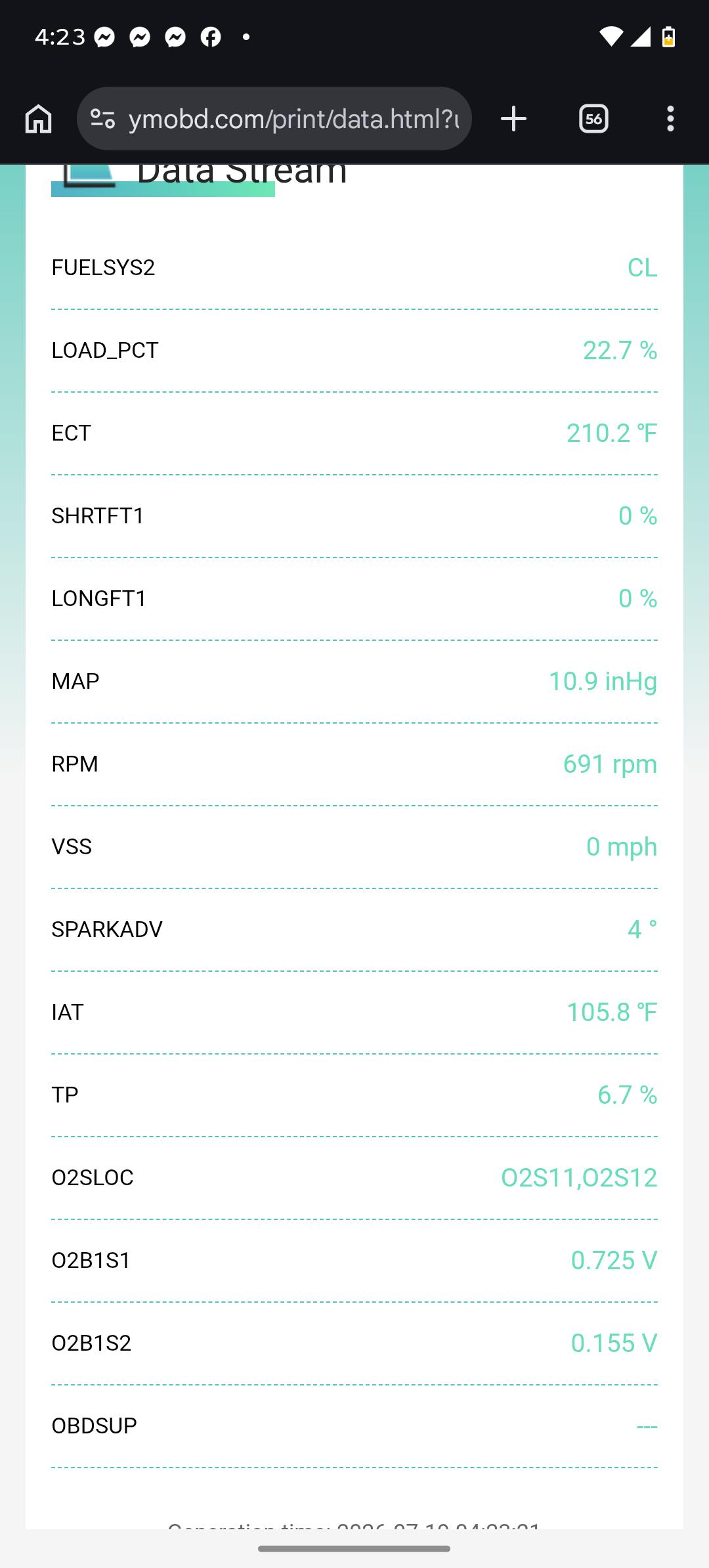

Hello so I ended up doing a combustion leak test with leak detection fluid and the car passed. I have also removed my radiator and ran the hose through it and some dishwasher detergent to try and see if there was a blockage and attempt to break it loose. I did forget that when replacing my alternator recently I dinged up the radiator on one side I'm not sure how badly that would have to be for it to cause circulation issues. So I put it back together and then reinstalled a new OEM thermostat to see if either of those things fixed my issue. And nope, lower radiator hose still way cooler to the touch and still overheating. On top of all of that it's been idling extremely rough noticably since doing all this work to it I'm not sure if the cause. I got one of the scanners that reads live pcm data and google says it's all good numbers but I don't know for sure. I've attached a video of my radiator flow and some of data to see if you think I need a new radiator or if it's something else causing the circulation issue. Also the pcm data is all during which I was driving without the thermostat installed and no overheating was occuring and one other thing I forgot to mention is that on very hot days,and while driving on the highway up the mountain the temperature slightly overheated twice even with thermostat removed but only to about 225° -230°F...

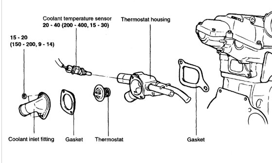

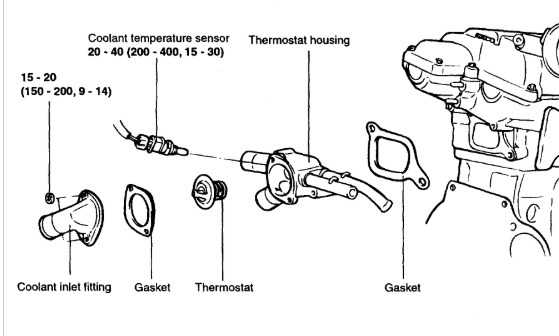

Yep, the radiator is not the problem, it seem like the water pump is the issue, if the impeller is corroded or lose on the shaft it will cause this issue but you said you replaced the water pump correct? Here is how the thermostat should be installed.

Yes I replaced the water pump, and I have the OEM thermostat installed correctly. I am at a total loss at this point for what could be the issue. I really thought that replacing the thermostat with an OEM one would fix it. It drives perfectly fine with the thermostat uninstalled. But as soon as I install it and try to drive it overheats. After putting the new OEM thermostat in the lower radiator hose even got a bit of warmth to it nothing near how warm I think it's supposed to be but noticably warm compared to how cool it was staying with the other thermostat.
