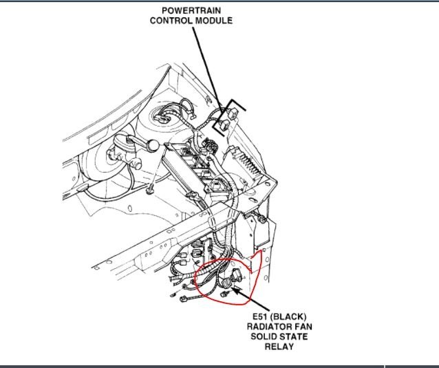

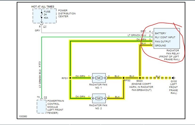

Overheating is a mechanical issue. There are no codes for overheating. The only code that may come up is if the radiator cooling fans are not working. The cooling fan relay was a common failure for the fans if they are not working. I attached the location and a wiring diagram for you.

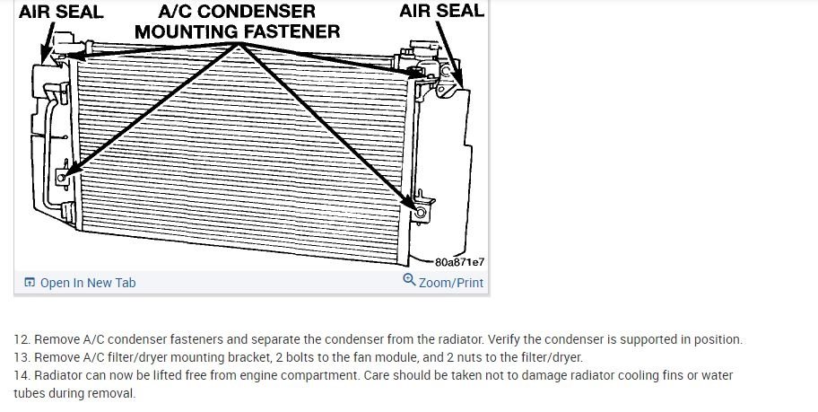

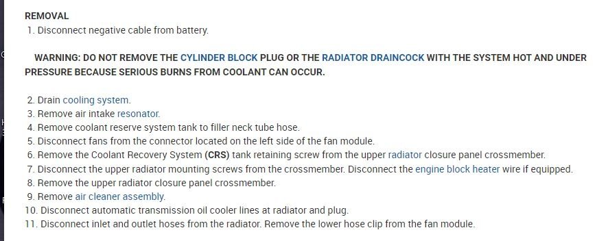

The other thing is the radiator. If it is clogged, it will cause this overheating. You need to have the radiator flow tested to see if it is clogged. I attached the procedure for replacing the radiator below.
https://www.2carpros.com/articles/how-to-replace-a-car-radiator
