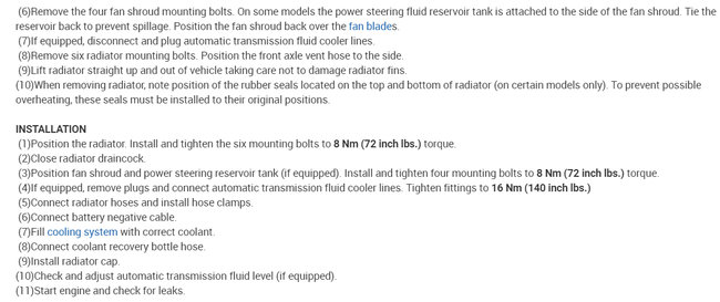

Nice work, I agree with Danny the radiator could be plugged the only thing you can do is replace it. Also lets check for a blown head gasket.
This guide will walk you through the steps on how to replace the radiator:
https://www.2carpros.com/articles/how-to-replace-a-car-radiator

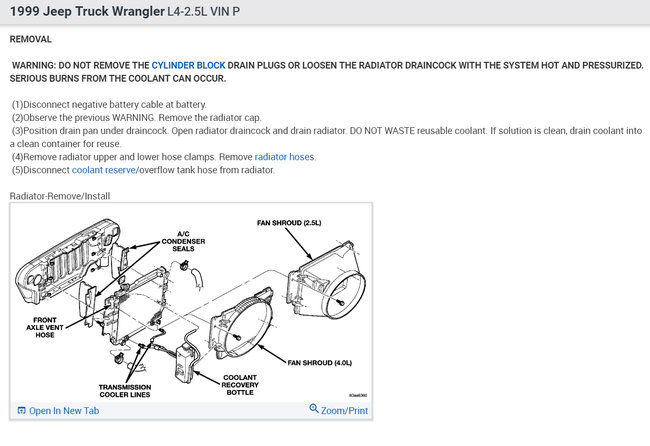

It really sounds like the radiator is the issue. Here is a guide to help you step by step and diagrams below to show you on your car.
