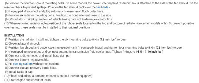

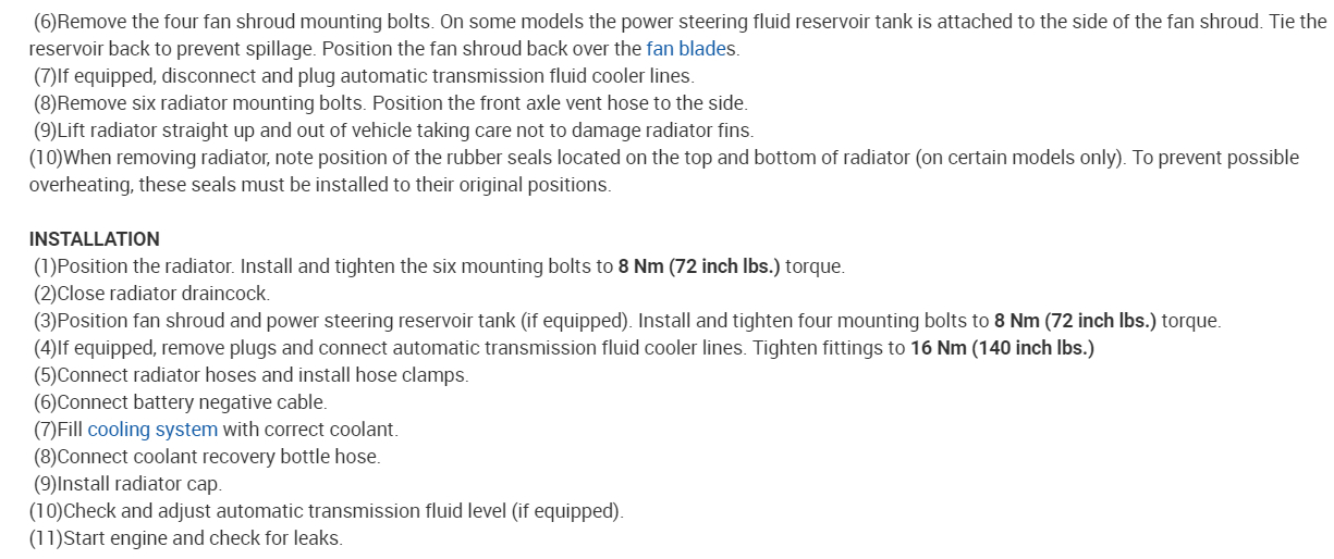

Here's an update. Since I made sure the thermostat was installed correctly (about a week) i haven't had any problems with the lower radiator hose. Until yesterday. Out of nowhere it ran hot. I pulled over immediately and lifted the hood. I could see and hear the water literally boiling in the overflow. I let it cool down and checked it. The water was not low. Both of the hoses were hot. The top one a little warmer than the bottom. From what I understand that's how they are supposed to feel??? Im thinking your advice of a new radiator is the next step. If that doesn't solve the problem then maybe a for sale sign??!! Lol
Oct 24, 2018 at 12:56 PM
  • 55,224 POSTS

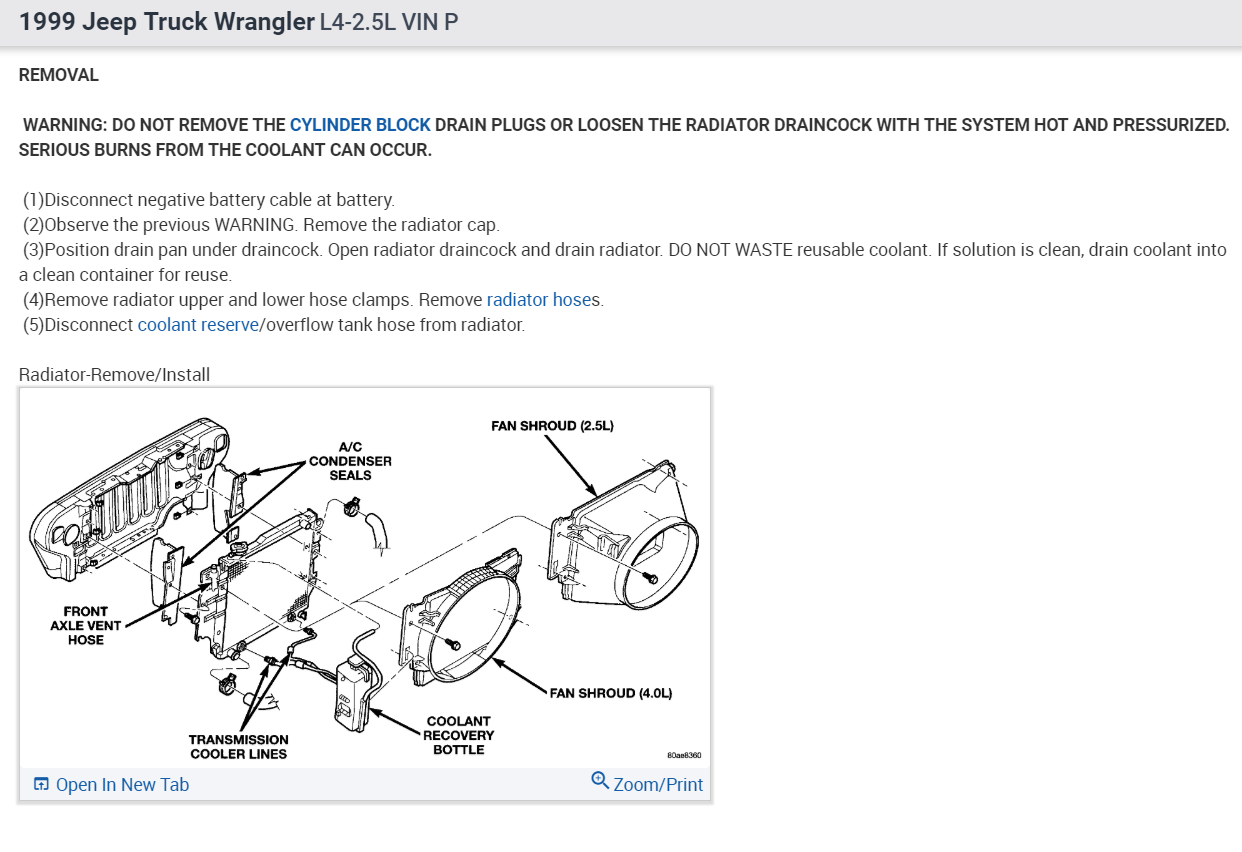

It really sounds like the radiator is the issue. Here is a guide to help you step by step and diagrams below to show you on your car.
https://www.2carpros.com/articles/how-to-replace-a-car-radiator
