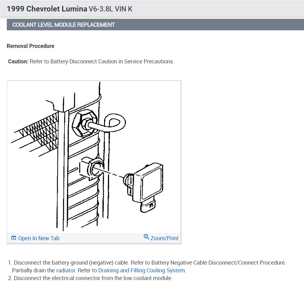

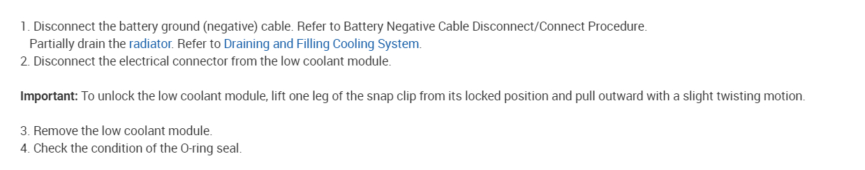

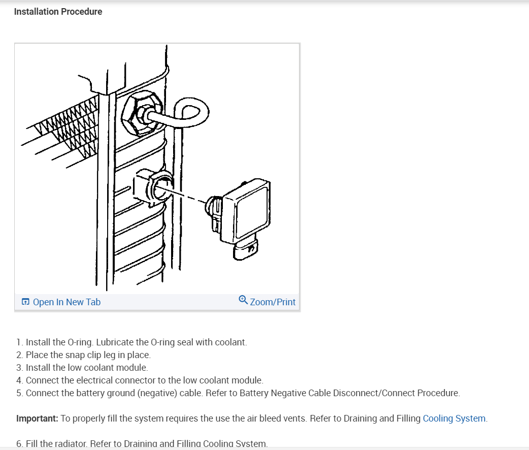

Why would my new coolant level sensor leak?
Jul 25, 2022 at 8:50 AM
  • 55,732 POSTS
Does it have a new O ring? Is it the sensor itself? If you can upload a picture of the problem I can tell for sure. Here are the instructions for the sensor replacement, maybe we can look to see if something is a miss? Check out the diagrams (below). Please let us know what you find.
