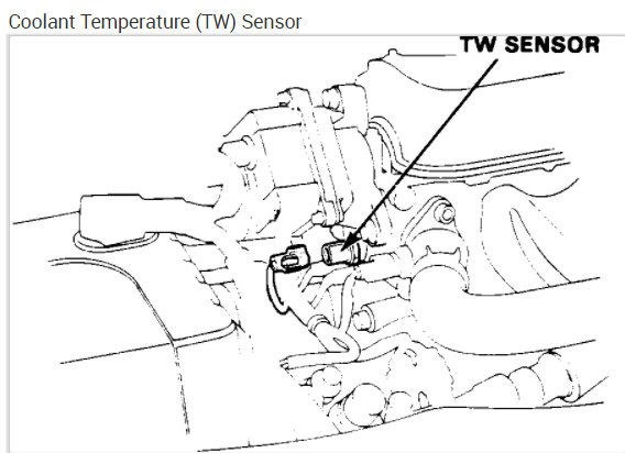

My coolant fan is only working when my air conditioner is on. I've checked the relays and fuses everything is good there when I shut the car off the fan runs for 10 minutes but never comes on during operation. I can't find the schematics for the coolant temperature switches and all the other switches that I need to check what can I do. please help me.

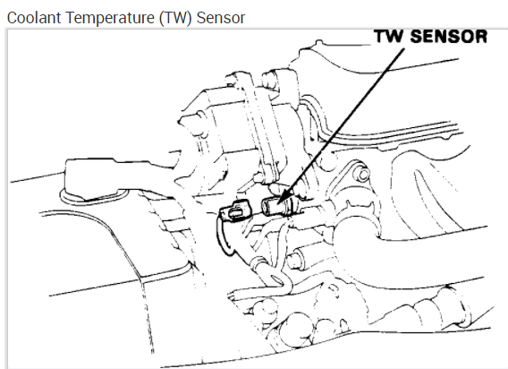

Your car should have 2 electric fans.One fan will come on and stay on continuously when you have the air conditioner on.The second fan which you say is not working should come on when the engine is running to prevent overheating.That will be controlled by the coolant temperature sensor.It sounds like that switch is defective or not working.Here are a few tutorials for you to view showing its replacement and operation:
https://www.2carpros.com/articles/how-a-coolant-temperature-sensor-works
https://www.2carpros.com/articles/symptoms-of-a-bad-coolant-temperature-sensor
https://www.2carpros.com/articles/coolant-temperature-sensor-cts-replacement
I've attached a picture below showing its location on your car.It's near the distributor and thermostat housing.Hope this helps and thanks for using 2CarPros.
