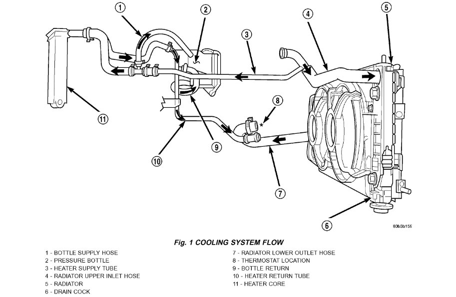

Cooling system diagram
2002 DODGE INTREPID
166,000 MILES • 3.5L • 6 CYL • 2WD • AUTOMATIC
KICKSTAAND
Don't know where all of the smaller coolant hoses go on the left side of the motor.

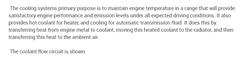

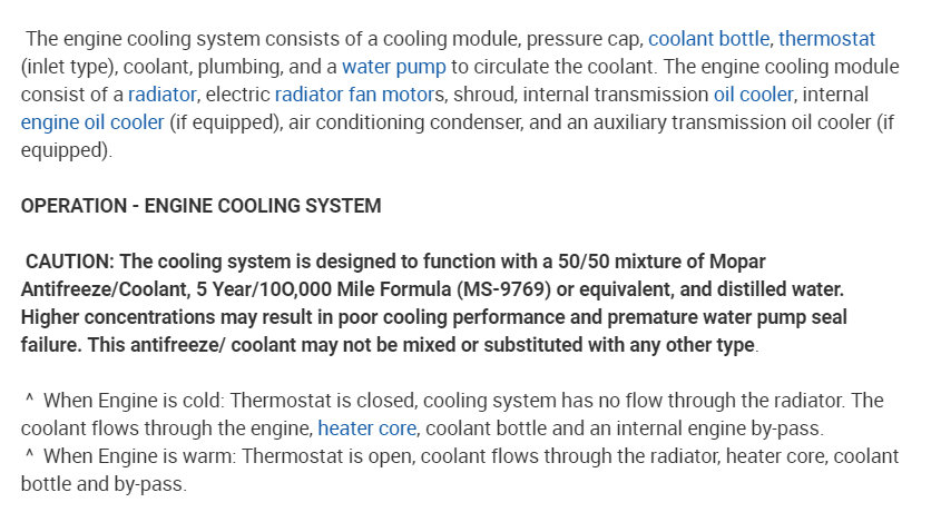

Hello.
I have included the information that you requested in the diagrams down below. Please go through the information and get back to with how things turn out, please.
