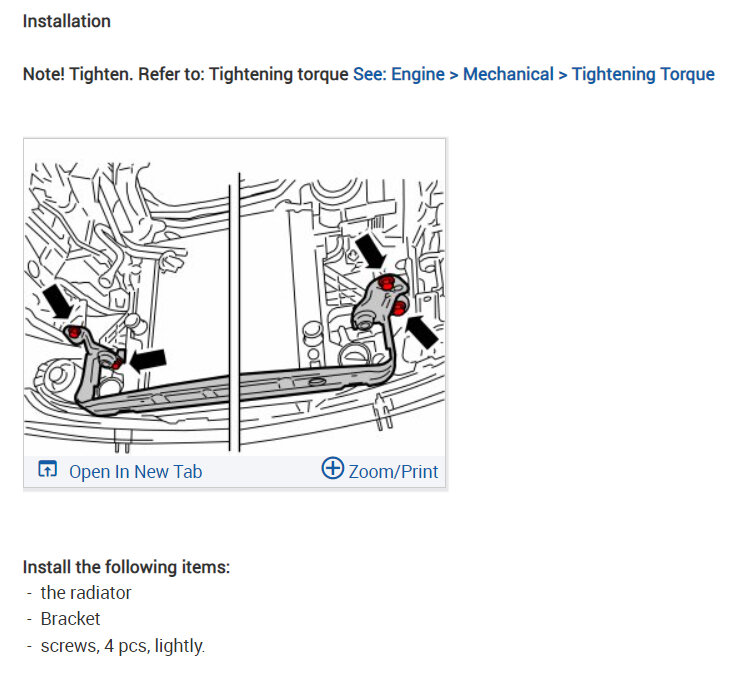

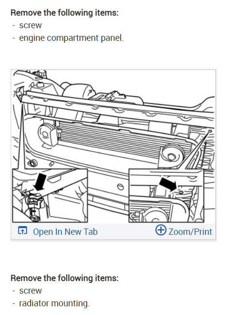

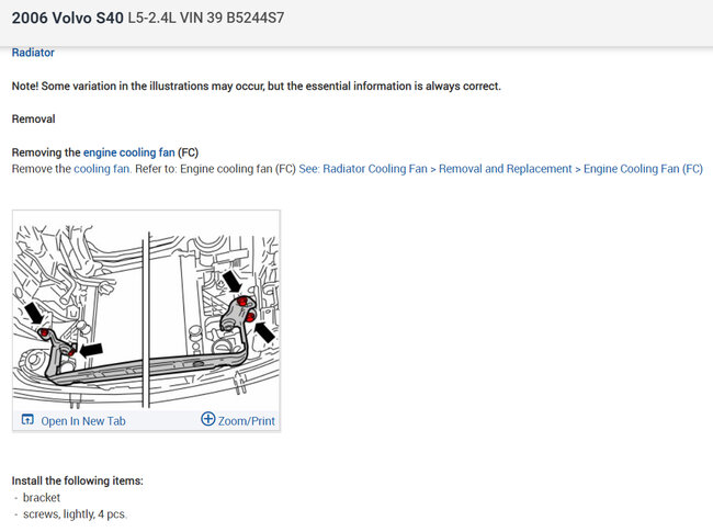

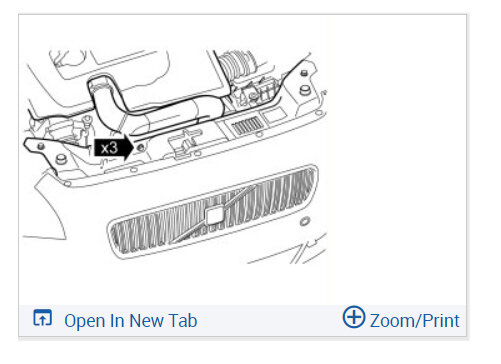

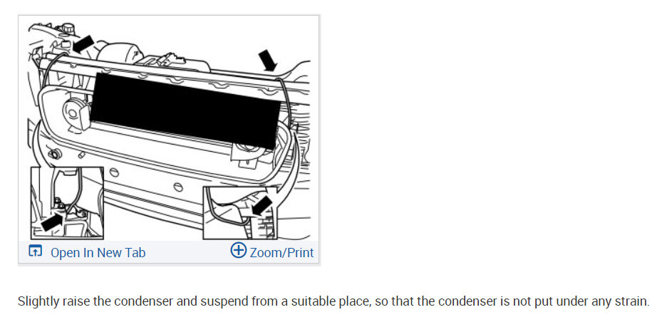

My radiator is leaking, and I need to replace it. I was just wondering how long that might take.
Mar 6, 2024 at 2:40 AM
  • 55,402 POSTS

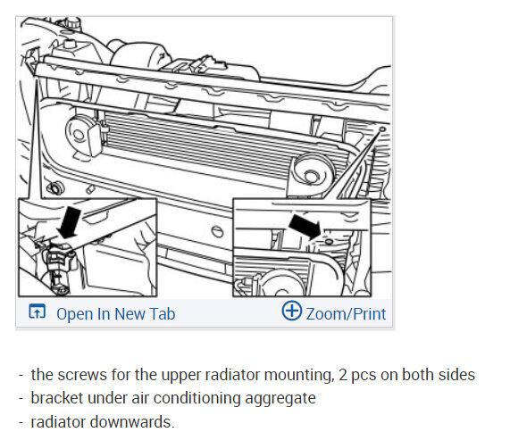

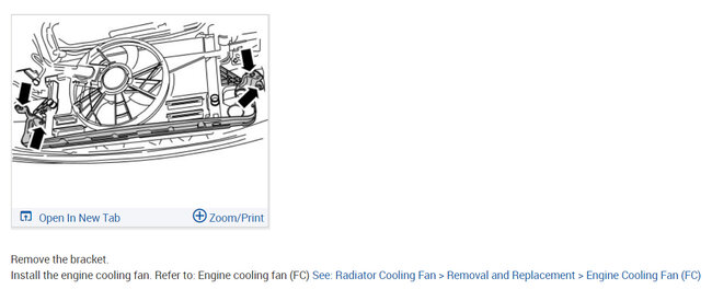

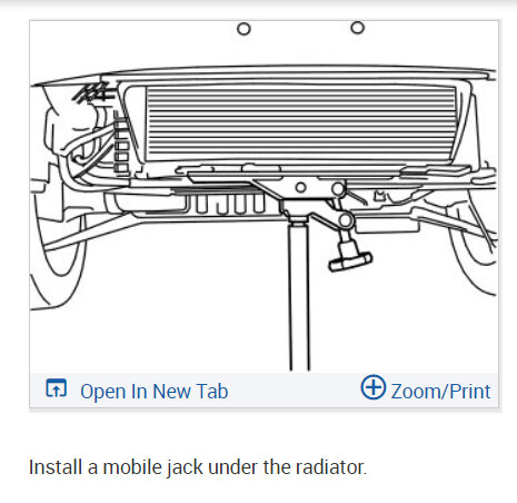

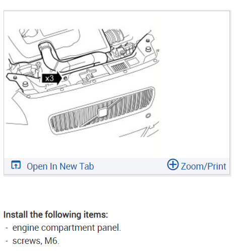

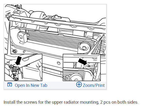

Here is the labor time to change the radiator and how the job is done so you can see what needs to be done.
Radiator R&R 2.8 hrs @ shop rate.
Here is a generic guide to help walk you through the steps with intrusions for your car in the images below.
https://www.2carpros.com/articles/how-to-replace-a-car-radiator
Check out the images (below). Let us know if you need anything else.
