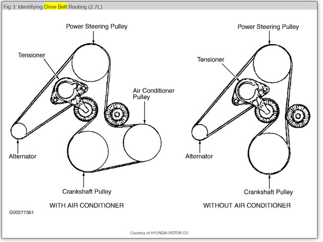

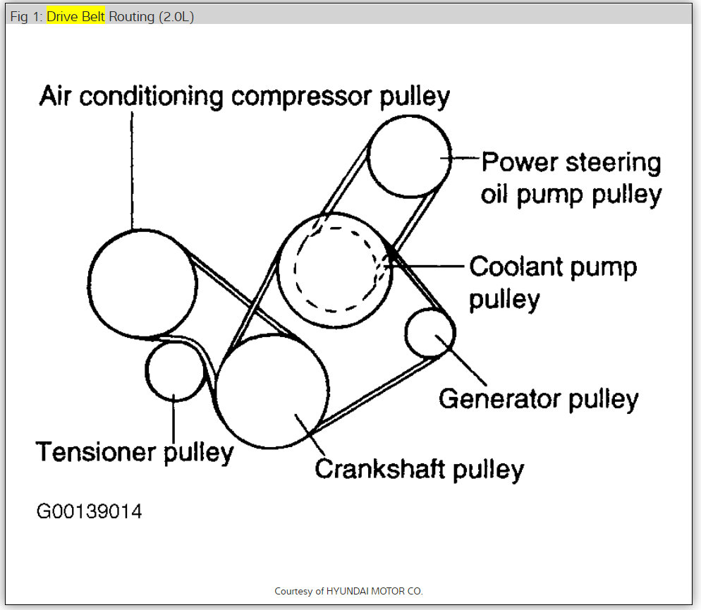

  • 55,732 POSTS
Yep, we are confused because your car does not show a super charger. Here are the belt diagrams for both engine. but I do not see a super charger. Can you get a picture of the engine of us?
