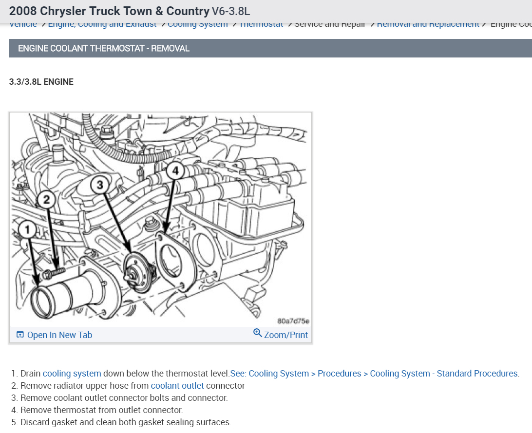

BOBBYHALLI
Actually I did take it to AutoZone to have a scan done before the email and they told me it was a thermostat. I'm not sure if it is or not.
Dec 22, 2018 at 12:25 PM
BOBBYHALLI
AutoZone told me it was the thermostat, but I am not sure because the the radiator cap was warm to the touch not hot like it's supposed to be. I was able to keep my hand on it for long time. Anyways check engine light still on this morning and red lightning bolt is not showing now.
Dec 22, 2018 at 12:30 PM
  • 54,832 POSTS
Yep, that will do it. Here is a guide to walk you through the steps and diagrams below to show you how on your car:
