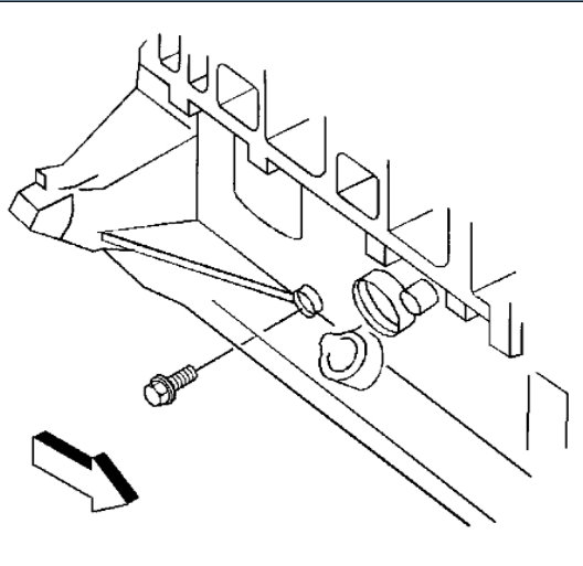

I need to find out how to drain the coolant system, flush and fill.
Nov 5, 2020 at 1:01 AM
Experienced Mechanic
52,796 POSTS
Good afternoon,

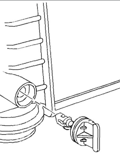

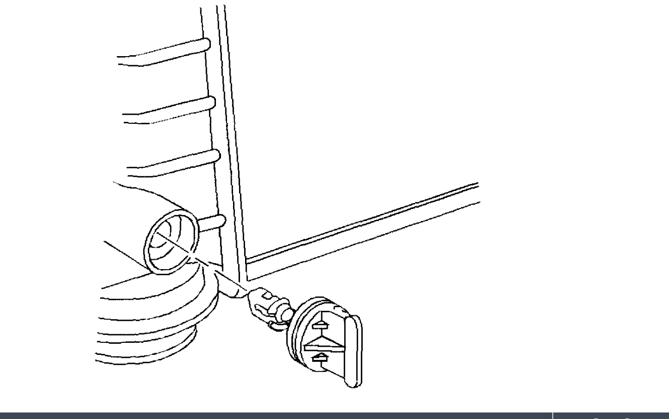

I attached a picture of the drain plug at the bottom of the radiator for you.
https://www.2carpros.com/articles/coolant-flush-and-refill-all-cars
You turn it to release it.

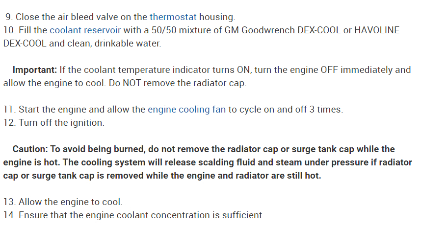

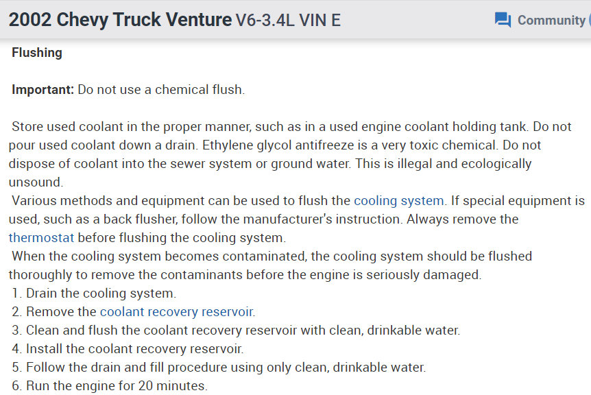

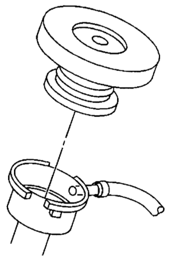

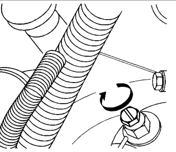

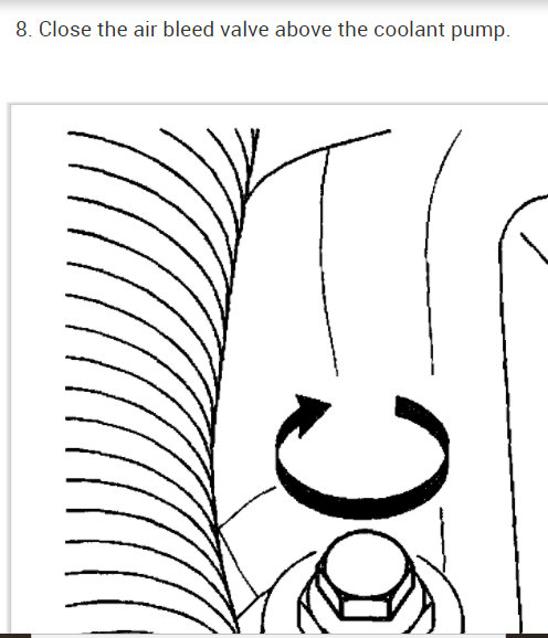

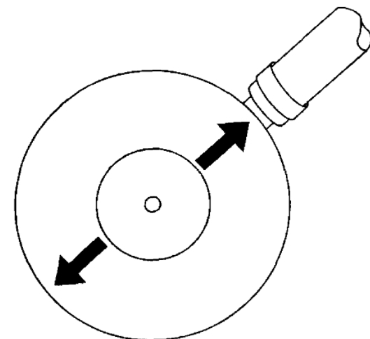

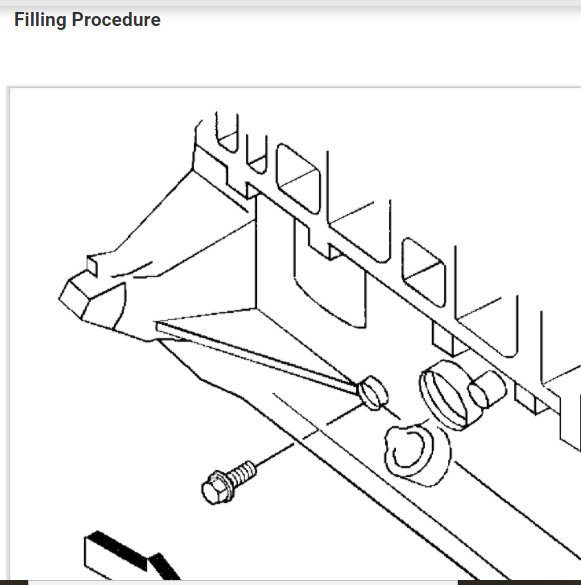

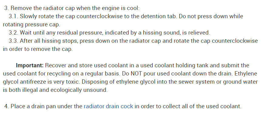

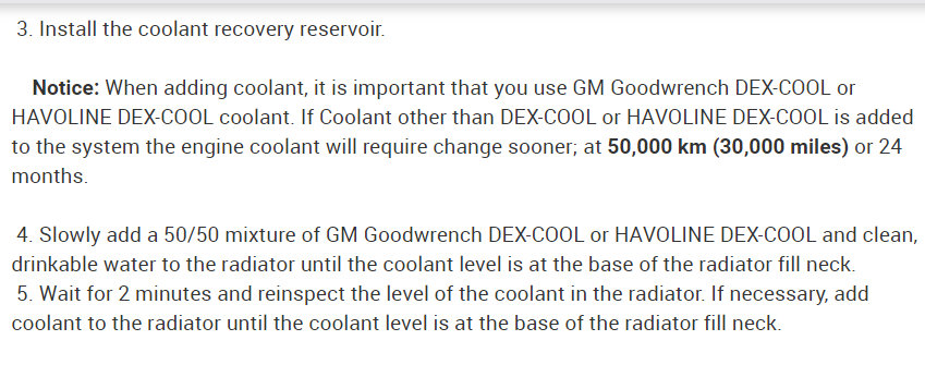

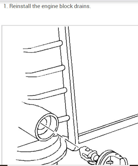

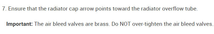

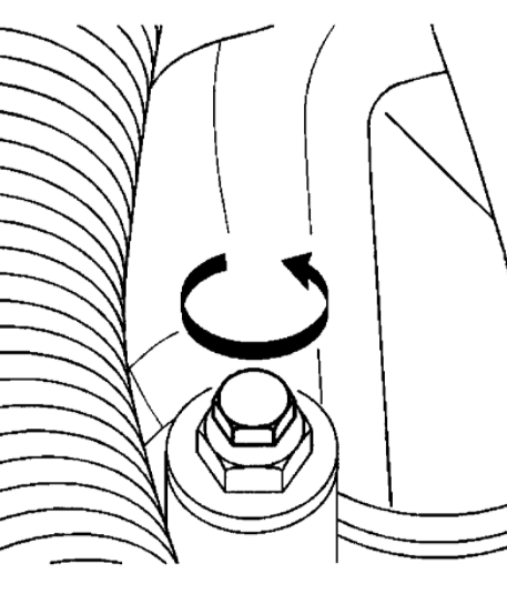

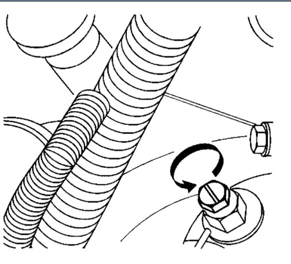

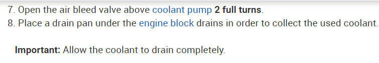

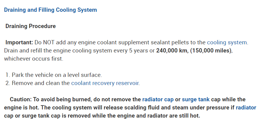

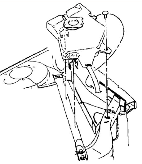

Here is a tutorial showing what is involved for coolant replacement, flush, and fill:

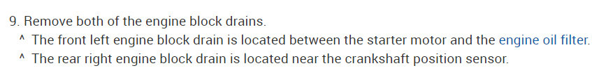

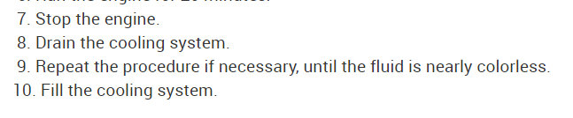

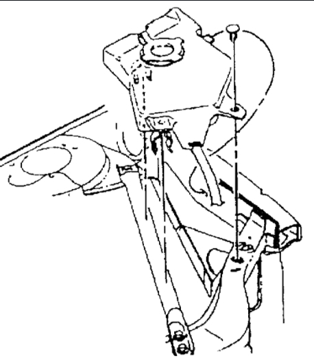

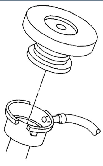

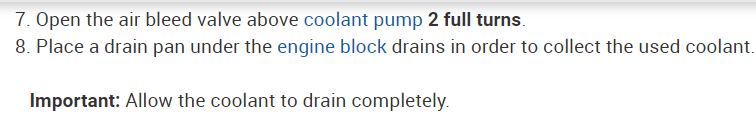

I've attached picture steps below for your car. Hope this helps and thanks for using 2CarPros.
