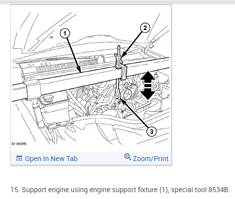

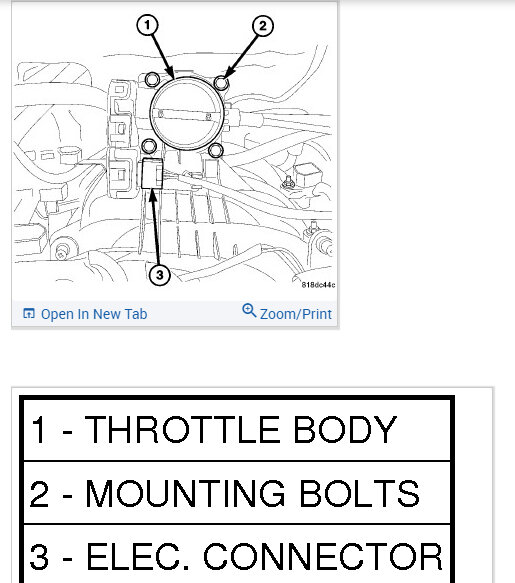

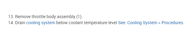

I’ve decided to go ahead and do the head gaskets. I have the alternator, ac compressor, power steering pump, fan shroud, both valve covers off. I also have the air intake unbolted but can’t get it to come off. It’s hitting where the firewall folds out over the throttle body. I removed the throttle body, but it still hits on the throttle body mount. I can’t slide it forward because the heads wrap in front of intake. I’m wondering if I need to take it off at all. I set the timing mark on the crank to top dead center and both cam sprockets are in the wright position. Do I need to remove the timing chain cover to get the cam sprockets off? I wasn’t planning on doing the timing chain. I still need to unbolt the exhaust manifolds, which looks like it won’t be easy. The spark plugs all look good and there is no water in the oil.
Apr 11, 2023 at 8:51 AM
  • 110,240 POSTS

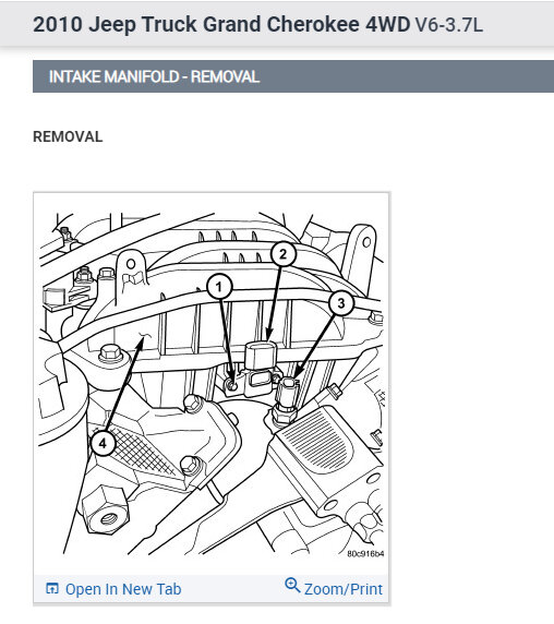

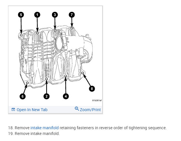

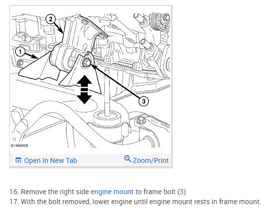

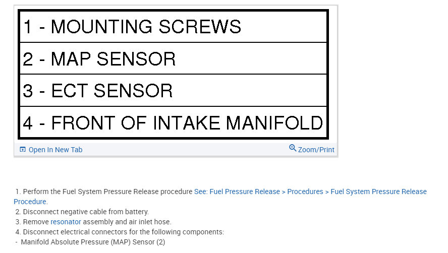

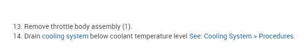

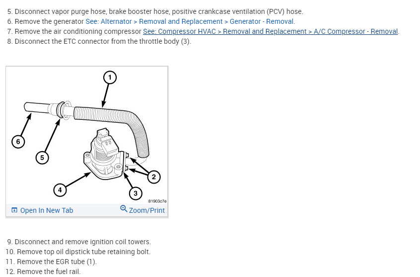

This is a big job. To remove the intake (it is required and is bolted to the cylinder heads) you need to remove the lower motor mount on the right side and then lower the mount until it touches the frame. I attached the directions below.
By chance, were you able to perform a compression test to confirm we have a head gasket issue?
Apr 11, 2023 at 1:48 PM
