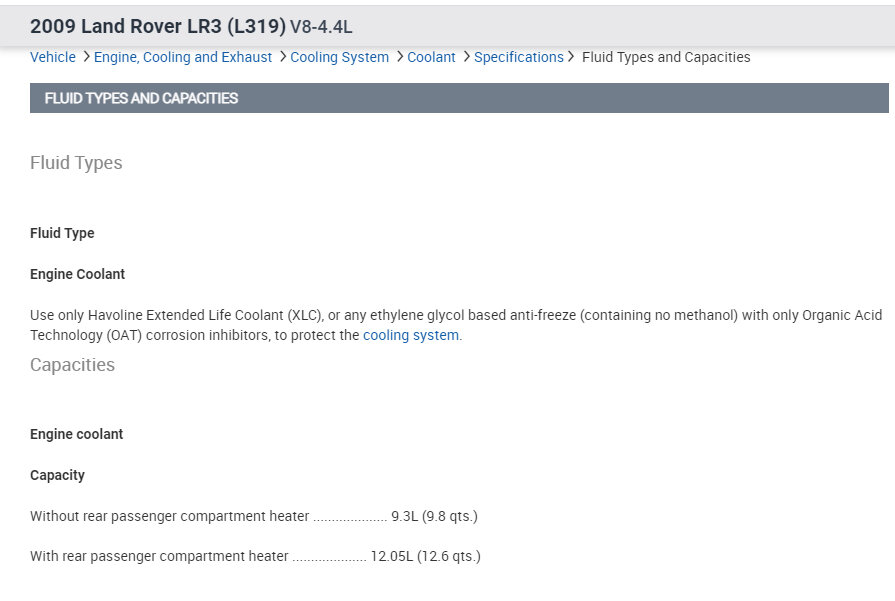

I have a discovery 4 Land Rover,
How many liters of coolant does it take dry fill.

I believe I found the correct one. By chance, does the vehicle have a 4.4L and not a 4.0L? If so, take a look at the attached pic. If that is incorrect, let me know.
See pic below.

You are right.
Thank you
