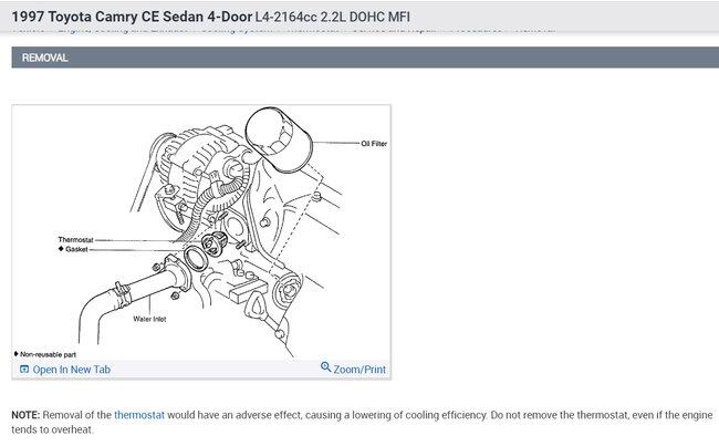

After starting the engine water is pushed out of the radiator into the coolant slowly. This happens at any temperature. The head gasket, water pump and radiator cap have all been diagnosed there's no problem there.
Jan 15, 2023 at 9:12 PM
  • 55,065 POSTS

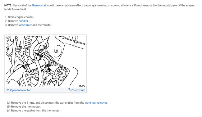

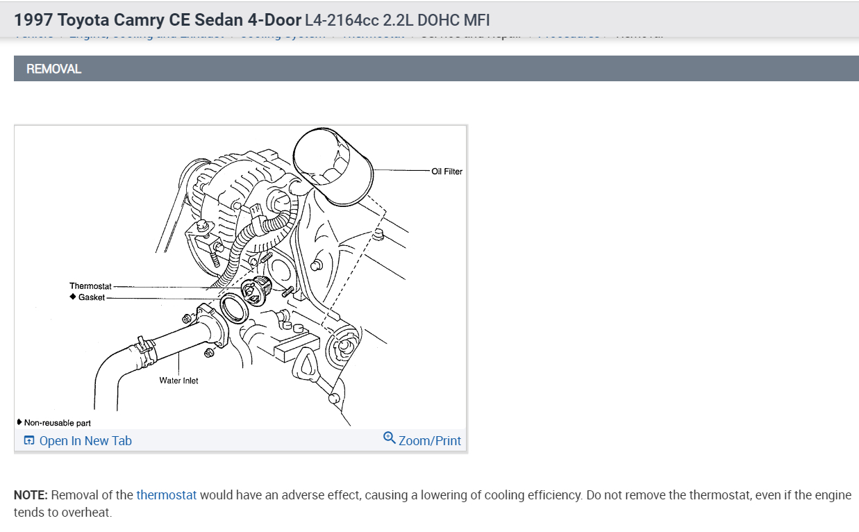

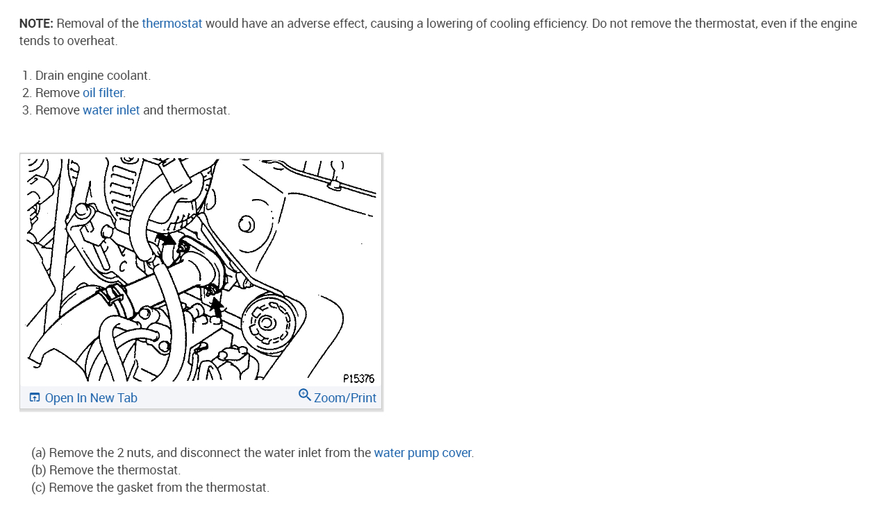

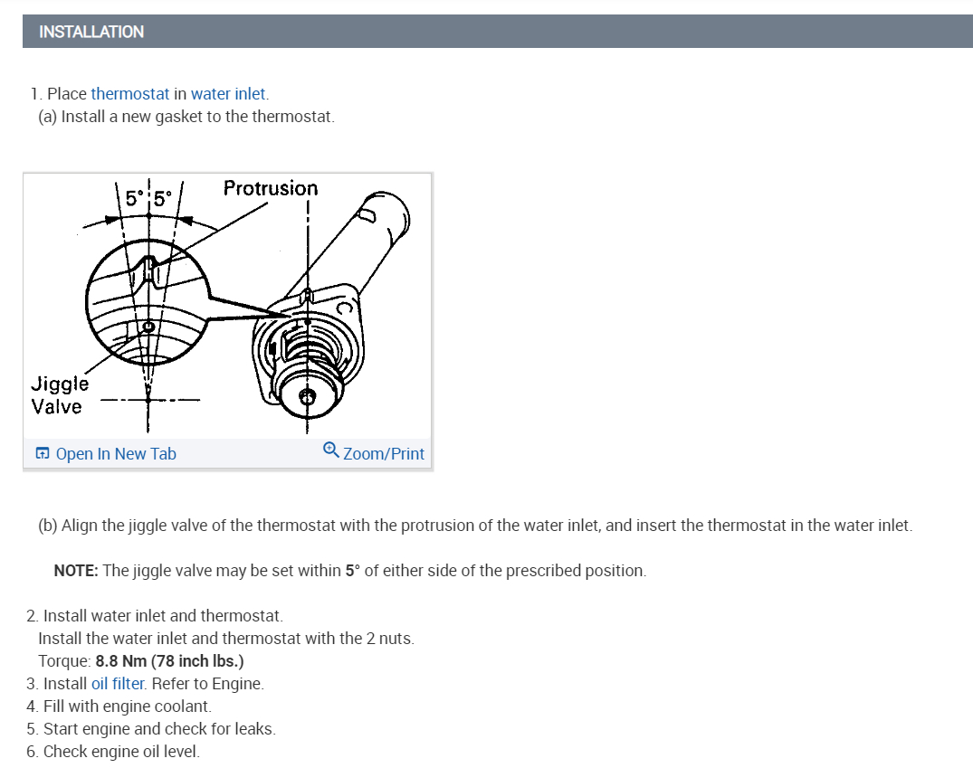

It sounds like the thermostat is not opening completely, or they missed the head gasket failure which happens because the chemical test is only about 80% correct. Are you losing coolant? Let's try the thermostat first.
Here is a guide that will help walk you through the steps with instructions below for your car:
This guide can help as well:
Check out the images (below). Let us know what happens and please upload pictures or videos of the problem.
