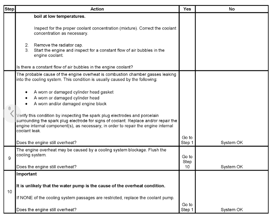

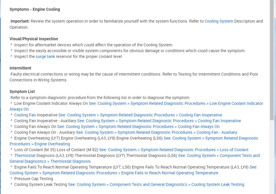

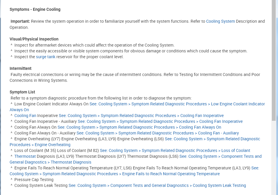

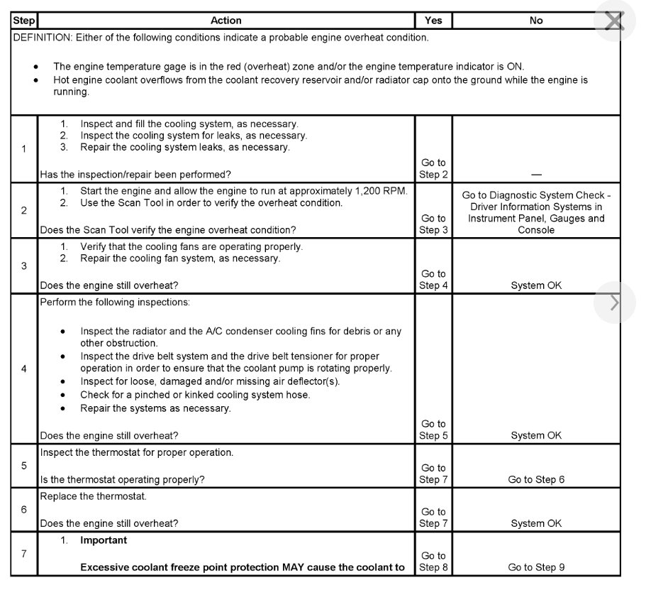

Just to add to this, are the cooling fans coming on?
I attached some testing which includes the things you replaced but also a few other things that we need to check.
As the engine begins to get to 210 degrees F the fans should be on high, if not then that is the issue. Let us know what you find with all this info. Thanks
