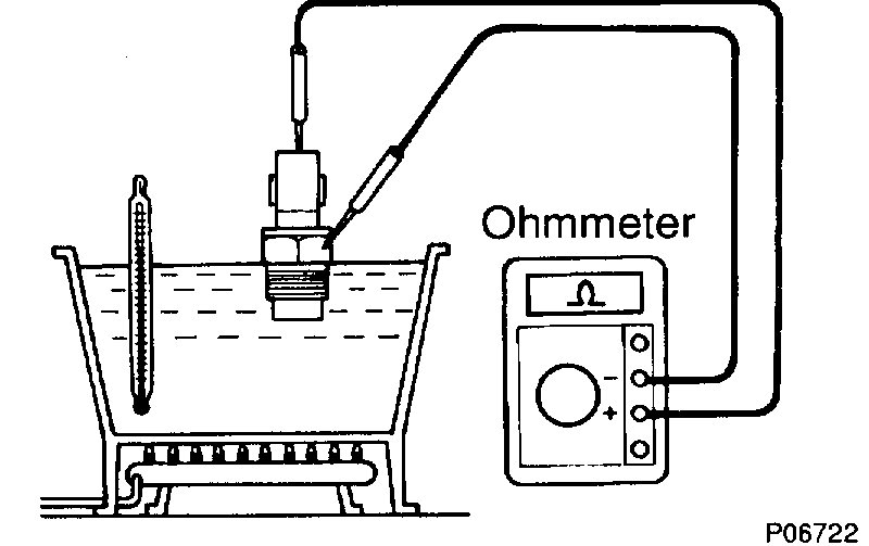

My cooling fans only run low when the defrost is on. And only sometimes. the fans will not kick on by them selves and the A/C and heat does not kick them on. Only the defrost and it works sometimes and sometimes they don’t come on at all. I checked the relays and unplugged the sensor and nothing changed.
Mar 10, 2019 at 6:55 AM
  • 110,244 POSTS
Welcome to 2CarPros.
The first thing you should check are the coolant temperature sensors. That is what sends the signal to operate the fan other than when the AC or Defroster is on. There are two engine coolant temperature sensors (ECT).
Here are the directions for testing the sensors:
INSPECTION
1. DRAIN ENGINE COOLANT
2. REMOVE ECT SWITCHES
Picture 1

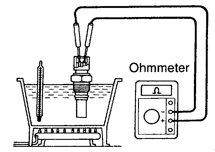

3. INSPECT NO. 1 ECT SWITCH
a. Using an ohmmeter, check that there is no continuity between the switch terminals when the coolant temperature is above 98°C (208°F).
If there is continuity, replace the switch.
b. Using an ohmmeter, check that there is continuity between the switch terminals when the coolant temperature is below 88°C (190°F).
If there is no continuity, replace the switch.
Picture 2
4. INSPECT NO. 2 ECT SWITCH
a. Using an ohmmeter, check that there is continuity between the switch terminals when the coolant temperature is above 94°C (201°F).
b. Using an ohmmeter, check that there is no continuity between the switch terminals when the coolant temperature is below 83°C (181°F).
If continuity is not as specified, replace the switch.

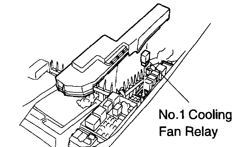

If the sensors are good, then you need to check the relays. I realize you moved things around, but you need to test things to confirm.
COOLING FAN RELAY
INSPECTION

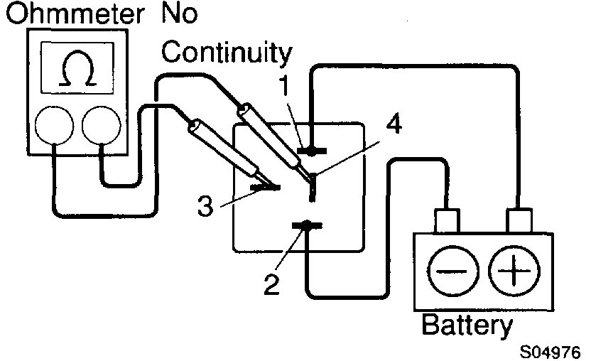

1. INSPECT NO. 1 COOLING FAN RELAY
Picture 3
a. Remove the No. 1 cooling fan relay. (Marking: FAN NO. 1)
Picture 4

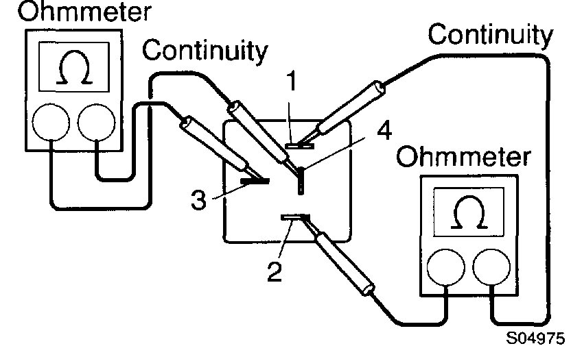

b. Inspect the No. 1 cooling fan relay continuity.
1. Using an ohmmeter, check that there is continuity between terminals 1 and 2.
If there is no continuity, replace the relay.
2. Check that there is continuity between terminals 3 and 4.
Picture 5

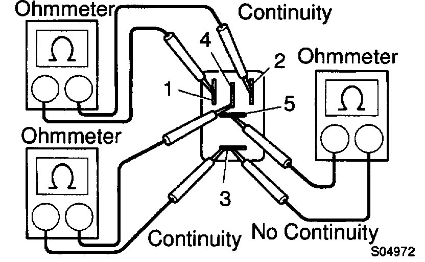

c. Inspect the No. 1 cooling fan relay operation.
1. Apply battery voltage across terminals 1 and 2.
2. Using an ohmmeter, check that there is no continuity between terminals 3 and 4.
If there is continuity, replace the relay.
d. Install the No. 1 cooling fan relay.

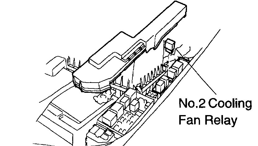

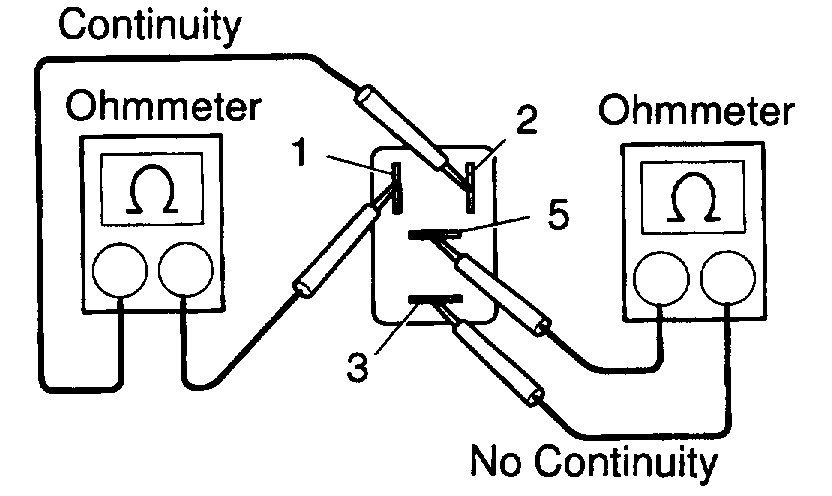

2. INSPECT NO. 2 COOLING FAN RELAY
Picture 6
a. Remove the No. 2 cooling fan relay. (Marking: FAN NO. 2)
Picture 7

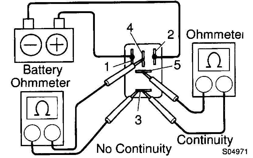

b. Inspect the No. 2 cooling fan relay continuity.
3. Check that there is no continuity between terminals 3 and 5.
Picture 8

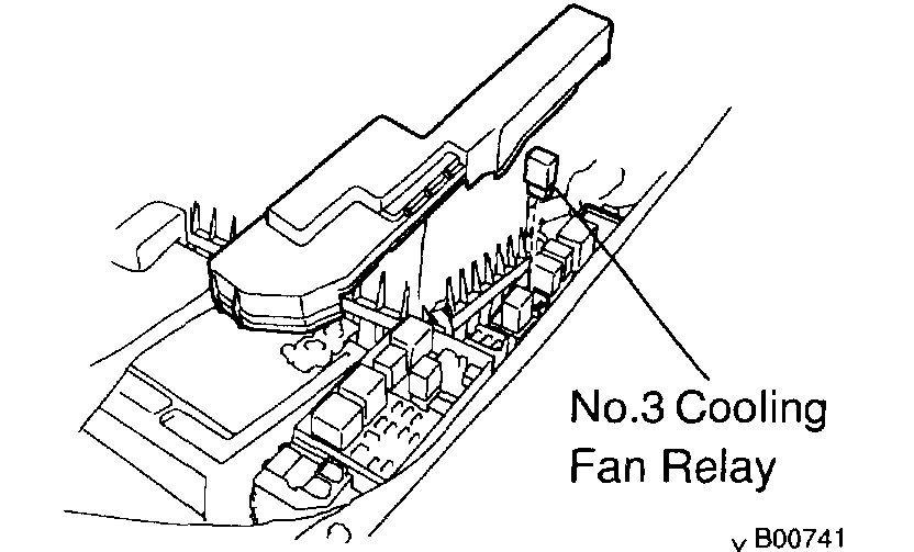

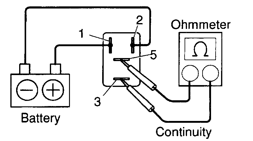

3. INSPECT NO. 3 COOLING FAN RELAY
Picture 9
a. Remove the No. 3 cooling fan relay. (Marking: FAN NO. 3)
pic 10
b. Inspect the No. 3 cooling fan relay continuity.
2. Check that there is no continuity between terminals 3 and 5.
Picture 11
c. Inspect the No. 3 cooling fan relay operation.
2. Using an ohmmeter, check that there is continuity between terminals 3 and 5.
d. Install the No. 3 cooling fan relay.
