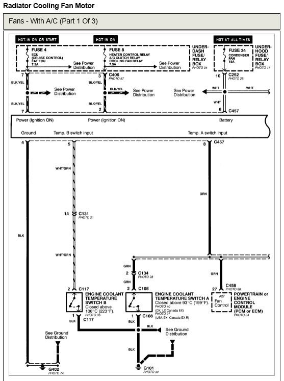

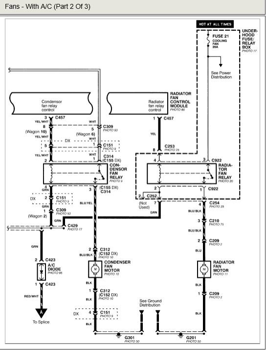

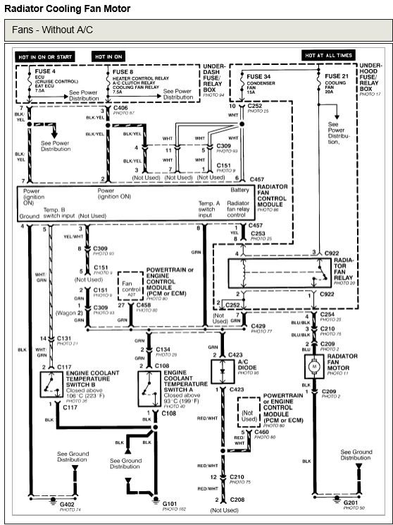

If the coolant is pushing back out of the reservoir, then it sounds to me as though the engine is overheating. Make sure the cooling fan is coming on when the engine gets hot, before it overheats and if not or even before that, check the fuse and if okay, try a new relay.
If you have AC this looks like it has two fans and the second fan should come on as soon as the AC is turned on.
