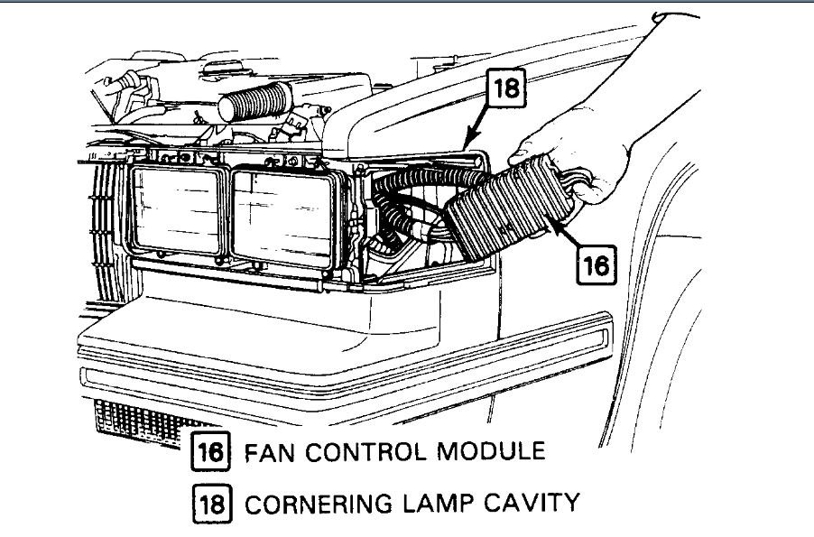

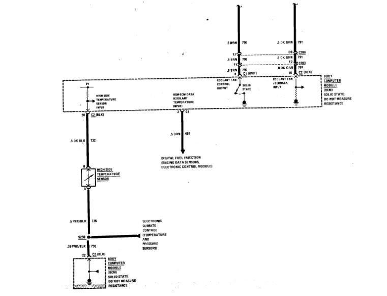

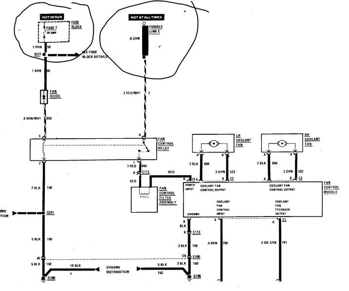

Right cooling fan does not come on and car cuts off when it gets warm while driving.

Did you check the voltage at the one that does not work?
I attached diagrams for you to view. Check the fuse and the fusible link.
If there is no voltage to the motor, the cooling fan module may be the failure as it controls both motors.
