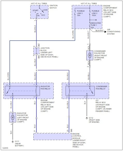

Checked fans they are good. Fuses are good. Relay are good.

I uploaded a diagram for the fans from "Prodemand" (below).
It is very detailed and shows where items are located.
Top right side shows a fuse and fusible links (may have been overlooked).
You can test fuses and either side of fusible links for power with a test light or voltmeter.
This might help refresh how to use them efficiently. These guides are from our "repair guides" located on the top right of our pages.

Thanks for the diagrams I jumped the temperature sensor plugged back up check engine was on so I ran diagnostic on sensor was bad put new one in finally fan came on after thirty minutes idling. I appreciate what you sent me I may have to get some more advice at later date on another vehicle that I will be working on here at my shop thanks again.
