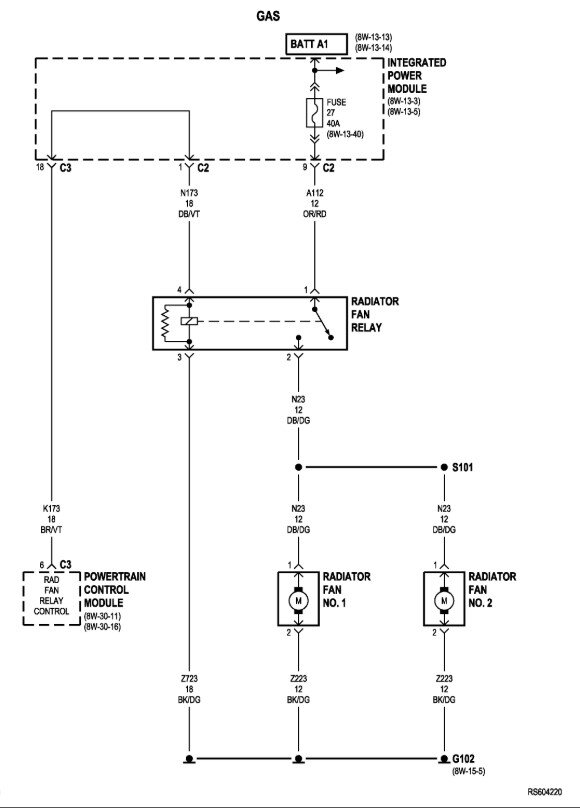

with engine off both fans stay on. i replaced the pcm earlier because the car would not start and that solved it. the car also had a dead battery, am guessing cause of the fans running, so i installed a new battery. do you think its the ect or the fan relay? no codes

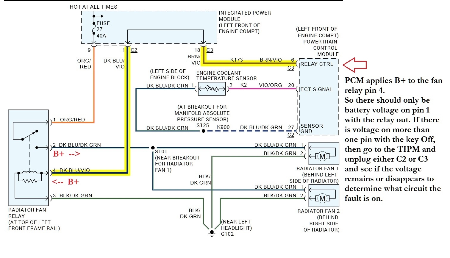

Ok I have a correction, after looking at the wiring diagrams for the relay, this one is power switched, so the PCM applies power to the control side of the relay. Ill post the diagrams to check the control wire for a short to power.

Since this is a power side switched relay, its possible there is corrosion(water intrusion) inside the TIPM feeding power to the control pin keeping the fan on. These TIPMs are a high failure rate. But with the relay out there should only be battery voltage on one pin with the key Off.

The oem wiring shows the same type of circuit.

The relay check is pretty easy, out of the 4 pins on it, 2 of them should read roughly 75 ohms or so and the other 2 should read OL, there shouldnt be any connection between those two pins, if it reads 0 Ohms the relay contacts are stuck closed.
Sep 19, 2025 at 10:13 AM
BHAMDOC1973
  • 2,007 POSTS
A new relay fixed it. Thanks
