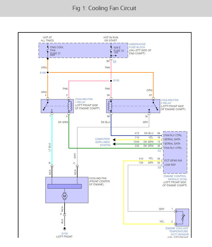

Replaced the fan, both the speeds will run when jumped at their respective relays. There is battery hot and ignition hots at both relays. Has Chevrolet with the PCM supplying the grounds to these? What temperatures are the relays supposed to turn on the relays on?
Aug 15, 2022 at 12:23 AM
  • 55,433 POSTS
The fan should turn on at 230 degrees Fahrenheit. Yes, the PCM supplies the grounds for the relay when it wants to activate the relays. Here is a wiring diagram of the radiator cooling fan relays so you can see how the system works. Also, check the ground at the left front of the engine compartment and the fuses for the system # 37 and 23 in the under-hood fuse panel. Check out the diagrams (below). Please let us know what you find.
Aug 15, 2022 at 5:53 AM
WARREN SHANKS
As I told you I can jump the relays and make both fan speeds work, which tells me the ground is okay. and also, that there is power to both b+ terminals in the relays and both ignition hot terminals in the relays. Has GM had a problem with their PCMs? 230 degrees sounds awfully high. Can I tee in to the PCM grounds and run a switch?
Aug 15, 2022 at 7:10 AM
  • 55,433 POSTS
Sure can, yes, they did have problem with the PCM's turning on the fans, here is how to do the PCM replacement below.

WARREN SHANKS
Thanks for that. Do you think if I were to T in to the PCM ground wires to the relays and add a switch for each speed would turn the check engine light on? Obviously the fans would work but I am concerned about the check engine light and vehicle inspection for my tags? Thanks again for your help!
Aug 16, 2022 at 9:28 PM
  • 55,433 POSTS
I don't think it will trigger a check engine light, but check before you button things up to be safe.
