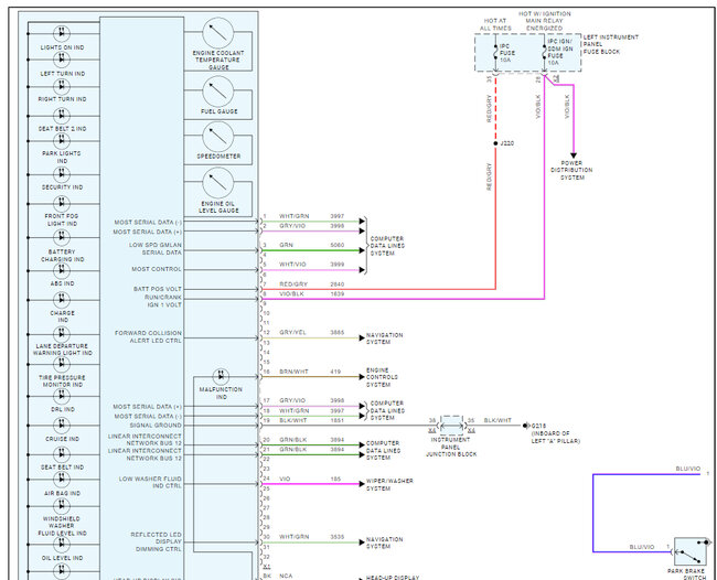

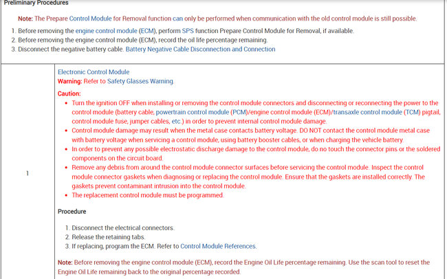

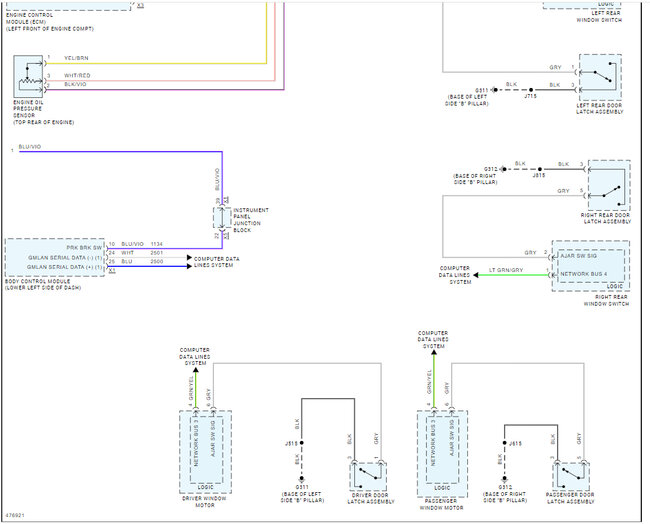

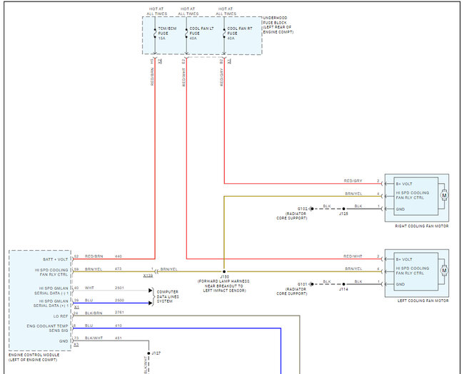

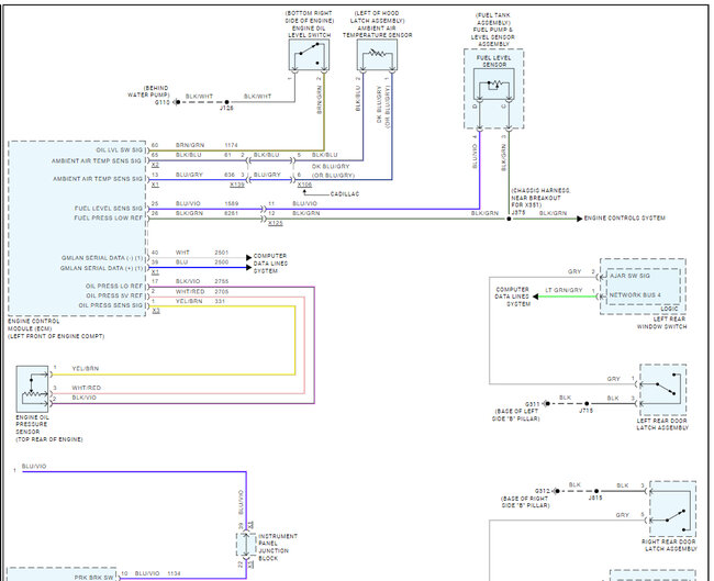

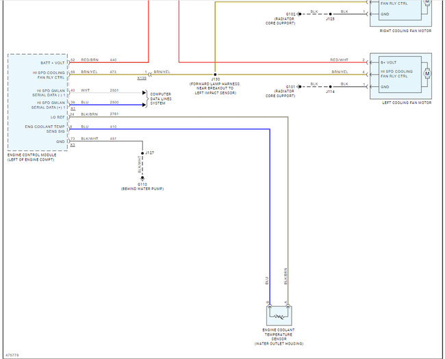

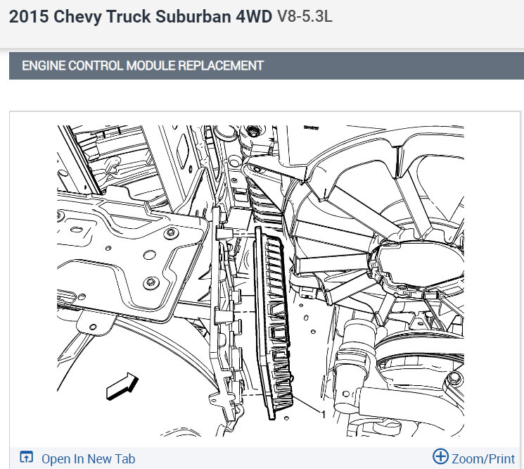

The temperature gauge and cooling fans are controlled by the PCM which if I had to guess is the problem. Here are the wiring diagrams so you can see how the system works. Also, I have included how to change the PCM out which you can get a pre-programmed unit by searching google or eBay. The PCM might just need an update from the dealer to help fix it. Check out the images (below). Please let us know what happens.

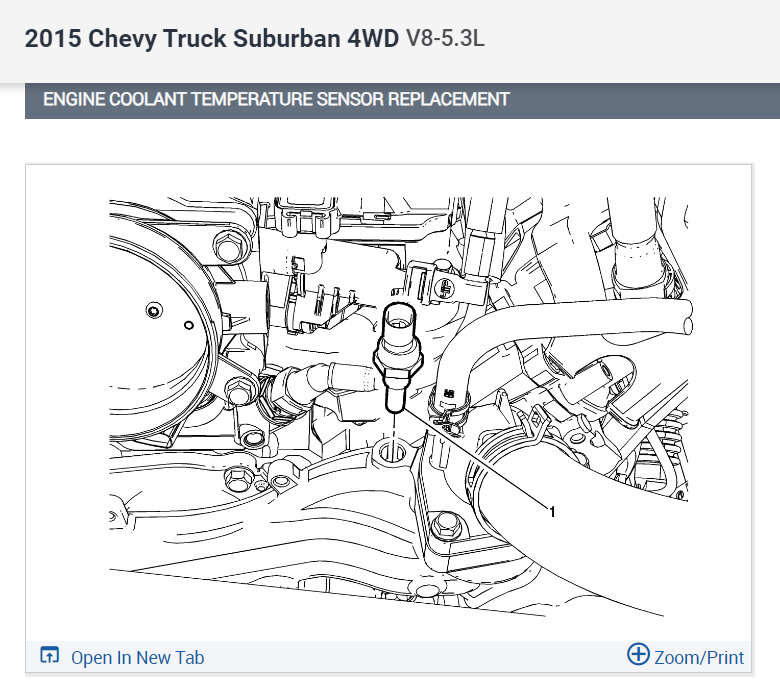

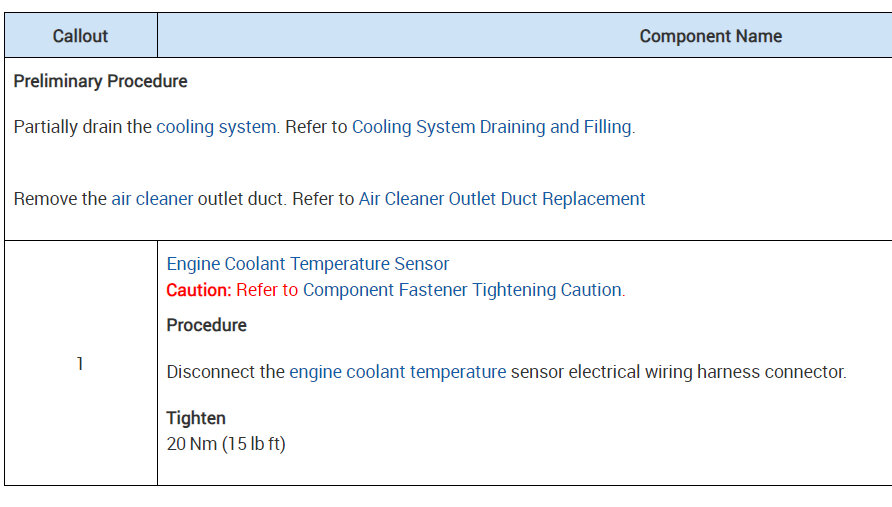

I hear you, if the PCM thinks the engine is cold and it turns the fans on seems strange. We could try the coolant sensor to see if that fixes it, it could be a safety device.

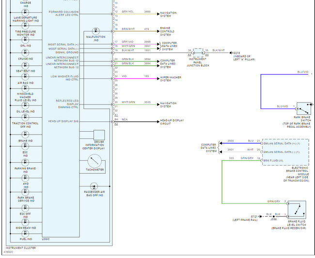

Here is the sensor, also it could be the cluster as well, we might want to try a CAN scan to see if any other codes are stored. Here is the location of the sensor. Check out the images (below). Let us know how it goes.

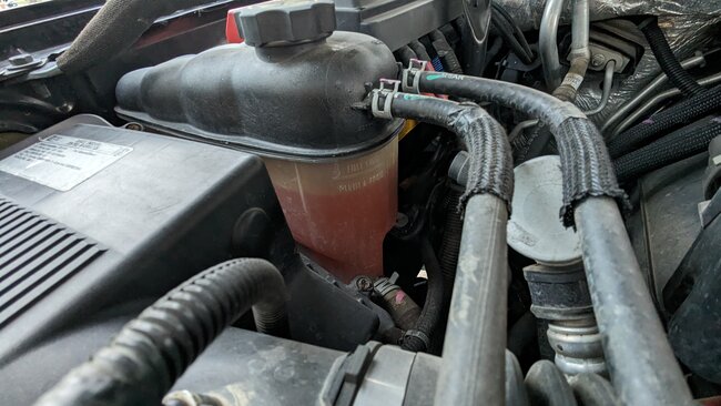

I just checked the coolant level, and it appears to be normal. As soon as I start the vehicle the fans come on. I tried looking at the scan tool I have but didn't see anything on there that would tell me anything about the sensors.

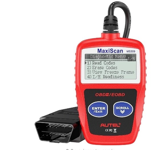

I have the Autel OBD2 Scanner.
Apr 17, 2024 at 10:53 AM
  • 55,214 POSTS
Thanks for the video. Yep, that is not normal. The scanner you have will do engine codes only. You will need to upgrade the scanner to one of the more capable units or have a shop scan it for you. To me it sounds like an update for the PCM could fix it, but we will learn more once the CAN scan has been run.
