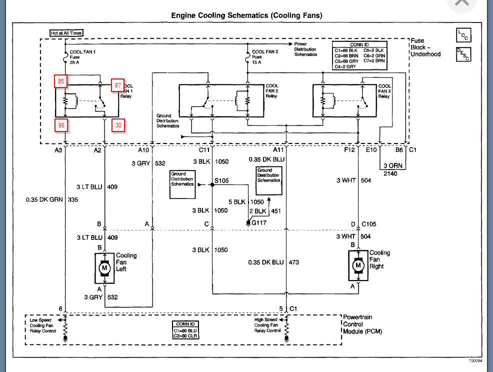

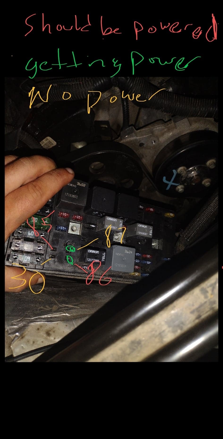

So, I replaced the PCM. Fixed a lot of issues. But ended up going back to square one. Cooling fans won't come on. Not even for ac this time. So, I broke the trustee multi meter out and started rechecking wiring. Bringing me back here today. Now, the cooling fan 1 relay is not getting properly powered. According to my relay. Post 85 and 86 should have 12 volts power, and post 30 and 87 should have no power until tripped. Well, 86 has 12vs 85 has no volts 87 has 12 volts. And 30 has no volts.

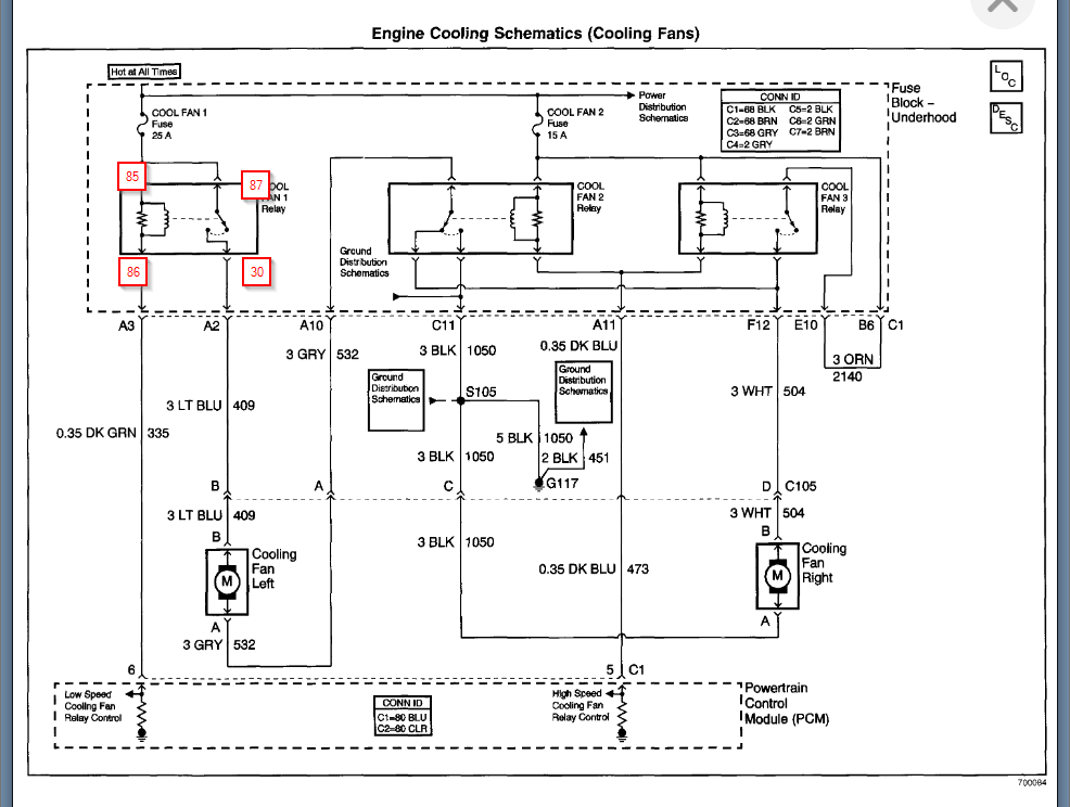

So, I'm assuming 85 and 87 have crossed somewhere and that I'm needing a wiring diagram.

here's a picture of what's going on.

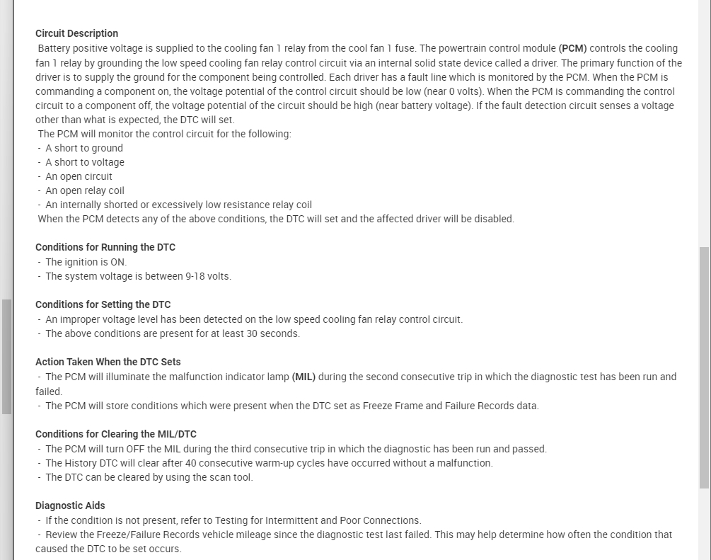

okay. so, i already know it's a wiring issue. but it is now throwing codes for the fan relay 1 and fan relay 2.
Codes po480 and po481.

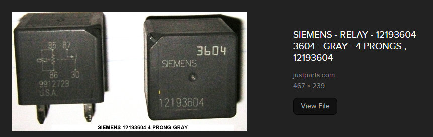

You may be correct that this is a wiring issue, but we need to start with making sure you are getting the correct voltage.

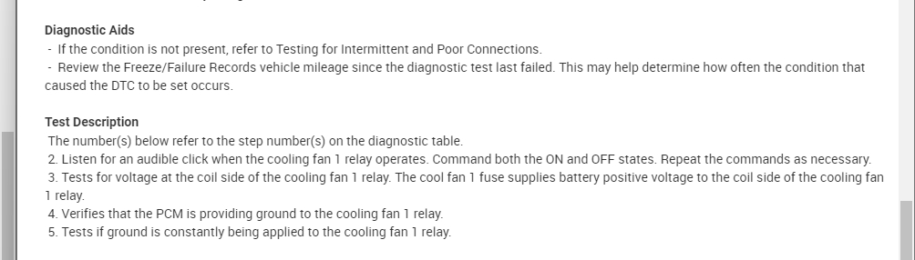

I am attaching the picture of the relay below. This will have the diagram of the layout on the side of it so let's make sure we are getting the proper voltage on these pins.
You should have voltage on pin 85 and 87 at all times. 86 is the ground from the PCM so if you are checking for the voltage on 86 you need to remove the relay and supply voltage and use 86 as the ground.
If the meter says 12 volts, then the PCM is grounding the relay to command it on.
As for 30, that is only going to have voltage when the relay is grounded and it closes. To check the operation of the fan, jump power to 30 from 85 or 87. The fan should come on.

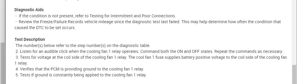

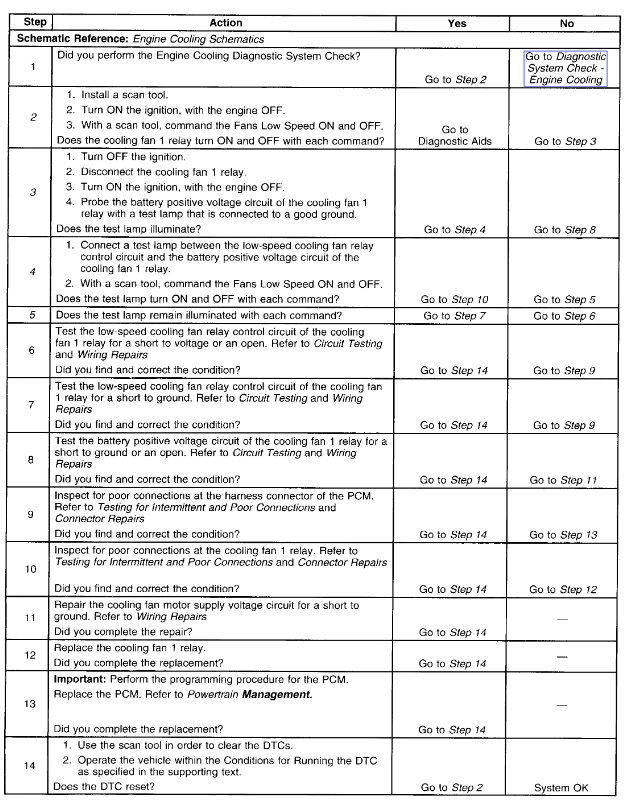

However, I am attaching the testing as well for these codes because that will help walk through this testing.
