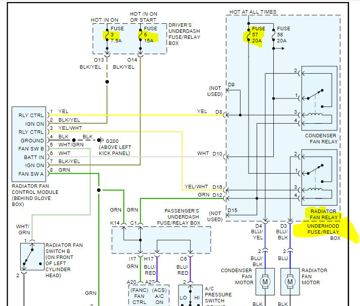

Cooling fans not working on auto?
2000 HONDA ACCORD
190,000 MILES • 3.0L • 6 CYL • 2WD • AUTOMATIC
ZMAN51
Have checked all fuses and relays and replaced the coolant sensor by the thermostat. Fans only work when the A/C is on.
Jul 21, 2024 at 2:31 AM
  • 110,244 POSTS
If the engine is cool, only one fan should turn on with the A/C. It would be the condenser fan. The other fan, the radiator cooling fan, operates when a specific coolant temperature is reached. Is the vehicle overheating? Let me know.

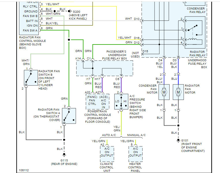

Next, I attached the wiring schematic for the cooling fans circuits. There are four fuses I need checked. In addition to just checking the fuse, confirm there is power to and from the fuse. See pics 1 and 2 below.
If the fuses are good and have power, locate the radiator fan relay in the under-hood fuse box and switch it with a different one having the same part number. See if that changes things.
Last, if the engine is overheating and the fan still doesn't turn on, disconnect the electrical connector. Using a test light or multimeter, see if there is power present at the blue wire.

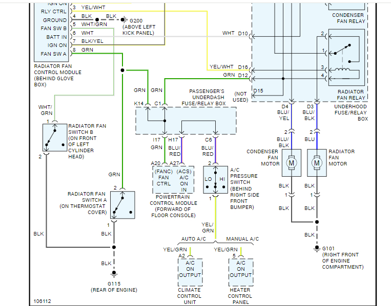

See pics below. Note: I had to cut the pic in half to make it readable. I did overlap the two so you can follow from one to the next.
