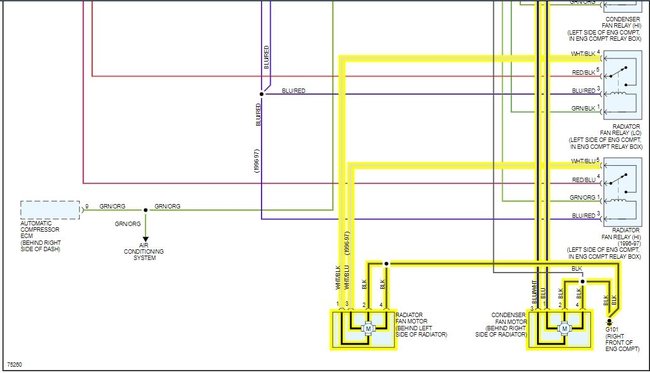

Driver's side cooling fan is burned out will that keep the passenger side fan from working. The passenger side only works if I put jumpers on it. Car runs hot when in idle.
Jan 29, 2021 at 7:58 AM
Good evening,

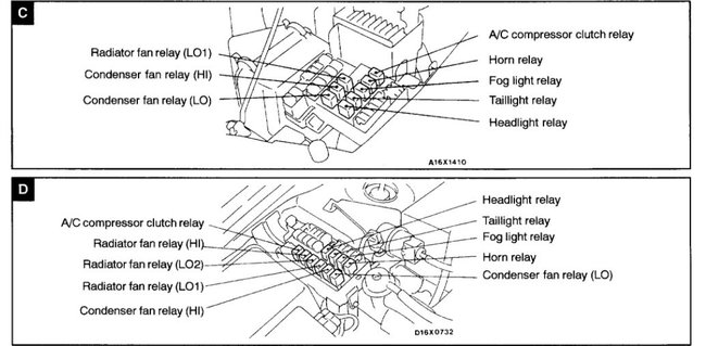

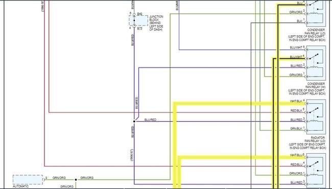

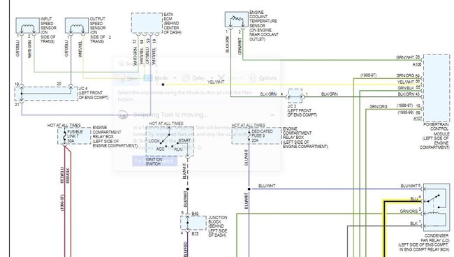

I attached a wiring diagram of the system for you. Did you verify power to the cooling fan for the A/C when you turn on the A/C system?

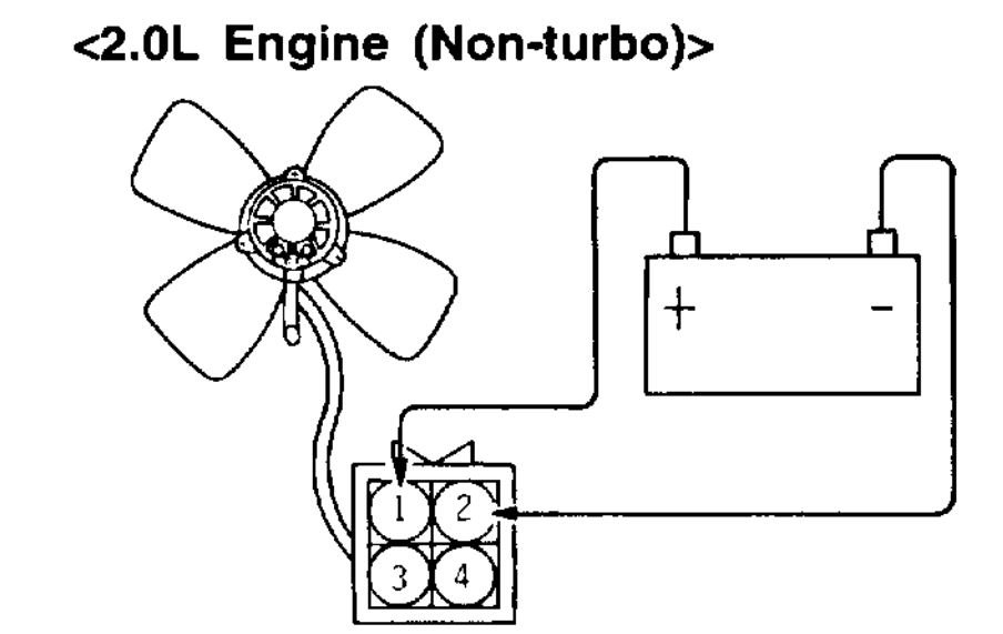

You need to test the relays to see if they are sending current to the fans for operation.
https://www.2carpros.com/articles/how-an-electric-cooling-fan-works
https://www.2carpros.com/articles/replace-electric-fan-motor
