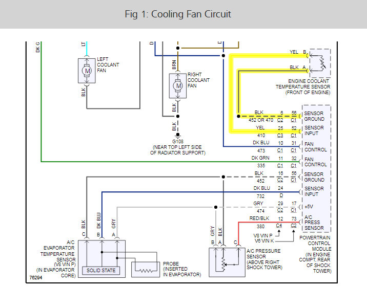

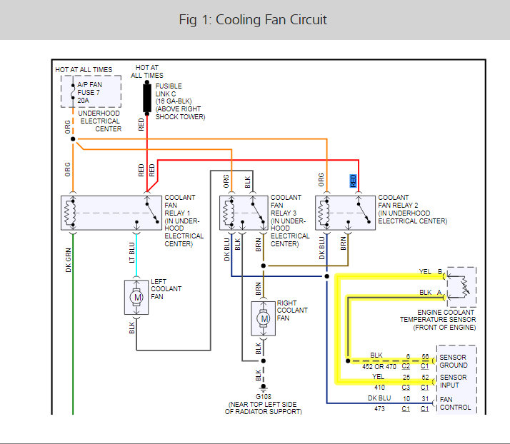

Now the cooling fan are not working and I unplugged the temperature sensor and they work properly. And don't overheat but when I plug it in the fans go off and overheats. water pump new, thermostat new, temperature sensor is new. What could be the problem?
Aug 30, 2019 at 12:00 PM
SCGRANTURISMO
  • 4,897 POSTS
I would replace the Engine Coolant Temperature sensor (ECT). In the diagrams down below I have included a wiring diagram of your vehicle's cooling fan circuit. Both of the wires that come from the ECT go directly to the PCM. so there is either a short in the ECT or the PCM has gone bad, but I'm pretty sure it's a bad ECT. Please get back to us with what you are able to find out.
Thanks,
Alex
