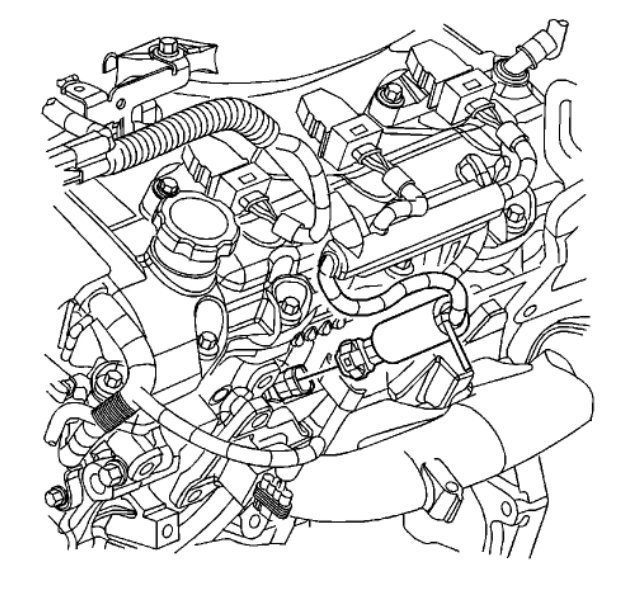

Thanks for reply Ken...I am a Honda Master Technician, this 05 Buick Rendezous V6 is a freind who said my daughters car is overheating, can you install this thermostat and coolant he thought would fix her problem. The complaint/issue their having is the Temp Gauge on the dash is reading 1/4 or so...but less than half way nice and steady....then at times it goes quickly up to 3/4!...then back to 1/4 again. so...
after checking a few things I dont think the car is overheating at all, with a scanner reading engine coolant temp...i see that when this episode occurs temp is around 220...also when the low fans come on...which i now learned is normal on this car...and again after fans are running for like 45 seconds the gauge goes from 3/4 right back to 1/4!
So now im thinking there is a problem with the switch that sends the signal/temp reading to the gauge!!
or the gauge or that circuit.......another reason is a GM Tech said that on this model at normal temp..the gauge should be at 1/2 right in the middle!! maybe resistance no good in that switch!!!
what do you think?
Oct 23, 2017 at 10:25 AM
  • 55,399 POSTS

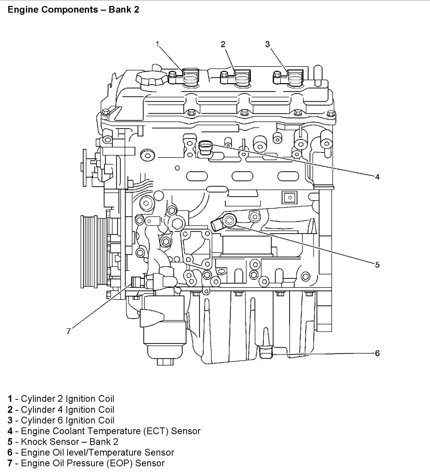

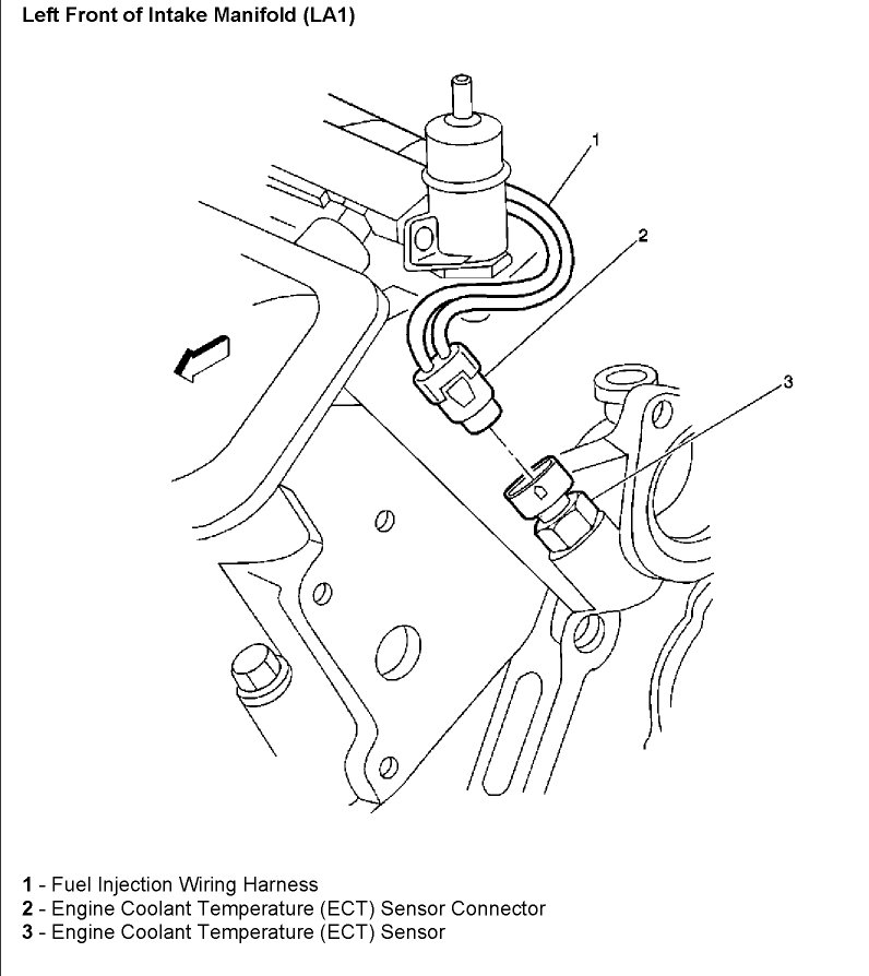

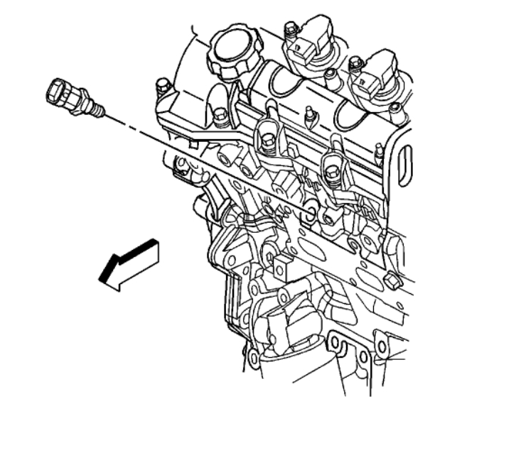

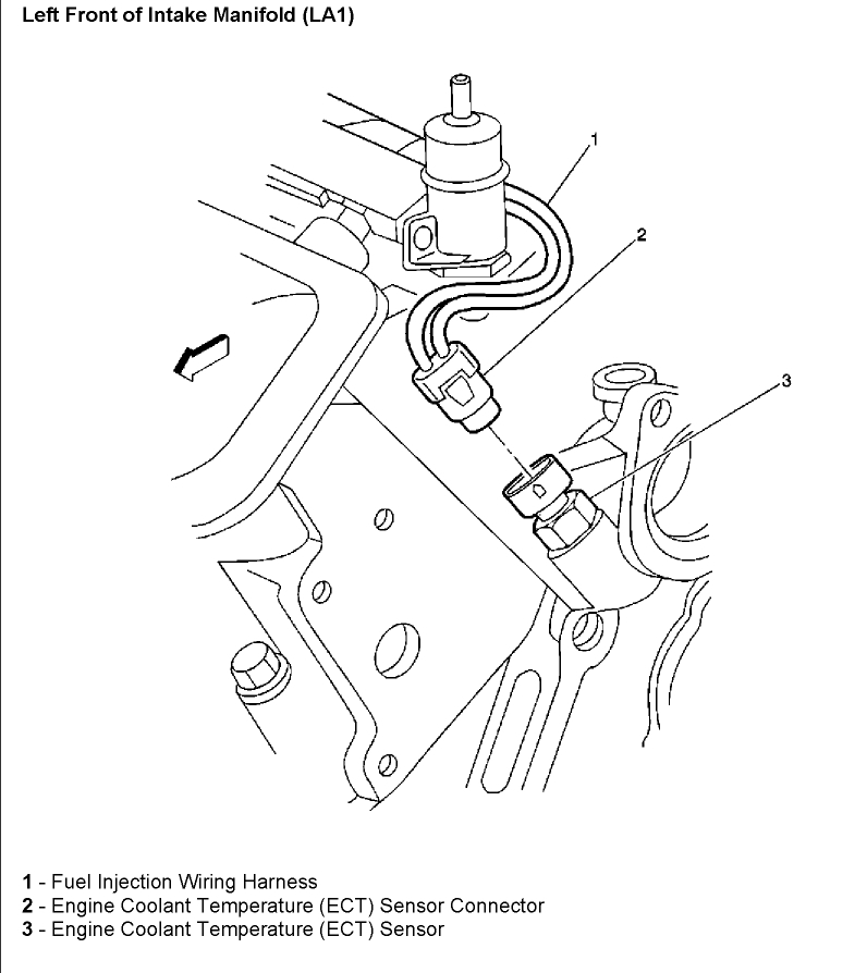

Yep. it sounds like the coolant temperature sender is going out. There is just one for the gauge and the computer. Here is a guide that will help you see what you are in for when doing the job.
https://www.2carpros.com/articles/coolant-temperature-sensor-cts-replacement
Here is what it will be like on your car with the location (below)
