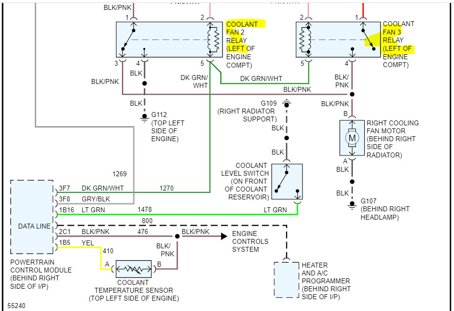

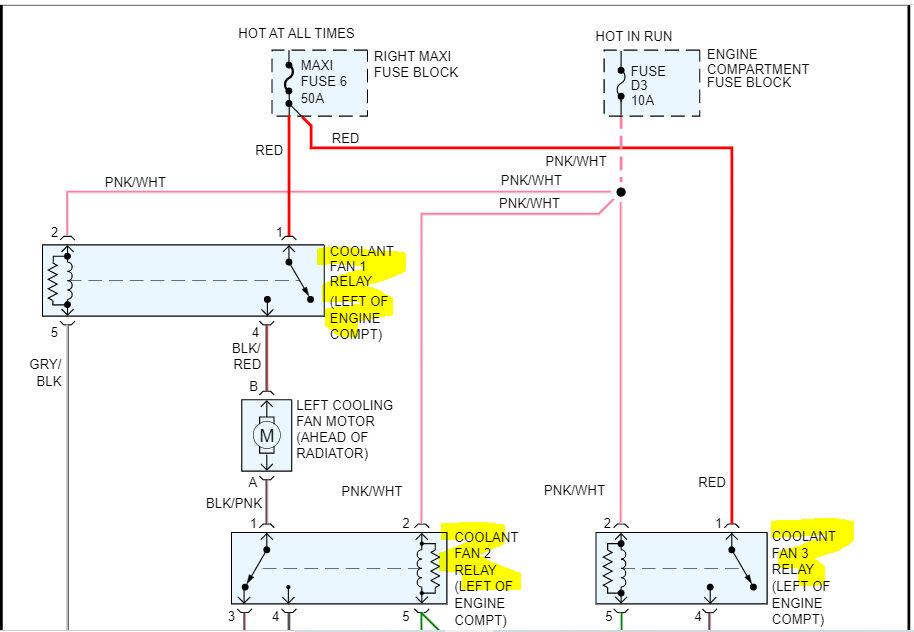

Can somebody give me a diagram of the color wires for the cooling fan sensor please?

I mean relay sorry..

No problem whatsoever. LOL There are three relays that control the radiator cooling fan.
If you look below, I provided the entire wiring schematic for the radiator cooling fans. Take a look through them and let me know if they help or if you have other questions.
Take care and Merry Christmas,
joe
See pics below. Note: The schematic was only one page long. I cut it in half to make it readable for you. I overlapped the two pics so you can follow from one to the next.
