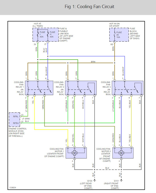

I have replaced the coolant sensor and thermostat moved the radiator fan relays replaced fuses. Just did the common crank sensor replacement issue.
also I have codes p1126, P1140 and p1130 up. And I still cannot get the radiator fans to come on unless the AC is on. Yes the car goes up to the hot line before anyone asks. Note: I said fans both fans are working when AC is on just not when AC is off.

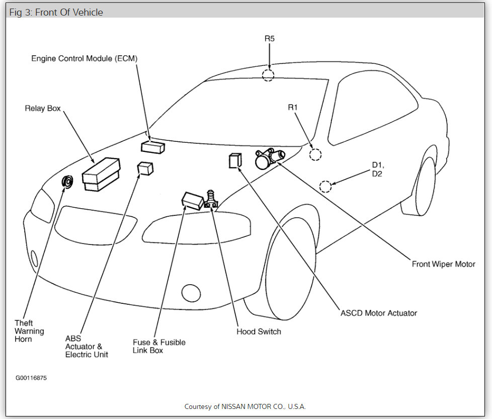

Those codes are all over the map and with the fan control issue it sounds like the PCM is bad. Here is the fan wiring diagrams so you can see how it works which you can see its not that complicated. I would try plugging in a used PCM here is the location as well.

Yes, the used PCM should solve all of that. The fact that the fan driver inside the PCM is bad the computer is having a hard time. Can you remove the electrical connectors and check for corrosion please?
