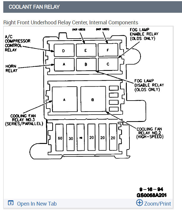

The fuse is good and i will double check the relays to make sure they aren't bad.

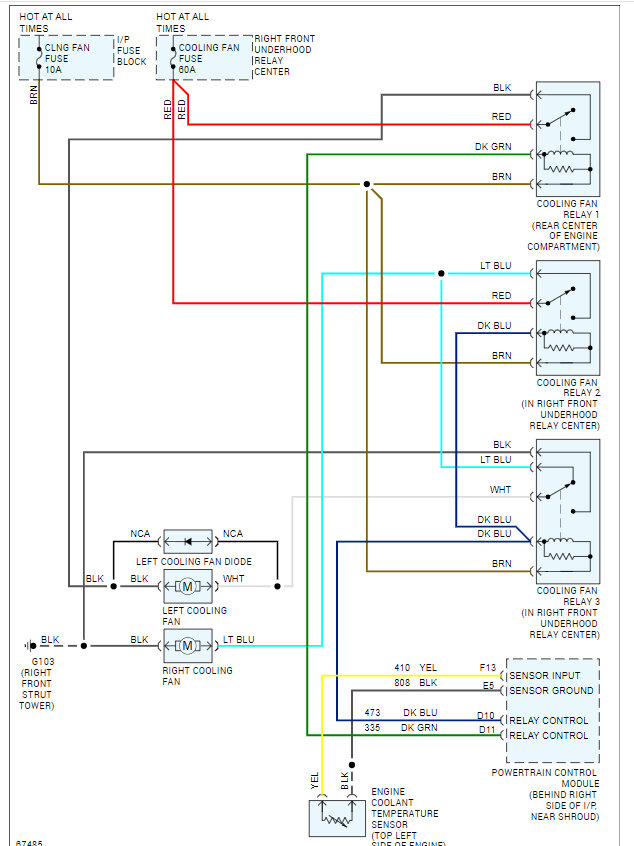

Can you provide a diagram of that circuit and how it works please?
Also, any suggestions will help as to how to proceed with troubleshooting. The car sat for a long time, and I've had to do quite a bit to get it ready.

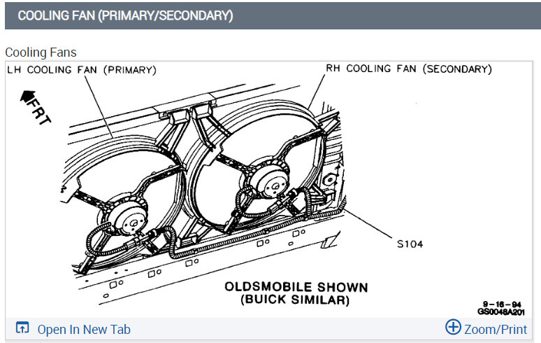

The fans are controlled by the PCM, can I ask you if you turn the A/C system on do the fan kick on? Here is the fan relay location and the cooling fan wiring diagrams so you can check out how the system works. I have also seen the cooling fan motor itself go out which is common. Please go over these guides to help you fix it.
Here is how to change the radiator motor out which once you have it out you can bench test it. The fan motor on the left is the main motor while the right-hand fan motor is the auxiliary fan. Check out the images (below). Please upload pictures or videos in your response to any problems so we can see what to help you with.

Okay, so when the car is on, i don't ever see the fans come on when they're supposed to, and right now i have issues with probably the climate control, because the vents don't blow so i don't have any ventilation in the car. But when i turn the car off after it's above temperature, and then turn the key to on, the low-speed fans will run until it cools down and then they turn off. But the high-speed fans never turn on, and i couldn't see any difference from trying the AC but, like i said, the A/C isn't functional.
I was reading somewhere that if the climate control isn't working it can cause the high speed fans to stop working as well, is that true?
I replaced the coolant temperature sensor.
Next i will test the fans themselves with 12 volt just to make sure they run at high speed, but if they're running at low speed then i imagine they should run at high speed as well, from what i can see these fans run parallel on low speed so they each get 6 volts for low speed.

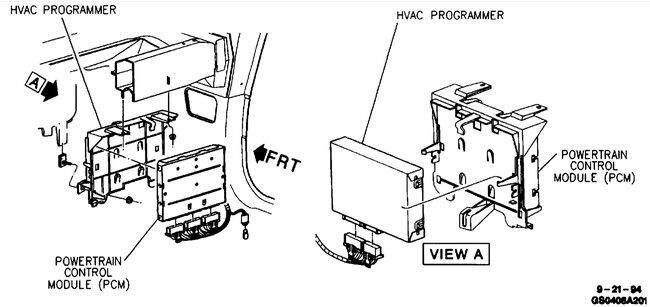

Do you mind sending me a picture of the climate control board and location, i think i need to replace that, unless it's the blower motor, but i think it's probably the climate control board.

Okay, yes, the fans will not work correctly without the climate control working. The reason I asked if the fan worked with the A/C system is because the fans will run with the A/C on which are controlled through the PCM. Also, recheck the system fuses to make sure they have power, you can tell which fuses are used by checking the wiring diagrams above.

I'm assuming it's the control board under the glove box. But I'm just not sure exactly what it is, what it looks like, etc.
I found a thread of somebody having the same issues and they replaced a blower control module and that fixed the problem for them.
Is that what i need to be looking at? Is it called an HVAC programmer or blower control module or are those the same thing?
Can you please send me some pictures and diagrams of what to check or test?
Please give me some details as to how to proceed with troubleshooting it.
May 12, 2024 at 1:10 AM
  • 55,743 POSTS
Yep, the HVAC programmers go out in these cars, they are difficult to check without the correct equipment so you might need to send it into a rebuilder to have it checked. Here is the location so you can check it out. Check out the images (below). Let us know how it goes.

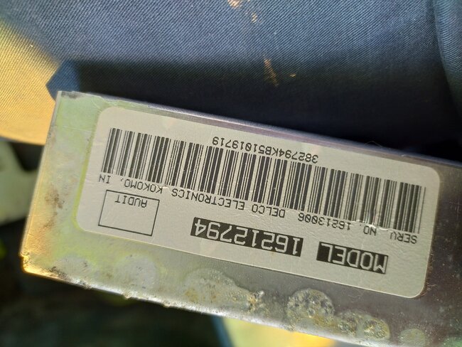

Okay, so i went ahead and ordered an HVAC Programmer from Swan Auto. It's a used one, but that's fine. I installed it and now i have ventilation inside the car. When i turned the air on i still didn't see anything from the cooling fans in the engine bay.

Well, i bought some Freon and was going to check it, but the vents weren't blowing again. I went under the hood and tapped on the fuse box in the front passenger engine bay near the headlight. Then the fans came on, so i was really happy about that. Then i got to thinking maybe inside the cab the blower motor or control module is going out, so i turned on the air, reached under and tapped on the blower motor and it turned on too. So looks like i need to double check all connections in the fuse box, and the relays. And it looks like I'm the near future i may need to replace the blower motor and module. When i get the chance I'll double check power at the blower motor to make sure the voltage increases with the fan speed like it should etc. Then i can replace whatever i need to there as I'm able. Thank you for your help and guidance in the process.
