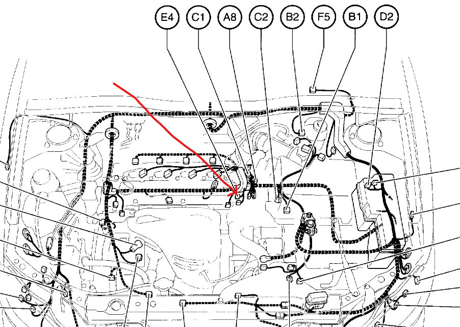

The cooling fans only come on when the temperature sensor is unplugged?
2003 TOYOTA CAMRY
170,000 MILES • 2.4L • 4 CYL • 2WD • AUTOMATIC
BADFUSE459
Jul 6, 2023 at 11:59 AM
  • 55,456 POSTS
This happens when the engine coolant sensor needs to be replaced. Here is the location so you can swap it out. Also, here is a generic guide to help you step by step with instructions in the diagrams below to show you how on your car.
