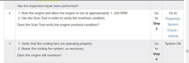

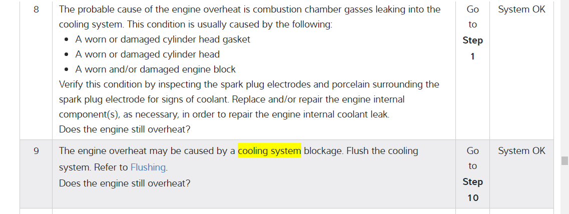

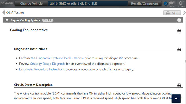

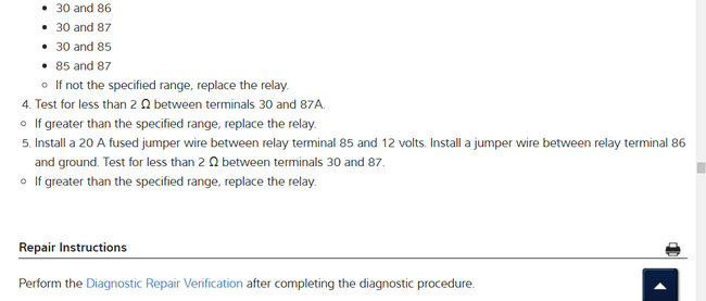

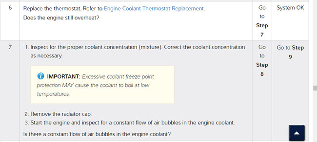

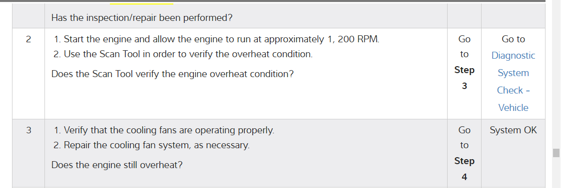

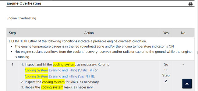

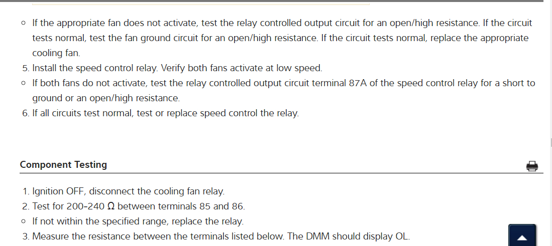

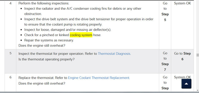

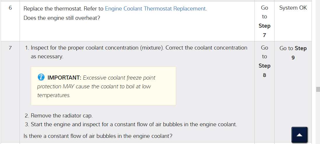

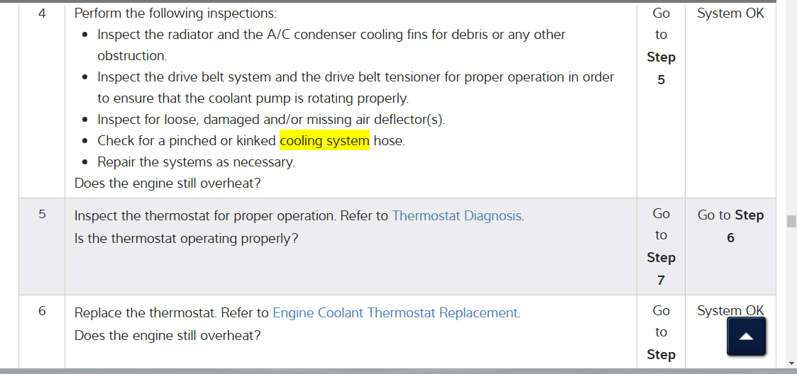

Fans that cool engine are not coming on and neither is AC. Motor runs hot at stop lights.
May 8, 2019 at 3:48 AM
SCGRANTURISMO
  • 4,897 POSTS

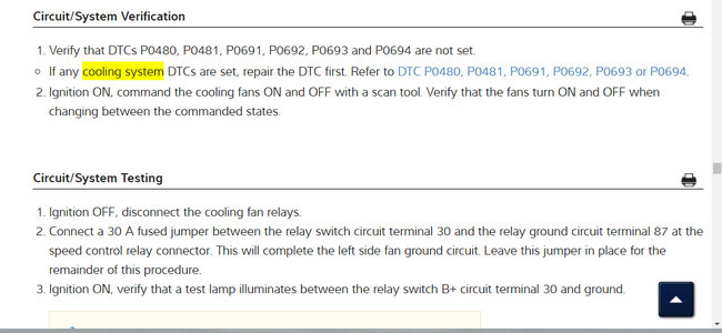

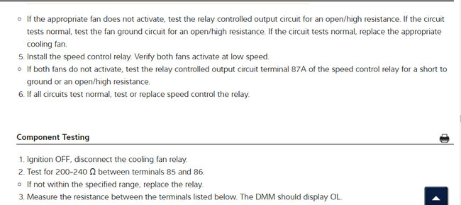

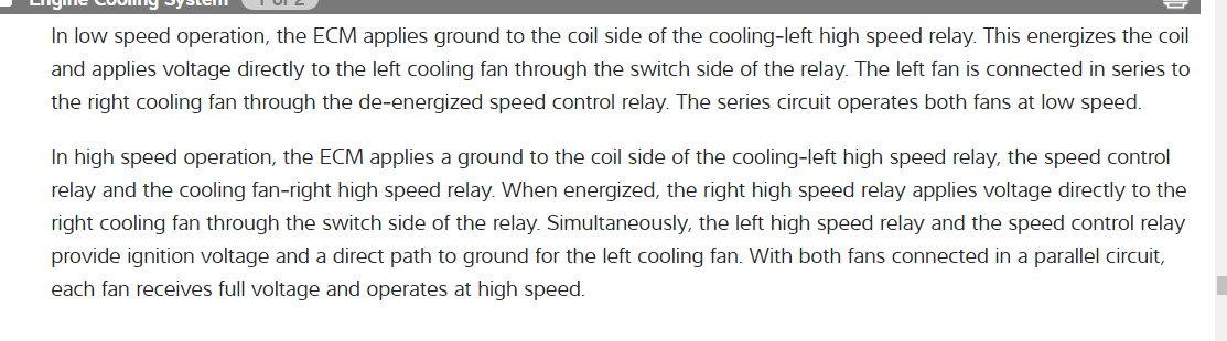

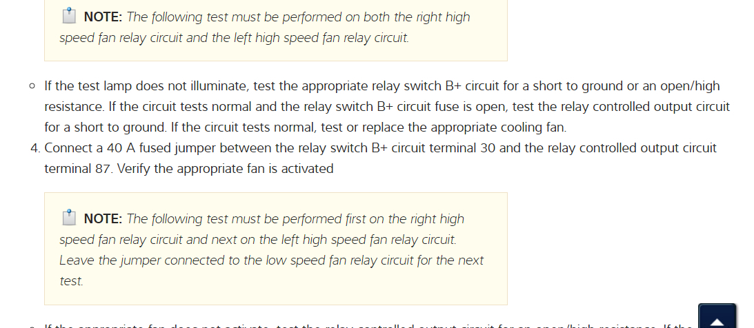

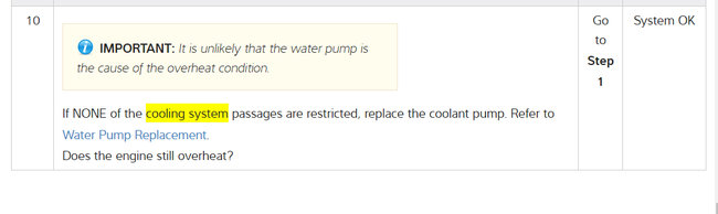

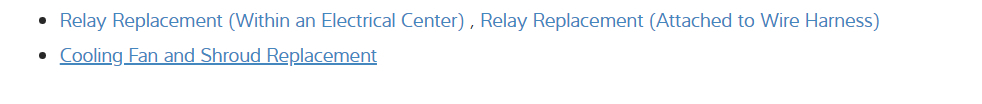

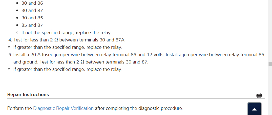

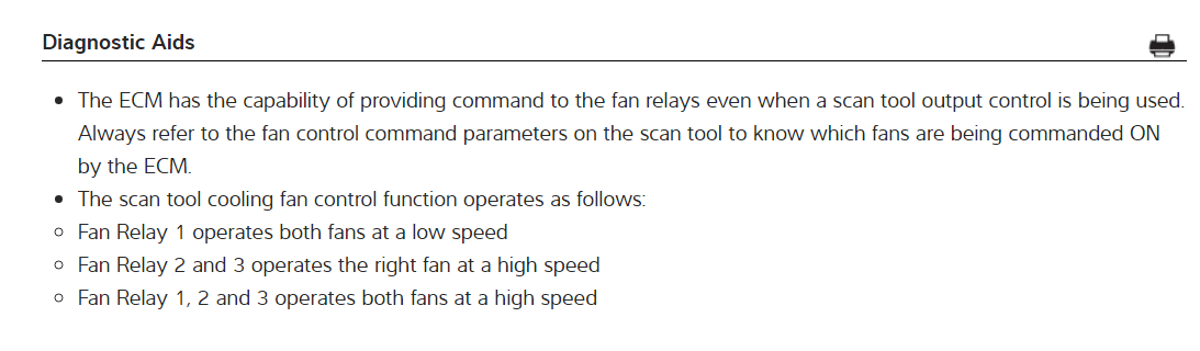

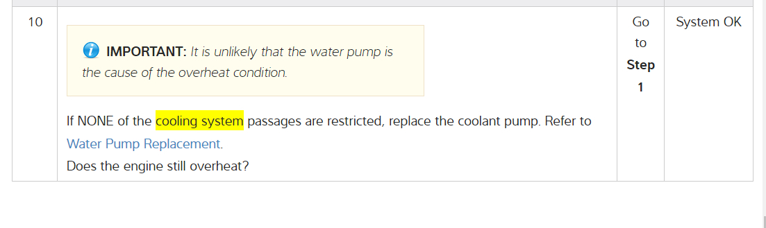

In the diagrams down below I have included the factory GMC diagnostic troubleshooting guide for your vehicle's cooling fans not operating. Please go through this guide and get back to us with what you are able to find out.
Thanks,
Alex
