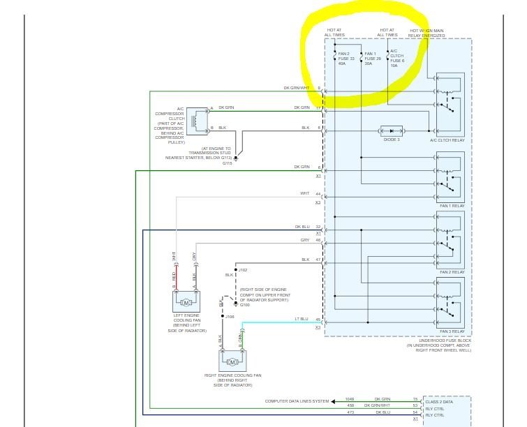

New fans, comes as AC and radiator fans. checked relays. when ground check relay fans come on high speed. just replaced transmission new.
Apr 27, 2019 at 7:17 AM
Good afternoon,

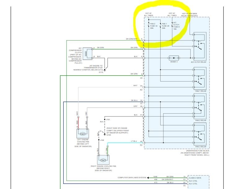

Try this. Remove the connector for the cooling fans. Do this while the engine is running and see if the fan kicks on.
Check the fuses I circled in the diagram I attached for power as well.
Apr 27, 2019 at 9:42 AM
TED FINLEY
  • 10 POSTS
Checking now. think I checked this relay, but will check again. thanks
Apr 27, 2019 at 1:52 PM
Sounds good. Keep us updated.
Apr 27, 2019 at 1:58 PM
TED FINLEY
  • 10 POSTS
checked fuse, checked relay okay.
Apr 27, 2019 at 6:37 PM
Did you do what I suggested with the sensor connector?
Apr 27, 2019 at 7:04 PM
TED FINLEY
  • 10 POSTS
Yes.
