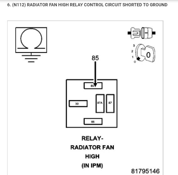

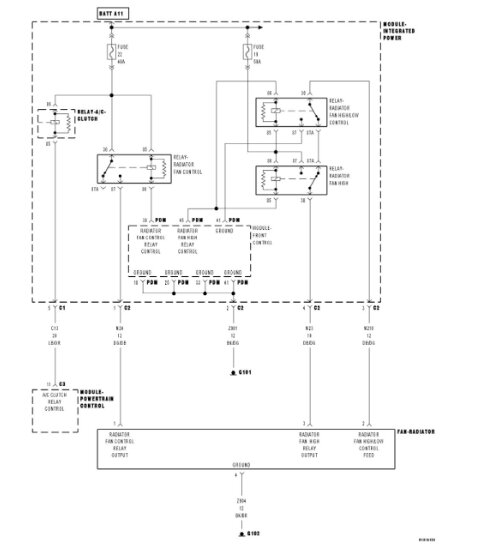

Code Po481, Cooling fans not working properly?
2007 CHRYSLER 300
226,000 MILES • 3.5L • V6 • 2WD • AUTOMATIC
JEFFNEEDSYOU

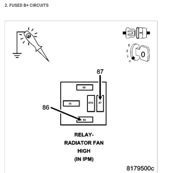

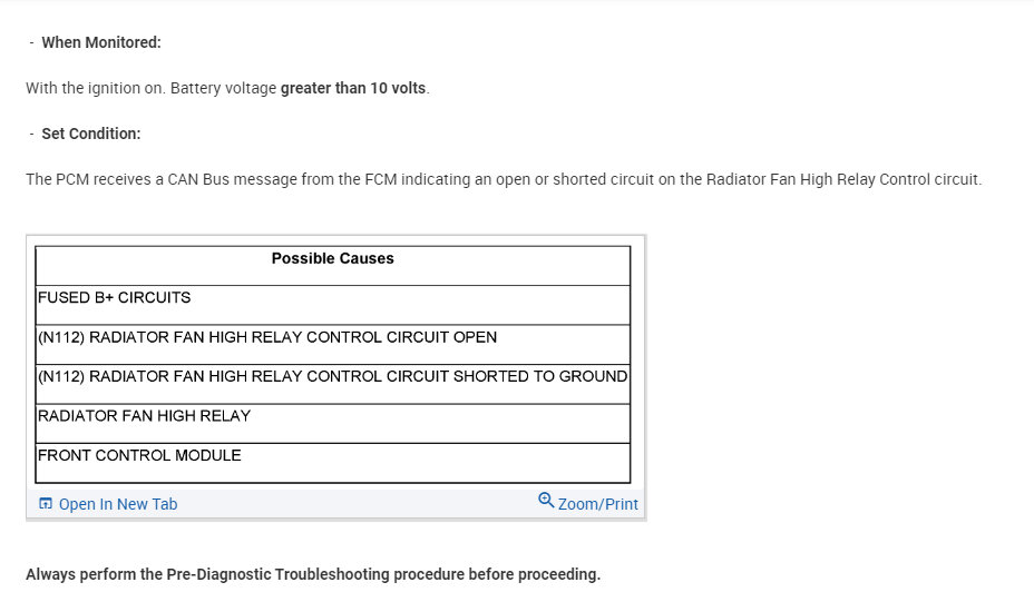

Po481 fans run but won't cycle to high and it's overheating.
Nov 1, 2022 at 3:56 PM
  • 110,240 POSTS

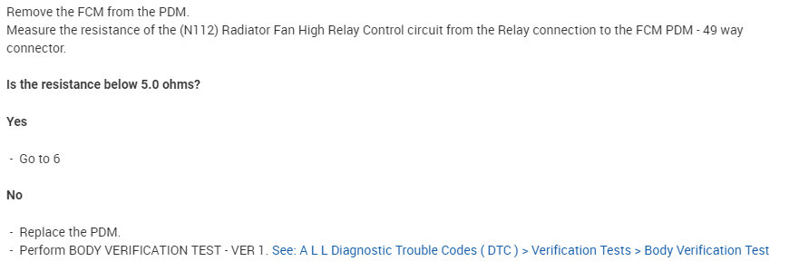

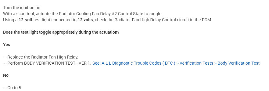

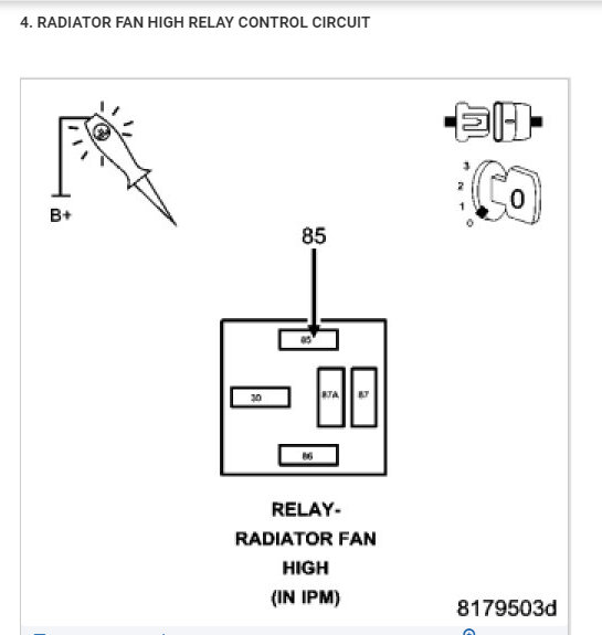

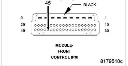

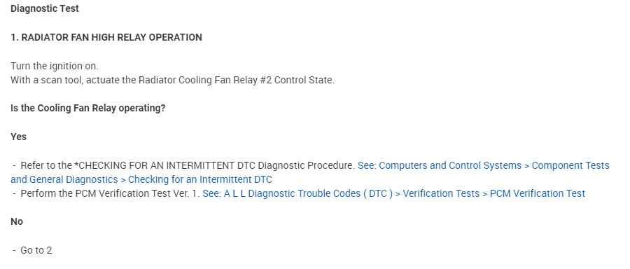

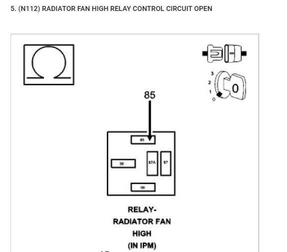

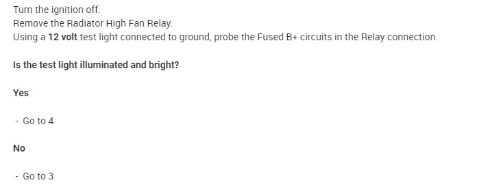

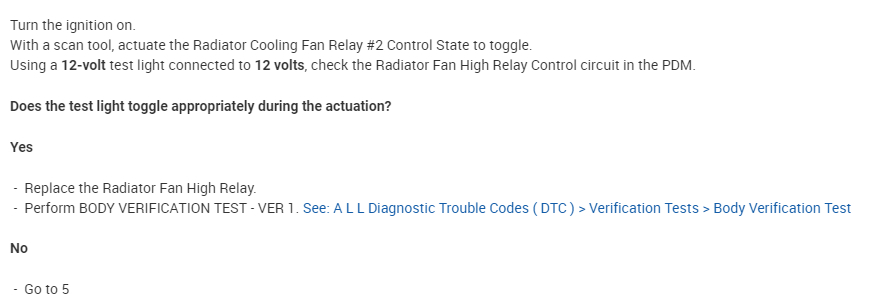

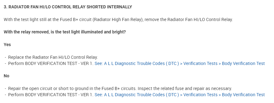

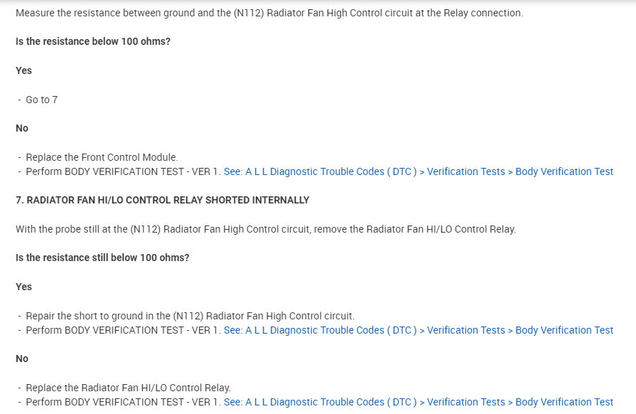

This could be the result of a few different things. It's likely an open circuit in the cooling fan high relay circuit.
If you look below, I provided the diagnostics specific to your vehicle and the code you provided. Take a look through them and let me know if you are comfortable performing them.
Let me know,
