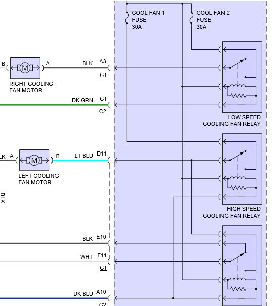

have seen as high as 215* on digital info ctr. cooling fans don't come on , fans run freely with 12v jumped @ u/h fuse & relay ctr, relays check good n I don't just mean they click and all related fuses that I can find (this car has 3 fuse boxes) r good. I've been advised that fans should come on when the a/c or def is turned on , they do not...I just drove this car on a 300mi.trip on a 60*day n temp never went over 192*,now its 20*outside n temp shoots up over 210/212 when sitting still,, soon as you move it goes back down to 190/195

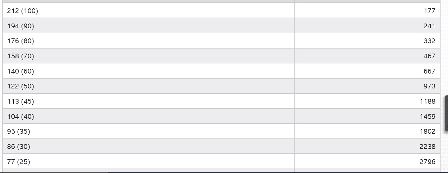

210 is about normal on these cars. all relays for this are under hood there are 3 check parallel relay as well check ect sensor for ohms.

re:cooling fans,98 park ave. if a/c refrig pressure is low would that cause a/c clutch to not engage which would result in no call for cooling fans when def or a/c is on ? could be i'm jumping the gun on normal operation of fans for cooling when def or a/c isn't on ,...lol.. i tend to get nervous when i see temps up around the boiling point . many thanks

don't worry about temps at boiling point.system is pressurized so it takes to about 260 or so bfore it boils. if a/c is low is probably the reason the fan doesn''t come on
