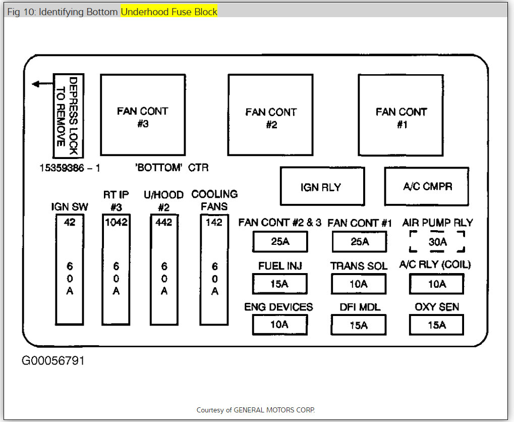

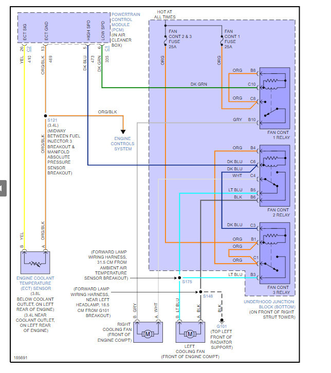

I recently replaced the cooling fans and the coolant temperature sensor. I already tested the fans by jumping them off to the battery and they work. What could be the issue?
Dec 14, 2022 at 12:50 PM
  • 55,746 POSTS
We need to check for power at the fuse (fan cont1 and fan cont2 and 3). here is a guide to help and I have included the fan wiring diagrams so you can see how the system works with the fuse location as well.
