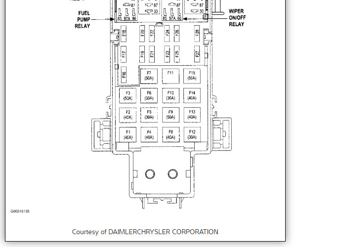

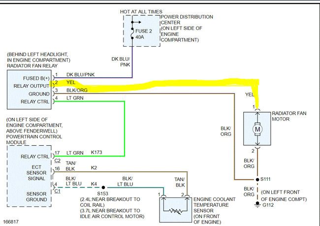

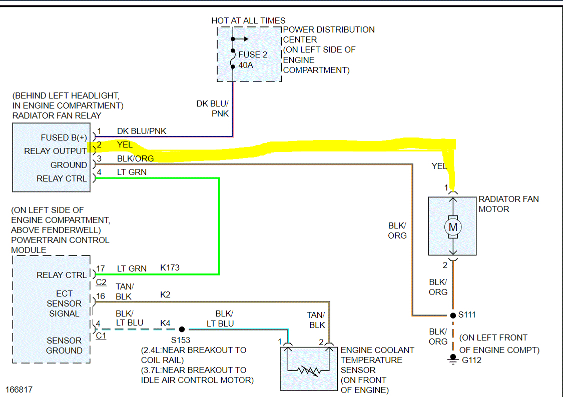

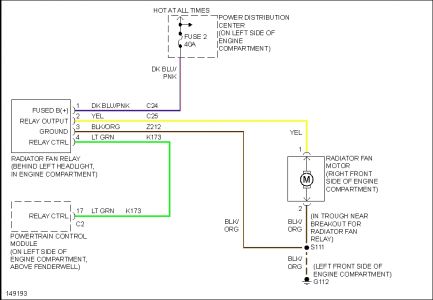

This is one you will need to work backwards with. First, start at the fan. There should be two wires to it. The yellow wire is the power supply. Check it for continuity between the motor and the relay. Also, confirm there is power to the relay via fuse 2 (40 amp). I highlighted the wire I am referring to.
The black wire with an orange tracer is ground. Check for continuity to ground there as well. Make sure to move things around to see if it is a bad connection.
Let me know what you find.

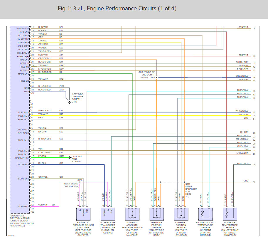

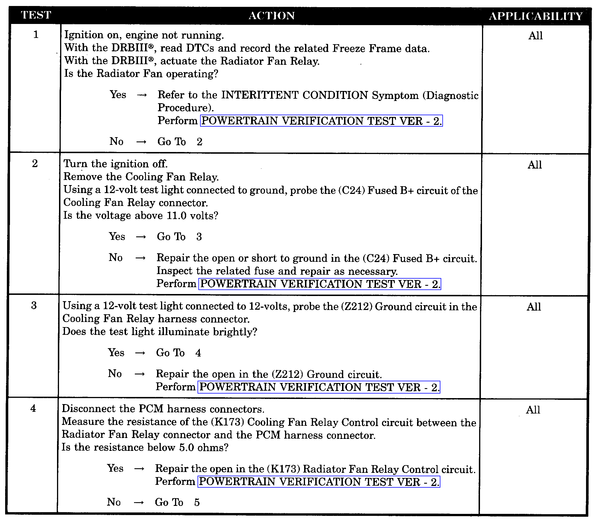

Okay, that is a good thing. Now we need to go through the diagnostics to determine the break down. The only other thing you could check easily is if there is a pulse signal between the power-train control module (PCM) and the relay. If there is, then we have a wiring issue at the relay. The only way I know to check for that pulse signal is via a live data scan tool.
Are you certain nothing was damaged at the relay when you changed it's location? Does the fan turn on if the A/C is turned on? Also, the fan will not be actuated until 210° F, is it reaching that when you checked it?

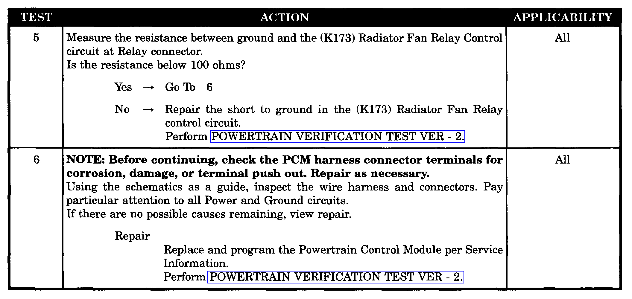

If you look at the two pics below, they are the flow chart for diagnosing this code.
Here is a list of possible causes:
SYMPTOM
P1491-COOLING FAN RELAY CONTROL CIRCUIT
POSSIBLE CAUSES
- Radiator fan relay operation
- (C24) fused B+ output circuit
- (Z212) ground circuit
- (K173) radiator fan relay control circuit open
- (K173) radiator fan relay control circuit shorted to ground
- PCM
_____________________________________
If you notice in the possible causes, you have already replaced the relay, we know there is power to the relay, we know the relay ground is present, so now we need to determine if the control circuit is shorted to ground or if the signal between the relay and fan motor is open (broken).
Let me know if you are comfortable checking the things listed below. If you have questions, let me know that as well.

02 jeep liberty fan will not kick in. Fan works when jumped to 12v source so fan is good. It all started when 4 pin wiring harness that connects to relay had burnt up. Looks like the harness connector was arcing @ the relay connection. I replaced harness with kit from chrysler... didn't fix the problem. Replaced relay thinkin it could be bad... still not workin. 40 amp fuse is good so I'm not sure what to check next. I'm an electrician so I have tools and skill to check things... just don't know what to check next. Any suggestions would be great.
Thanks in advance
Jan 28, 2021 at 1:25 AM (Merged)
BLUELIGHTNIN6
  • 16,542 POSTS

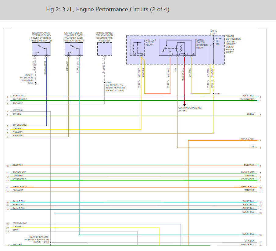

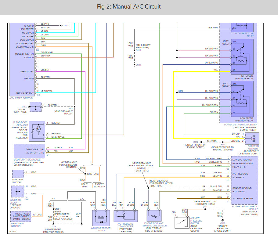

i have posted below the entire cooling fan wiring circuit to help you.. since the relay , fuse, wiring and fan have been ruled out..all that leaves is the computer (PCM), but you can take a look at the circuit for yourself below..
https://images.2carpros.com/forum/automotive_pictures/261618_Noname_2369.jpg
WAHOOS
  • 5 POSTS

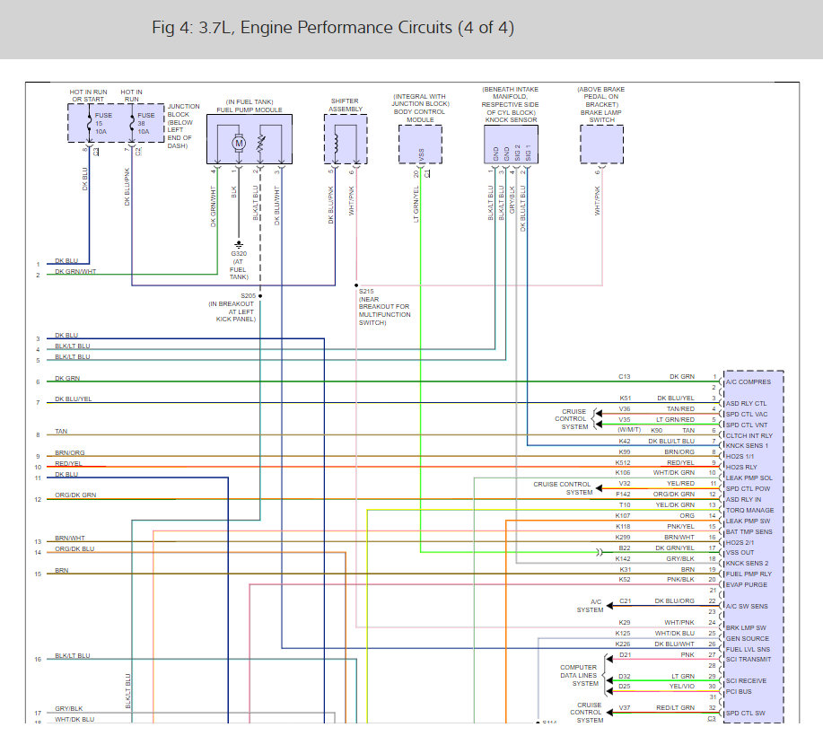

Thanks for the diagram, it helped me troubleshoot a little more. I was hopeful for a bad splice on the harness but I put a jumper between the power pins and the fan worked. I got continuity from ground pin and frame so that was good. ReSpliced pcm wire to make sure... but still doesn't work. I don't know how to further check pcm so I guess I'm stuck replacing the unit.
WAHOOS
  • 5 POSTS

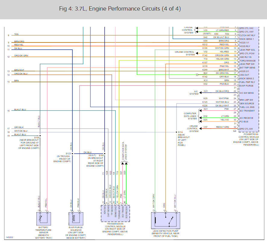

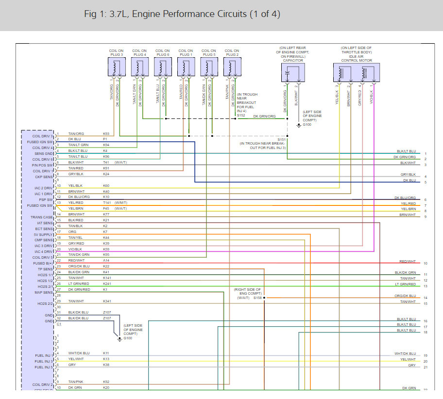

Is there anyway to find a pcm pin out diagram for 02 liberty limited? I pulled the pcm connector out and checked for continuity between connectors and got nothing. I would like to know which pin it is so I can run new wire from pcm pin to wiring harness.
BLUELIGHTNIN6
  • 16,542 POSTS

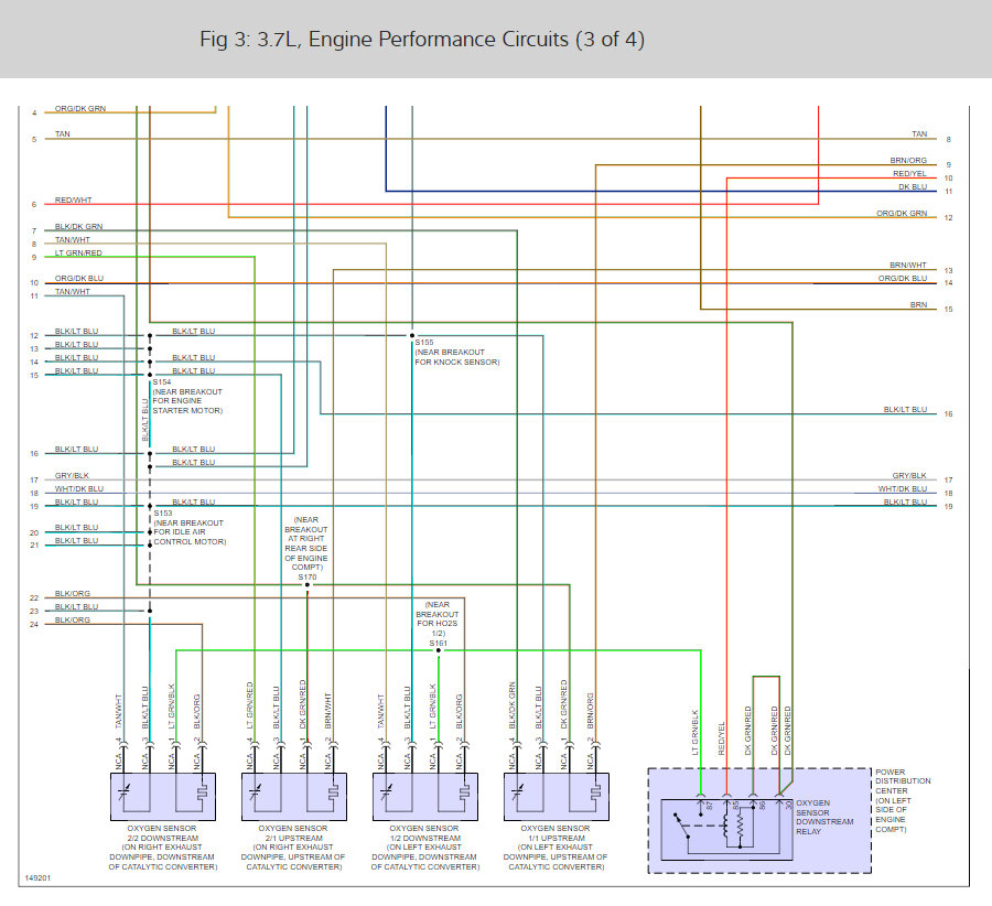

Yep I have a guide that will help you.
Here are the engine wiring diagrams for the PCM (below)
Cheers

I found A light green wire in the pcm wiring connector but it must be a different wire. i cut into the split tubing to trace it but it does not tie into the the fan relay.

So I'm still trouble shooting this fan in hopes of not replacing the pcm and to make sure that is indeed the problem before I purchase a new one.
So here is where I stand now... I pulled the conn from the coolant temp sensor (cuz something has to tell the pcm when to start the fan.. right?) And I jumped those two wires... fan comes on soon as start the jeep. Gauge doesn't read but fan now works. Well I replace that sensor but that damn thing still doesn't come on! How could that be???

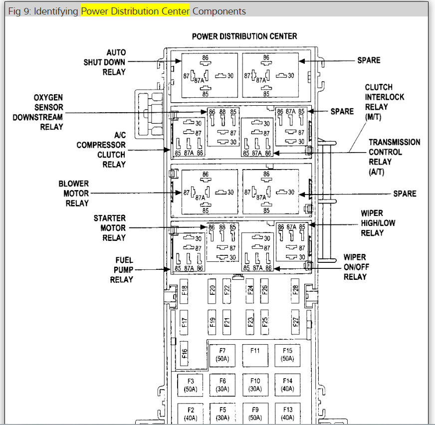

SIMPUB
I have a very similar issue. I have replaced the entire A/C system, but it won't power. If you apply direct current to it, the compressor comes on and cools. At the same time, my engine/radiator fan will not come on, even when extremely hot, so the coolant boils over, mostly when idling. However, the fan will come on when I apply direct voltage to it.
I don't see any fuses out. I tried swapping relays to test. Also, I temporarily swapped in another dashboard control unit from another Jeep to see if that was the issue.
So far nothing works. Still driving without A/C and avoiding overheating by keeping the Jeep moving.
Does the combination of these two issues point to anything specific? It would be awesome to have A/C finally!
Thanks!
Mark
Jul 25, 2022 at 10:15 PM
  • 55,433 POSTS

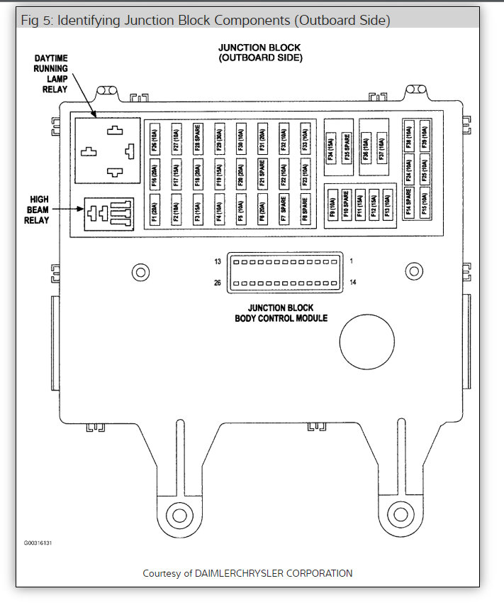

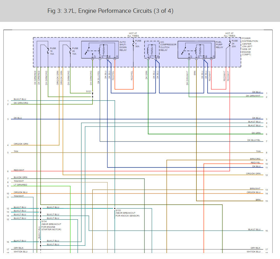

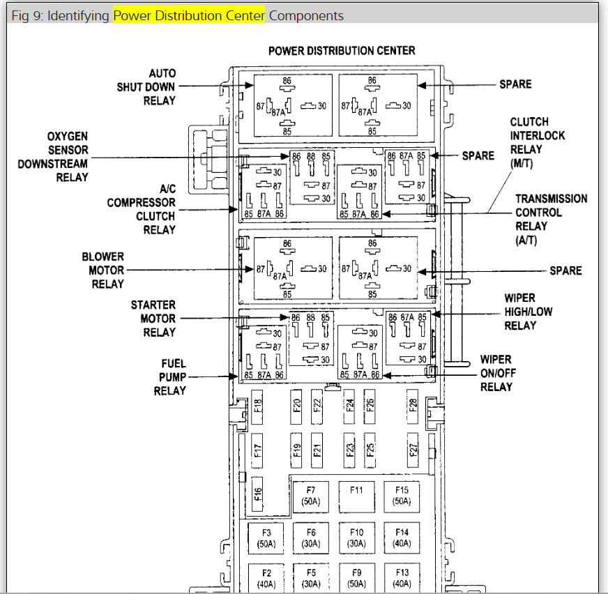

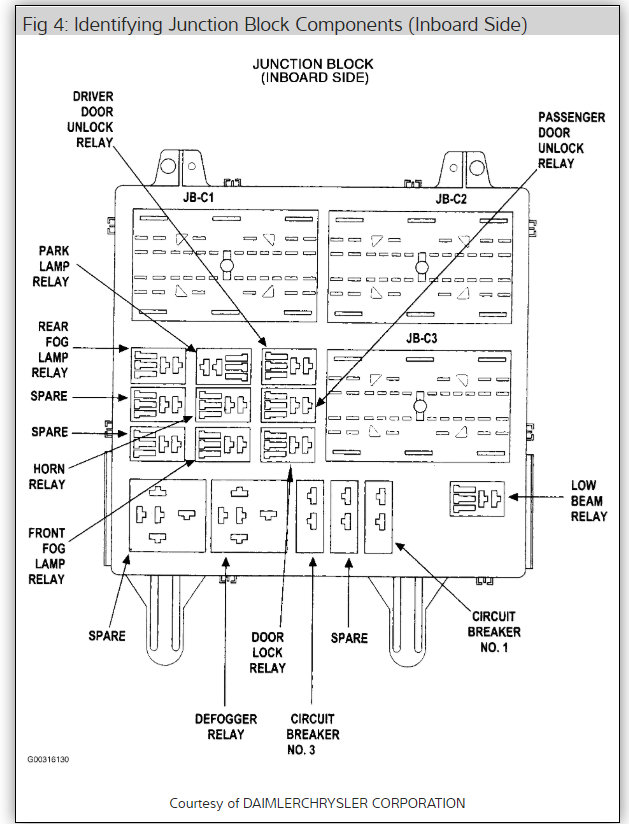

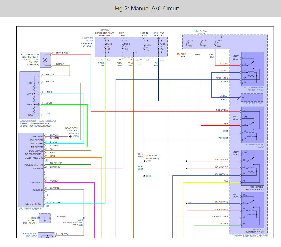

Yep, A/C is nice in the heat. Let's check for power at system systems seven fuses.
Here is a wiring diagram to show you which ones and a guide to show you how to check for power:
Check out the diagrams (below). Please let us know what you find.
