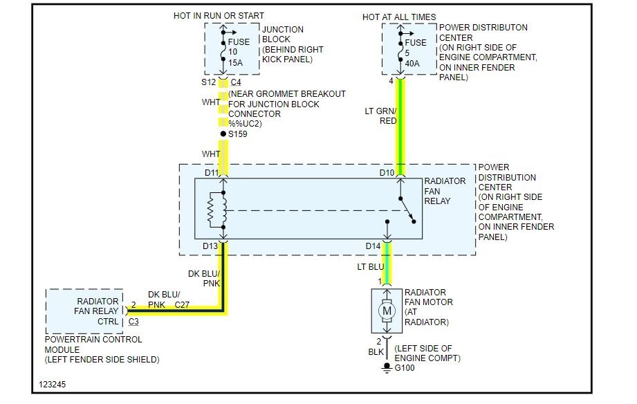

I have a new fan, a new relay in fuse box next to A/C and a new temperature sensor in front of valve cover. (inline 6) fan will not come on with A/C and when temperature is 210 on the dash gauge. is their another relay or sensor? if so where, someone said under the headlight on passenger's side. if so how do i access the item? What does it look like?

Did you test for power to the fan motors with a voltmeter or test light to be sure the fan is not the issue?
I attached a wiring diagram for you to view. Check both fuses listed for power on both sides to be sure the fuse block is good.
